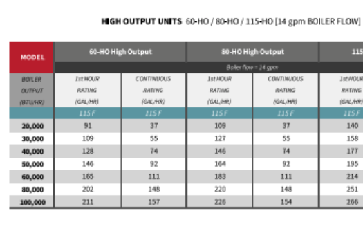

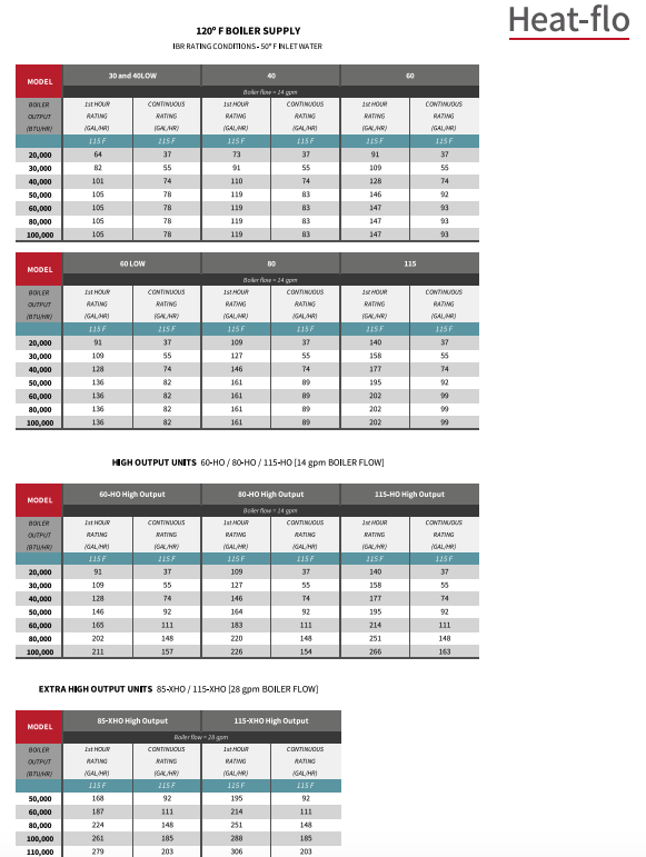

    Hi, for the Heat-Flo product, which one should I be looking for: Indirect water heater, high output indirect or hot water booster/storage tank?
    hot_rod Posts: 28,699
    Here are their high output models and specs.
    The show perfomance from 200 boiler supply all the way down to 120 supply.
    It really comes down to what you want or need, there is no one size fits all.
    If the previous tank was adequate with a GV-5 boiler, use that recovery number to size a new one.
    Personally a Lochinvar Knight 105,000 with one of the high performance Heat Flo tanks would be my choice. a similar size to the boiler you have and plenty of btu for a big DHW supply.
    A 60 gallon high output with 80,000 boiler input give you plenty of Dhw. Pipe it with a dedicated 14 gpm pump for full performance

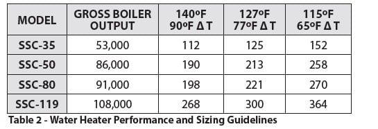

    My current Indirect Water Tank SSC-50 is listed as follows:

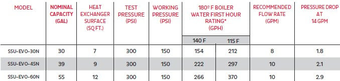

    The new one I just placed an order for is this:
    I never had a problem with hot water in my house, so I matched to what I currently have and placed an order for the 45N which is a 39 Gal tank. Just double checking if this is correct or should I go with the next bigger tank…the 55 Gal. I didnt see the reason to do so since its $750 more.
    Thanks
    I think you will be fine.
    Another option if you do run short is to run the tank at 140- 150 and use a mix valve to 120. That adds some drawdown capacity.
