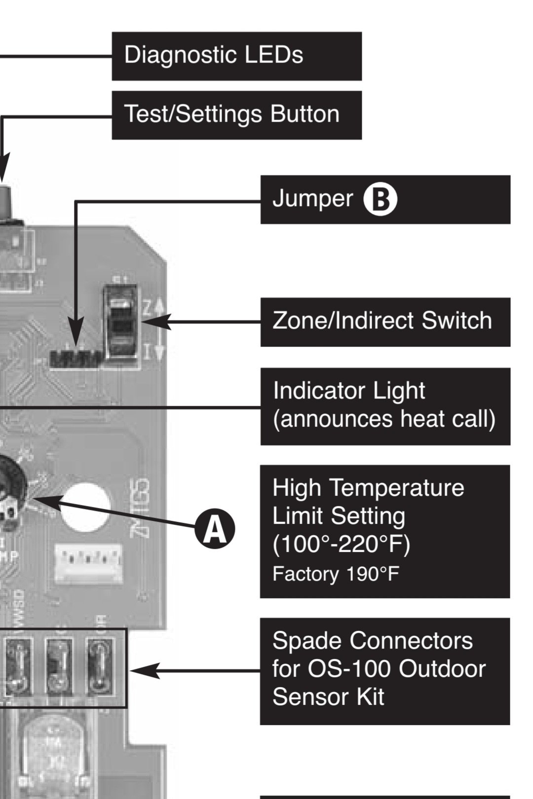

    Set the Z/I switch to Z. Right next to that switch is jumper B.
    Make sure the jumper is removed, otherwise the low limit won't go over 140°.

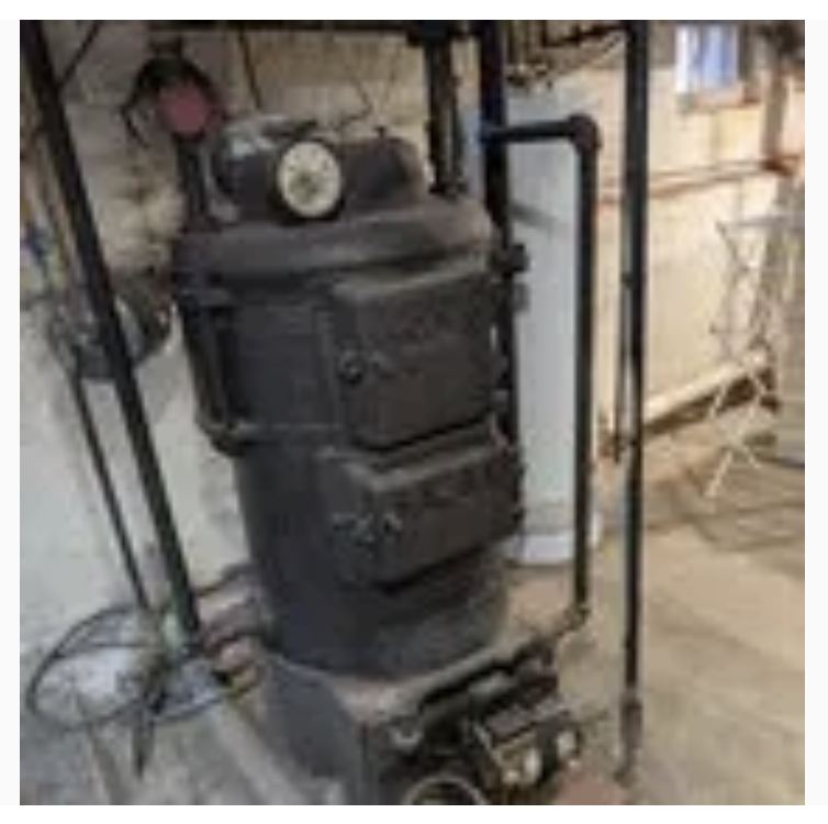

    Perhaps the owner of this boiler that was installed in the 1920s and converted to a cold
    start boiler when the oil burner was added in the 1950s or 1960s should be warned about your concern. Their boiler may not last very long after it was converted to a cold start over 50 years ago. It may only last another 20 years instead of the 100 years that it would if it was to maintain a constant temperature.
    How much fuel will that cost to leave it on 140° for the last 50 summers and the next 20 summers.  I’m sure that it is worth the cost of energy that is being used to make sure it will last longer… But wait is already lasted over 70 years with over 50 of those years as a cold start

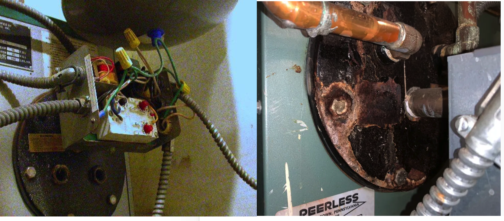

    If you sense a little sarcasm in my comment, it is because your concern has no foundation in fact.  A leaking coil gasket has nothing to do with the boiler being a cold start or maintaining temperature.  It has everything to do with the original installer and homeowner not reading the instruction manual after the day it was installed.  You should snug up the coil gasket bolts (or nuts) after 500 hours of operation and again after 1000 hours of operation   Once that is done the coil gasket will last for 30 years or more.  The temperature will have no bearing on it leaking or not leaking.  The loose fasteners will have everything to do with it.
    On a boiler that maintains temperature the leaking gasket and flange will not look wet because the water will evaporate faster at the higher temperature.  The gaskets and flange will look wet at room temperature.  Either way, the leak is still there.
    Here are two tankless coils on two different boilers that are both over 20 years old.  Can you tell which one was snuggled up a few months after it was installed over 20 years ago and which one was not?  I bet the one on the right is leaking as we speak but the higher boiler temperature is evaporating the water away and leaving that telltale corrosion behind
