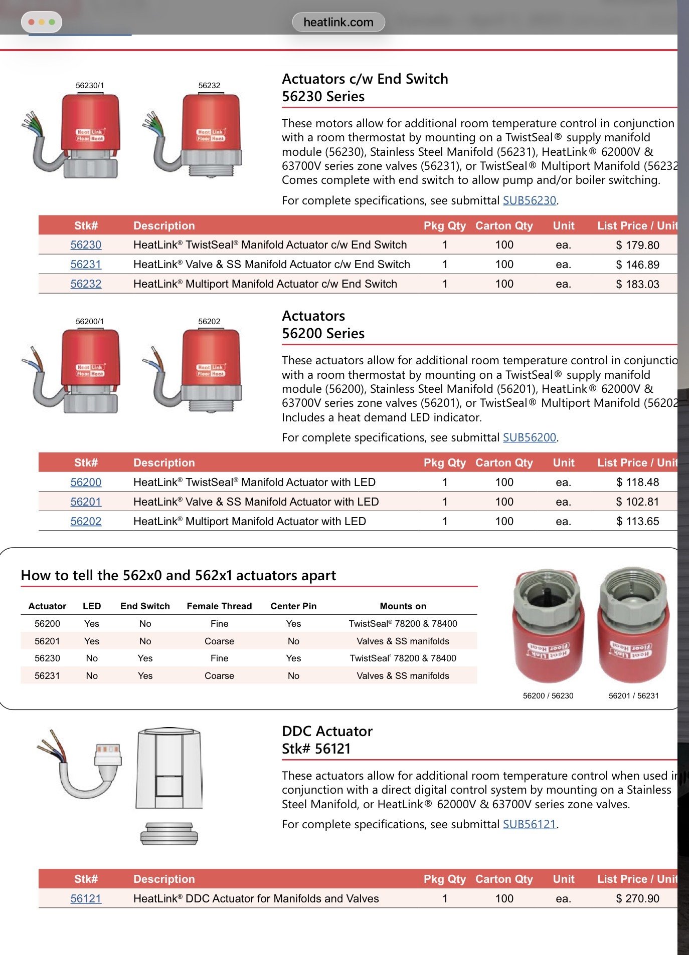

Can anyone identify this manifold system- need a part
Hello
I believe this is an 80's-90's Heatlink plastic manifold. Can not find any pictures online. I need the connector nut from the manifold to the controller. Thank You
the nut is typically on the actuator.
Those early versions had an adapter to snap on the actuator. Those are discontinued
They do show two versions of actuators depending on fine or coarse thread on the manifold. The TwistSeal is the composite manifold
Unless a piece broke off the manifold?, the threaded attachment?

Image 4553 is the double threaded nut that screws into the manifold and the actuator. I've been told by a Heatlink rep that neither their 410mm or 55mm will fit which makes sense because this not mic's out much smaller that that. Some of this newer ones look like some kind of a snap on connection rather than threaded
I would guess Heatlink would have a solution for you?
