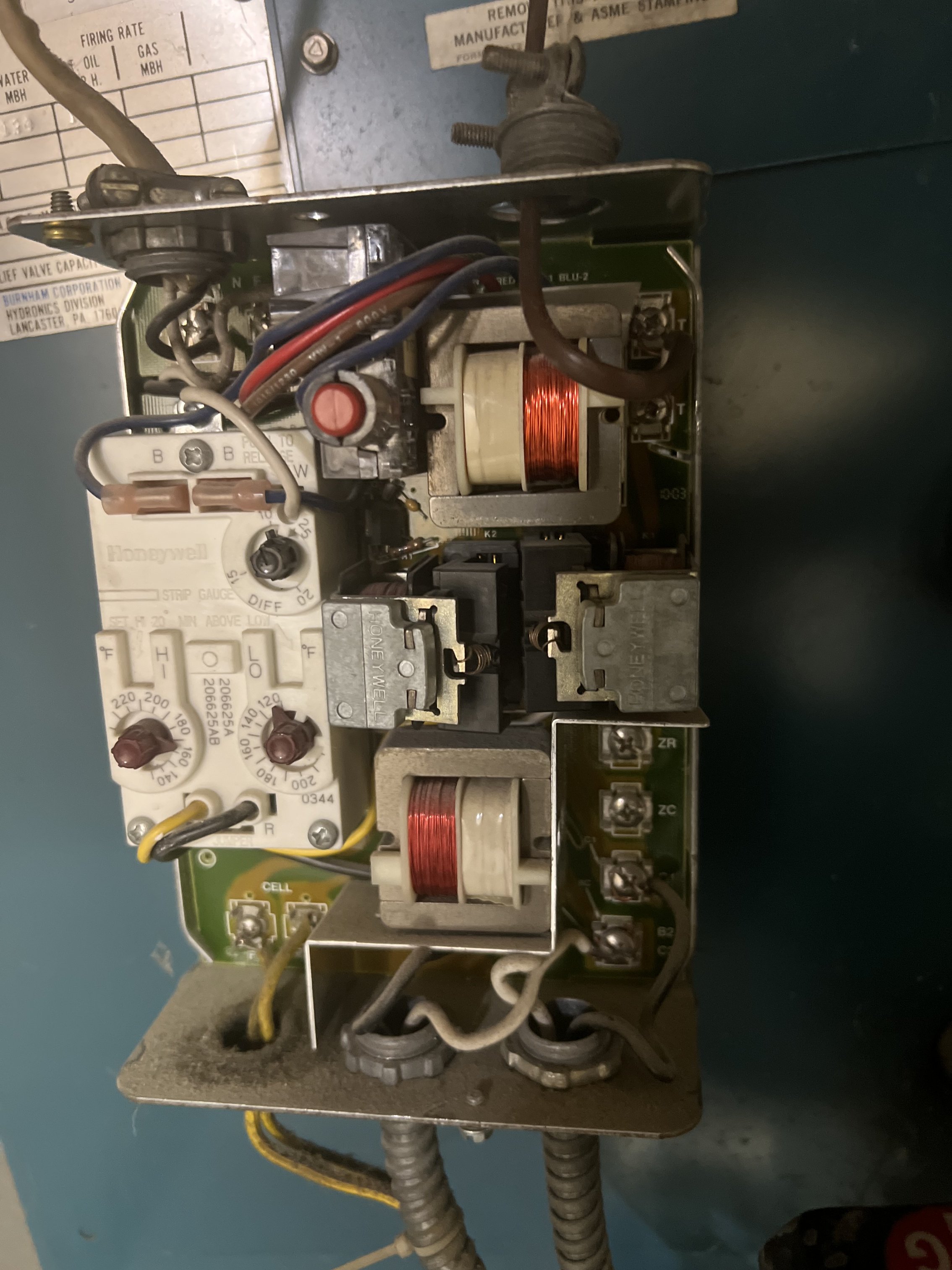

hello heat heads,
I have a Honeywell Aquastat R8182D which doesn’t seem to want to take any advice from my thermostat. I’ve replaced the thermostat twice, and have ruled that out as being any problem. Right now I have the 2 thermostat wires disconnected, and the unit is turning itself on and off to keep the house at 70°.
My HVAC buddy has helped me over the phone, we’ve adjusted high, low and diff. settings with no resolution to this problem
Mechanically my system works fine, as long as you like it constantly at 70.
Can anybody suggest a solution to this issue so that I can actually adjust my temperature in the house with my thermostat?

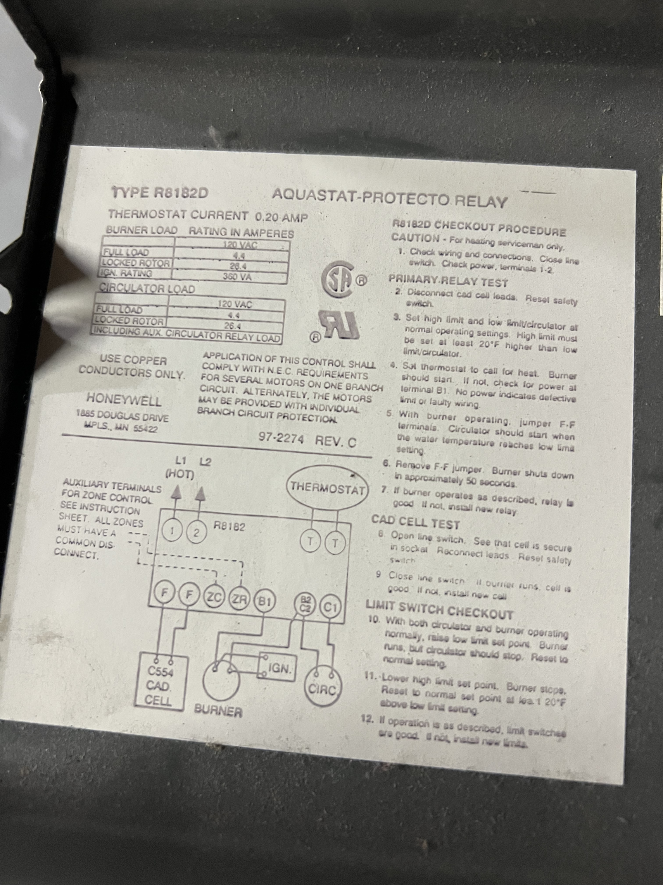

If I need a new aquastat, I don’t see my R8182D still available through Granger’s or elsewhere.
Thanks everybody

    is there a domestic coil on this boiler?
    Is your circulator turning on when it’s calling for heat?
    What do you mean it works fine if you like it at 70?
  • There is no domestic coil.
    the boiler seems to have self-selected 70° as the temperature it runs at without a thermostat(or, with the thermostat connected, for that matter)
    The circulator pump immediately when the system fires up and turns off immediately when it . My other house lets the pump continue for a few minutes afterwards… This unit does not.

    Time to step up to some modern controls. You'll need a new aquastat (simple hi limit, or modern aquastat), and you'll need a new primary control for your cad cell wires to land (f-f terminals).

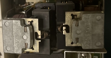

    If you jumper the T-T together does the boiler and the circulator work as normal, regardless of ambient temperature ?
    If not I would suspect the solder joints where these relays connect to the circuit board are failing.

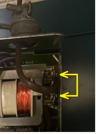

    There's no way the aquastat knows to keep the space at 70°. There's 2 things that can cause this. An intermittent short. Or the thermostat. They're the only thing that will automatically close TT on the aquastat to start the heat demand; circulator, and burner if water temperature is below the Hi setting.
    Do you have a meter to check for a short?

    If you have 120 volts to your control and you jump T & T thermostat connections. the relay has to pull in (unless the high limit is open)
