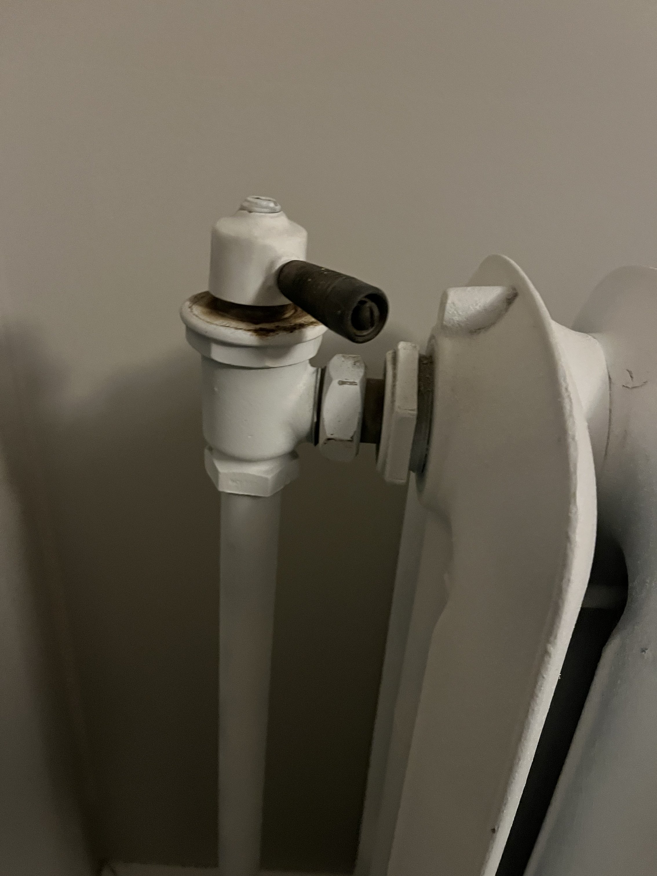

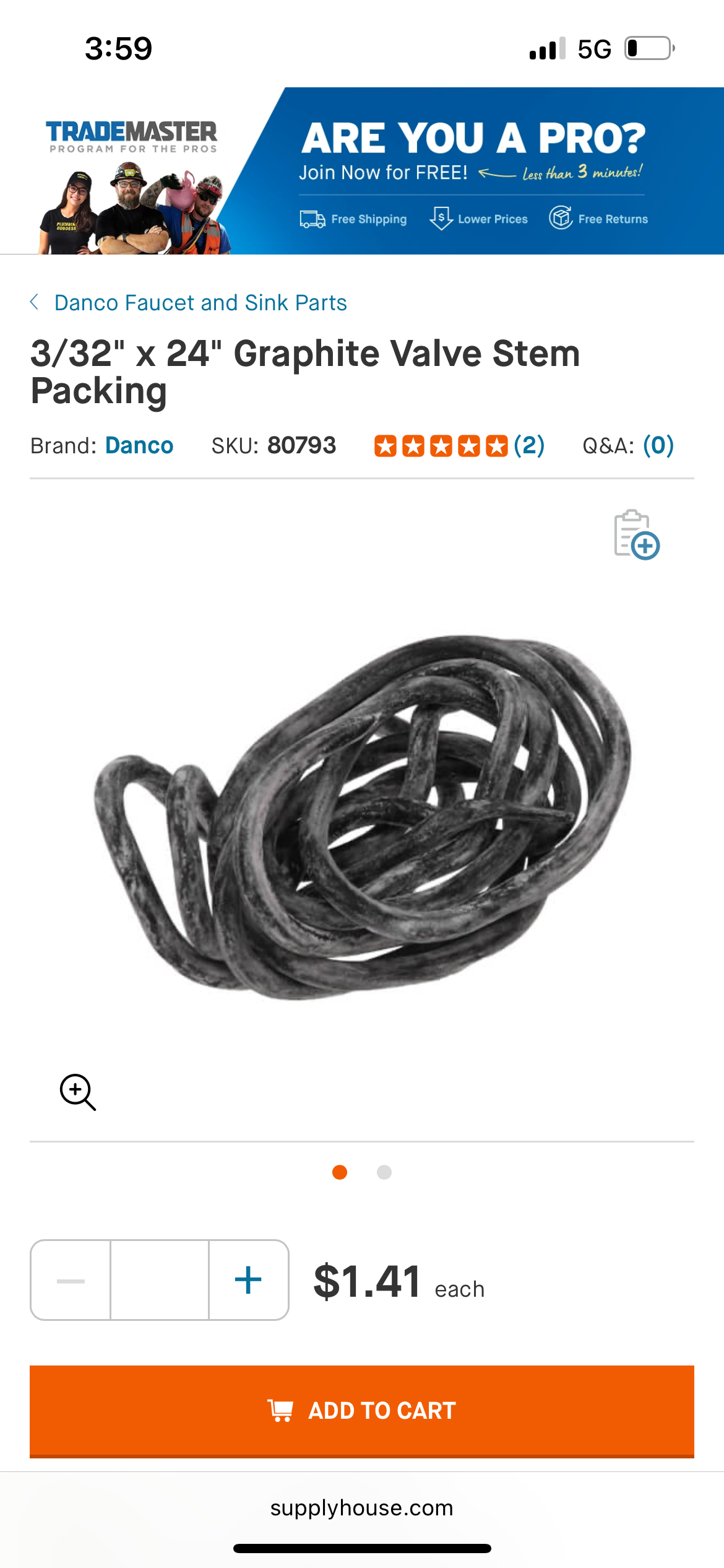

Hi everyone — I have a Trane vapor system and I’ve been using graphite valve‑stem packing in the shutoff valves. The problem is that it starts leaking again after about a year, and I end up having to repack it. Is there a more reliable packing material or a better long‑term solution for this type of valve? Thanks in advance.

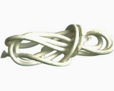

Maybe try this teflon type packing?
yes, I remove all the old with a pick.

teflon is more durable than impregnated string. the shaft needs to be smooth and ideally free of pits and ridges where the packing rides on it.

Try Ace Hardware's #40209 twisted graphite packing. It's quite different from the type you show.
I use and recommend this type for the float switch pivot shaft stuffing box on old condensate pump tanks.
