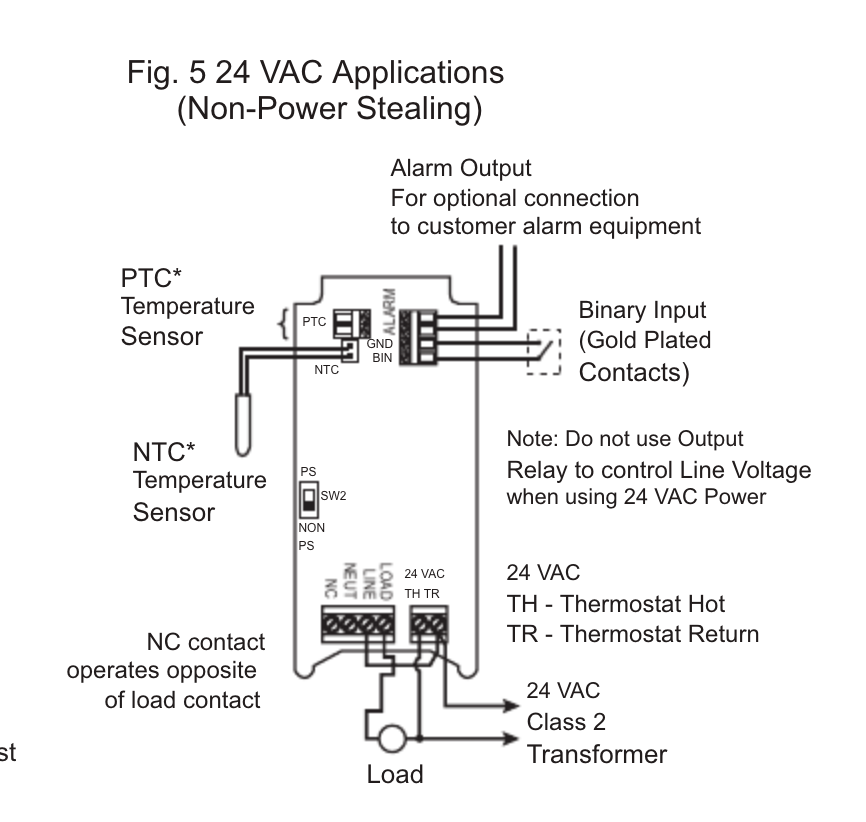

How do I wire the White Rogers 16E09-101 to the boiler TT wires?
I have the previous old aquastat wired inline with the Boiler TT wires (managed by a Taco SR503-EXP-4 panel), so it only fires when the Taco is asking for heat AND the boiler temp is low. (If the boiler temp is OK, the Taco just runs the pump, no call for boiler fire).
Do I wire the boiler TT as the Load? And use a separate 24V transformer for power (or run additional wires from the boiler 24V transformer)?

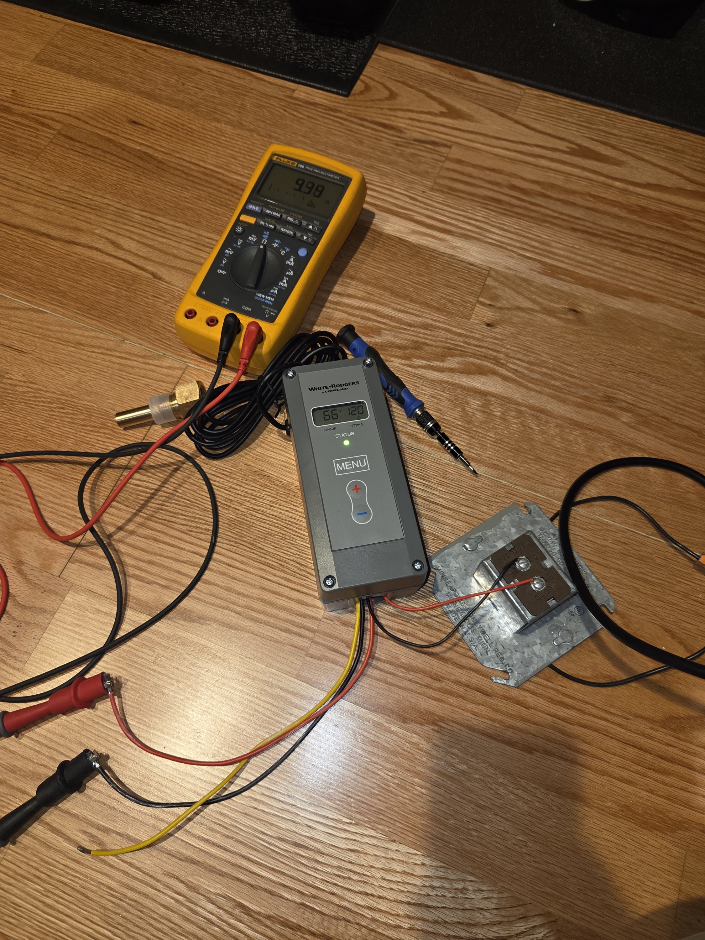

    Nevermind. Wired it up with a 24V transformer to TH and TR terminals.
    The Line and Load can then be used as dry contacts for the boiler trigger.
    Super easy.

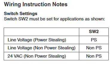

    9.98 Ohms is not a reading I would expect from good contacts, ever. Less than an Ohm (Closed ) or infinite (Open). Seems there is a resistor in there for power stealing mode.

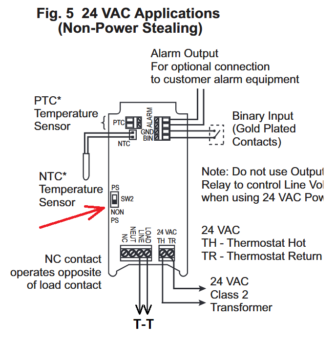

    Maybe try the 24 VAC (Non Power Stealing) Non PS Mode switch setting.
    I would try something like this.

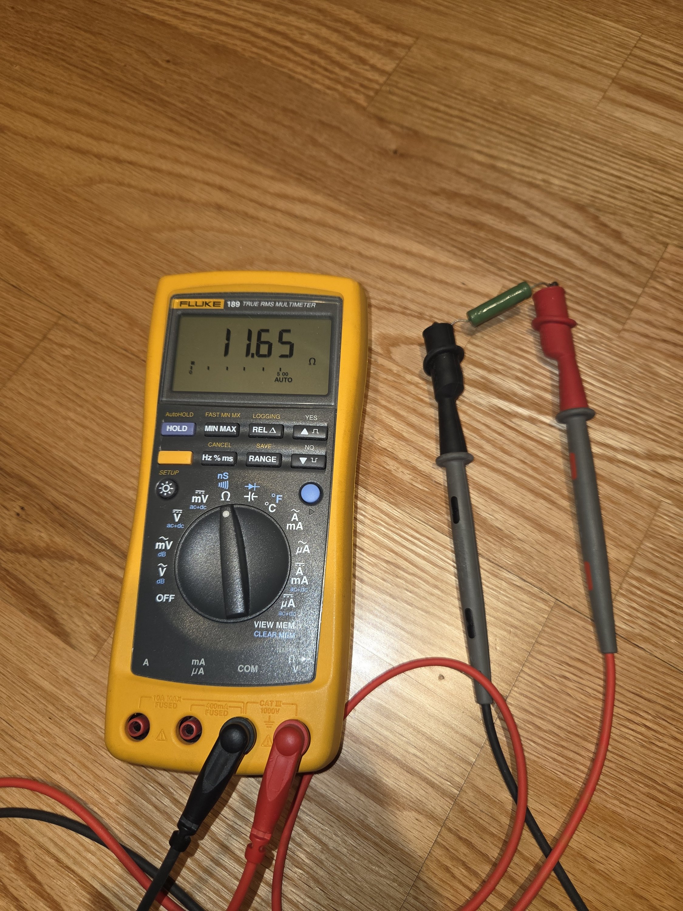

    Thats just my multimeter being flukey. pun intended. :)
    I have it set to non-Power stealing.

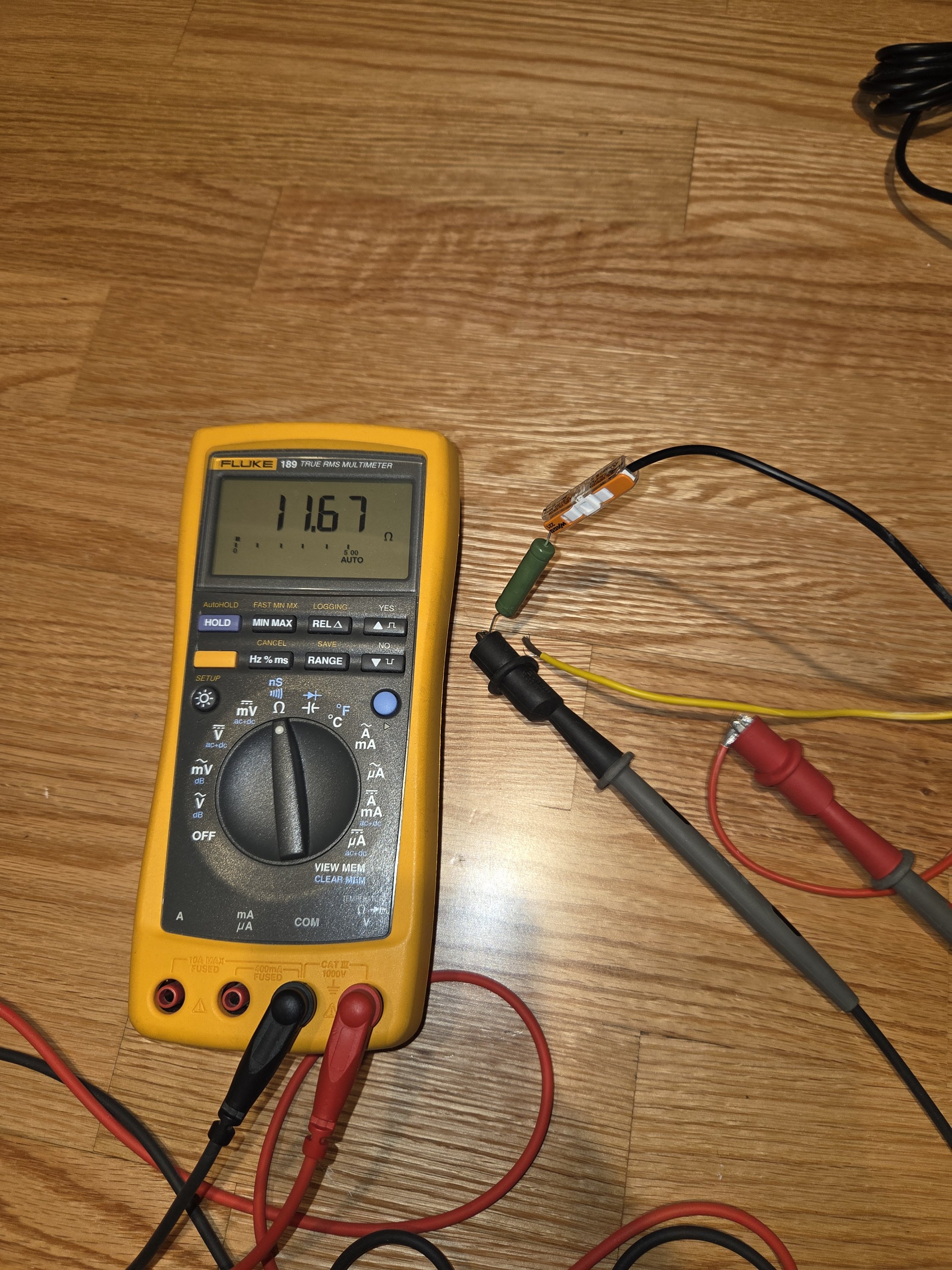

    with a 10W resistor in series.
    with just the 10W resistor

    Is that 10W resistor also about 1.69 Ohms ? I did not see the resistor in the other picture. Assuming the contacts being less than an Ohm and the meter read 9.98 Ohms. WoW if my Fluke did that it would drive me nuts, I'd be finding out why. Bad test leads, maybe ?

    It is a 10R resistor. Measuring a bit high at 11.65R.
    I have had this experience before with this multimeter. It doesnt read short/closed as 0R, but gives me a varing resistance somewhere in 1R to 10R range.
