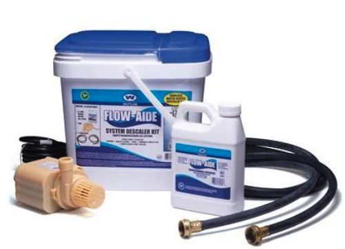

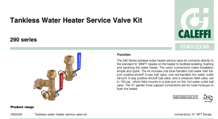

    It and the HX need to be descaled occasionally, depending on how hard your water is.
    Ab tankless water heat cleaner kit may clean both if you have or can valves to circulate the cleaner.
