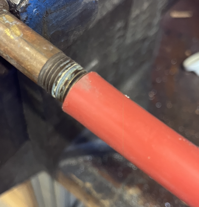

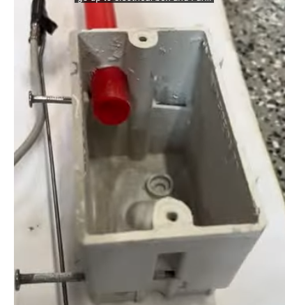

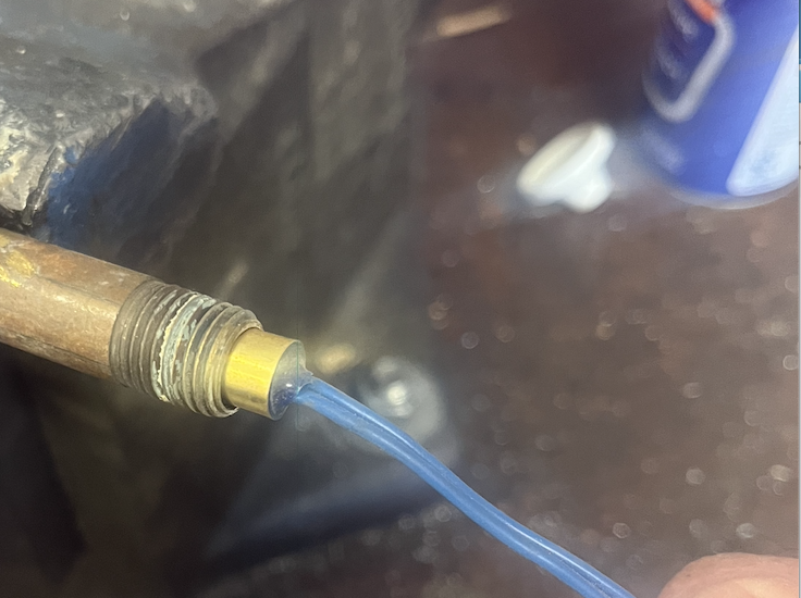

    The tekmar slab and universal sensors are all 3/8" OD.

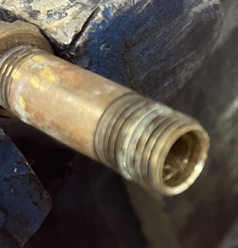

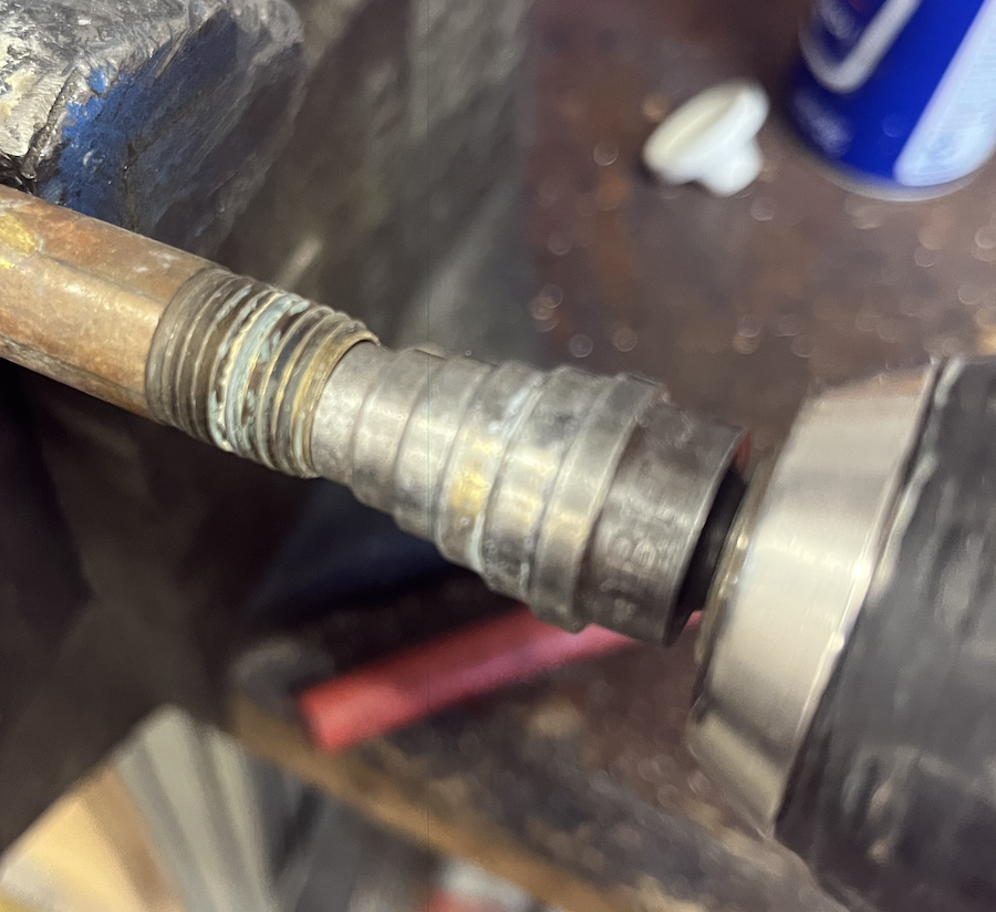

    Get a 1/4X 4" brass nipple and cap. Run a 3/8 drill inside it to clean out the burr.
    Next hit the end with a Unibit to put a taper in the brass, this allows the sensor to slip in easily.
    If you warm a piece of 1/2 pex it will screw over the 1/4" nipple thread to run up to the stat location. A piece of stiff wire or a fish tape, heat shrink it to the sensor wire behind the sensor, to push the sensor in.
    Some heat transfer grease assures a good contact. Auto parts, even Home Depot has these small transfer grease tubes.

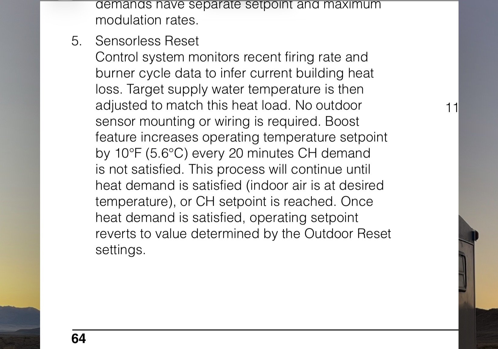

    just fyi a Burnham Alta doesn’t actually require an outdoor reset/sensor, it controls that on it own
    hot_rod Posts: 28,704

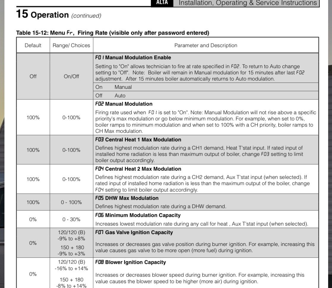

    do you have the boiler piped yet. That is a water tube type boiler and needs primary secondary or a hydraulic separator. Or the factory header.
    Interesting about the sensor less reset. Did it come with an outdoor sensor also?
    The F04 is a useful setting if you have an idea of the heatload. It basically limits the boilers firing rate, which can help eliminate short cycling

    A Burnham Alta doesn't come with an outdoor sensor. They do a pretty good job of figuring out the heating requirements without it. They have connections for the ODR thermistor and all the settings for that are in the controller if you want to spend the time doing all the figuring and then setting up the slope, water temperatures, etc. I think with the Alta, Burnham is going after a unit that is quick and easy to install with no ODR and the self-adjusting gas valve and IIRC just turning a screw and changing a control setting to convert to LPG. I have installed a couple of them and like them better than the previous K2 model if there is an indirect water heater involved. Personally I like my own K2 because I enjoyed tweaking all that ODR stuff to make it work the way I want it.

    Thanks for the reminder about a primary/secondary or a hydraulic separator. And pointing out setting F04
    I read about the sensorless reset, but I'm thinking having an outdoor sensor will help with:
    • Freeze Protection: Tells the Alta to circulate water based on external temp before pipes in slab have a chance to drop too low.
    • Warm Weather: So boiler doesn't fire during a warm spring day
