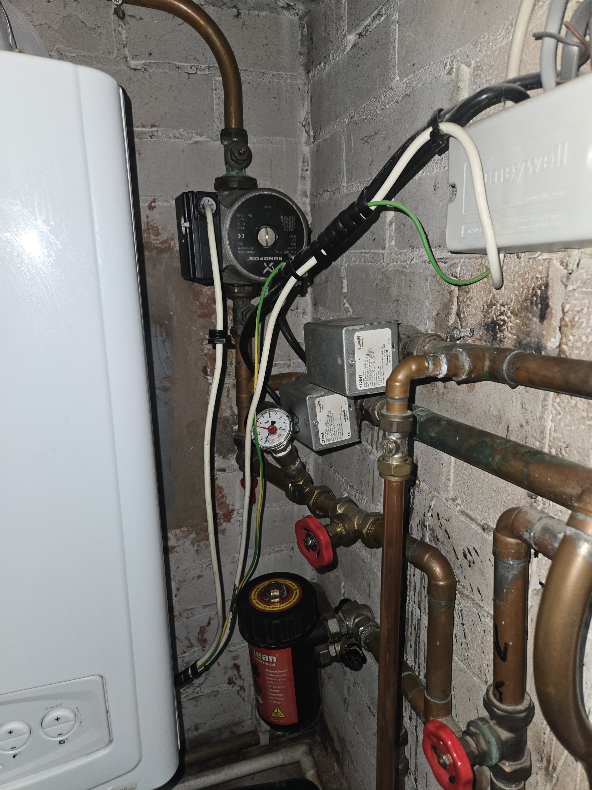

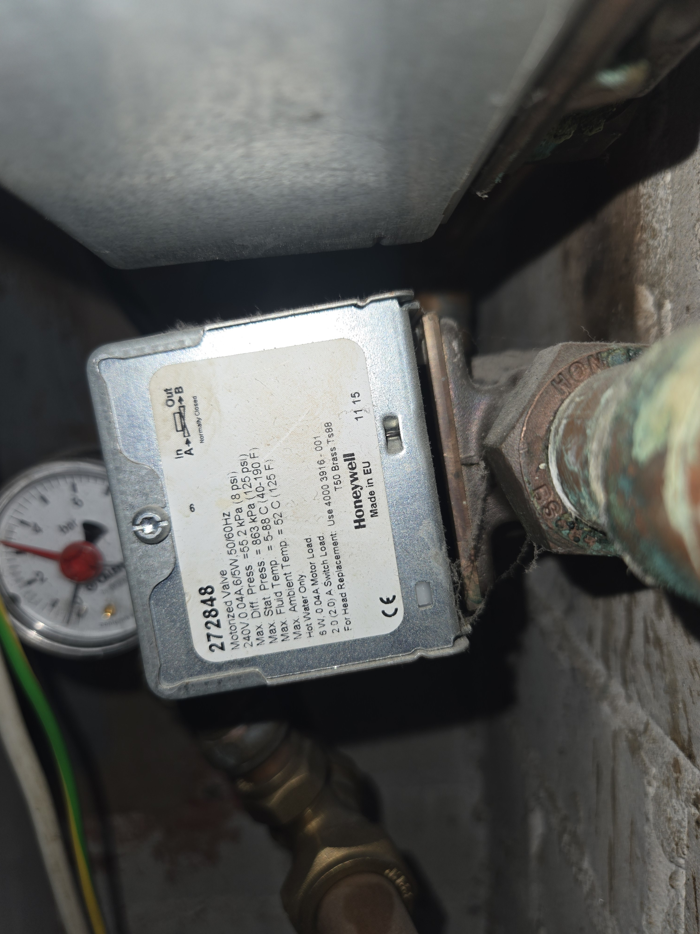

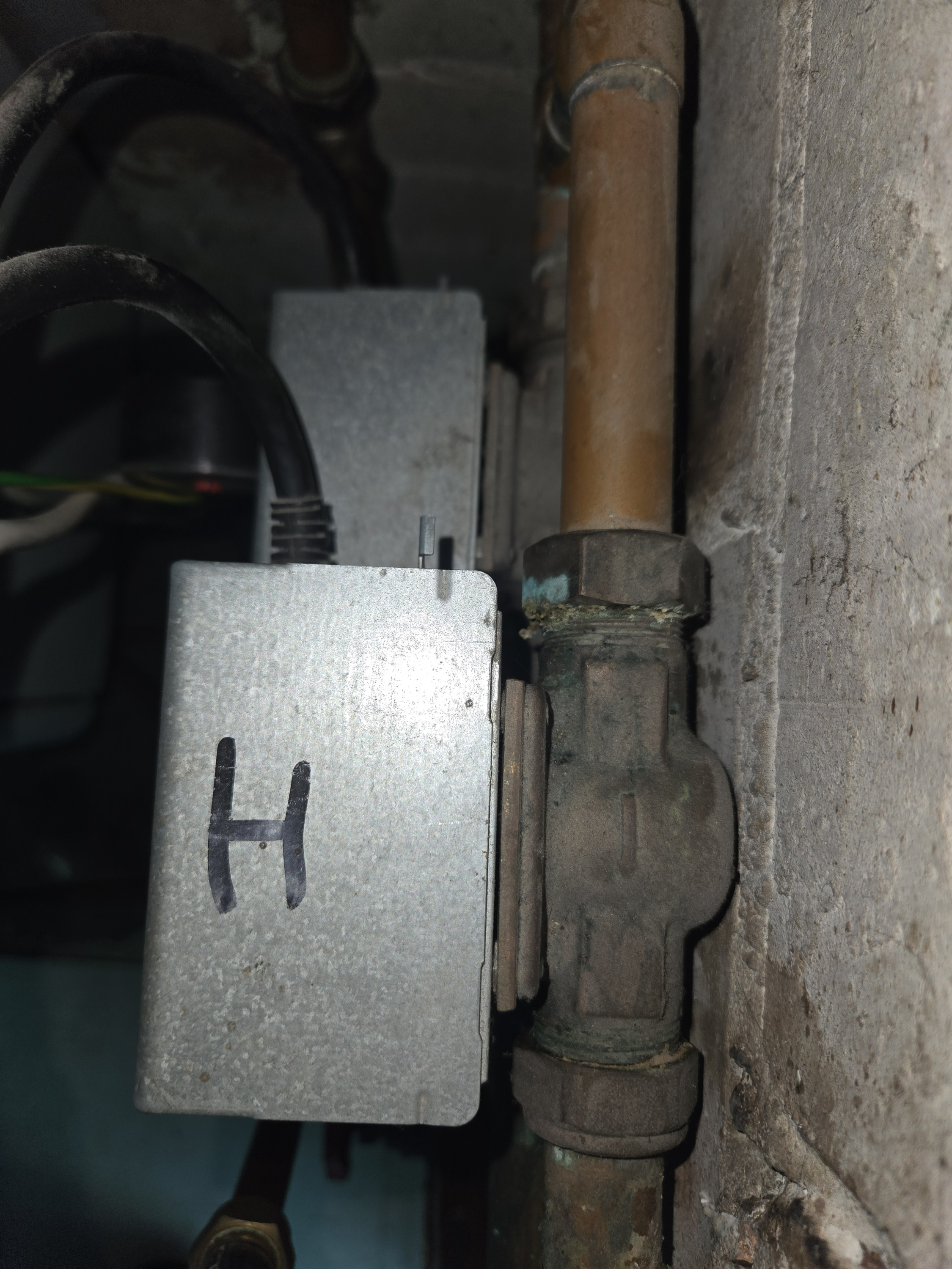

Hi, my motorized valves pass water when closed, and the outgoing pipe is hot
Is this normal for central heating motorized valves, or are they just old and worn
thanks
dave

    hot_rod Member Posts: 27,806
    A pic of the valve and boiler piping would help. Has it held tightly in the past? Any changes to the system, a pump switch perhaps?
    Many of the spring return valves like Honeywell, Erie, White Rogers, have a rubber ball or flapper as the shutoff. These can deteriorate over time and allow some leakage.
    Or the return spring could break.

    EdTheHeaterMan Member Posts: 12,492
    edited January 18
    That is an old design with inverted flare connections. I believe the repair part for that valve is still available. 40003918-006 repair part
    I find it interesting that you have 240 volt motors to operate those valves.

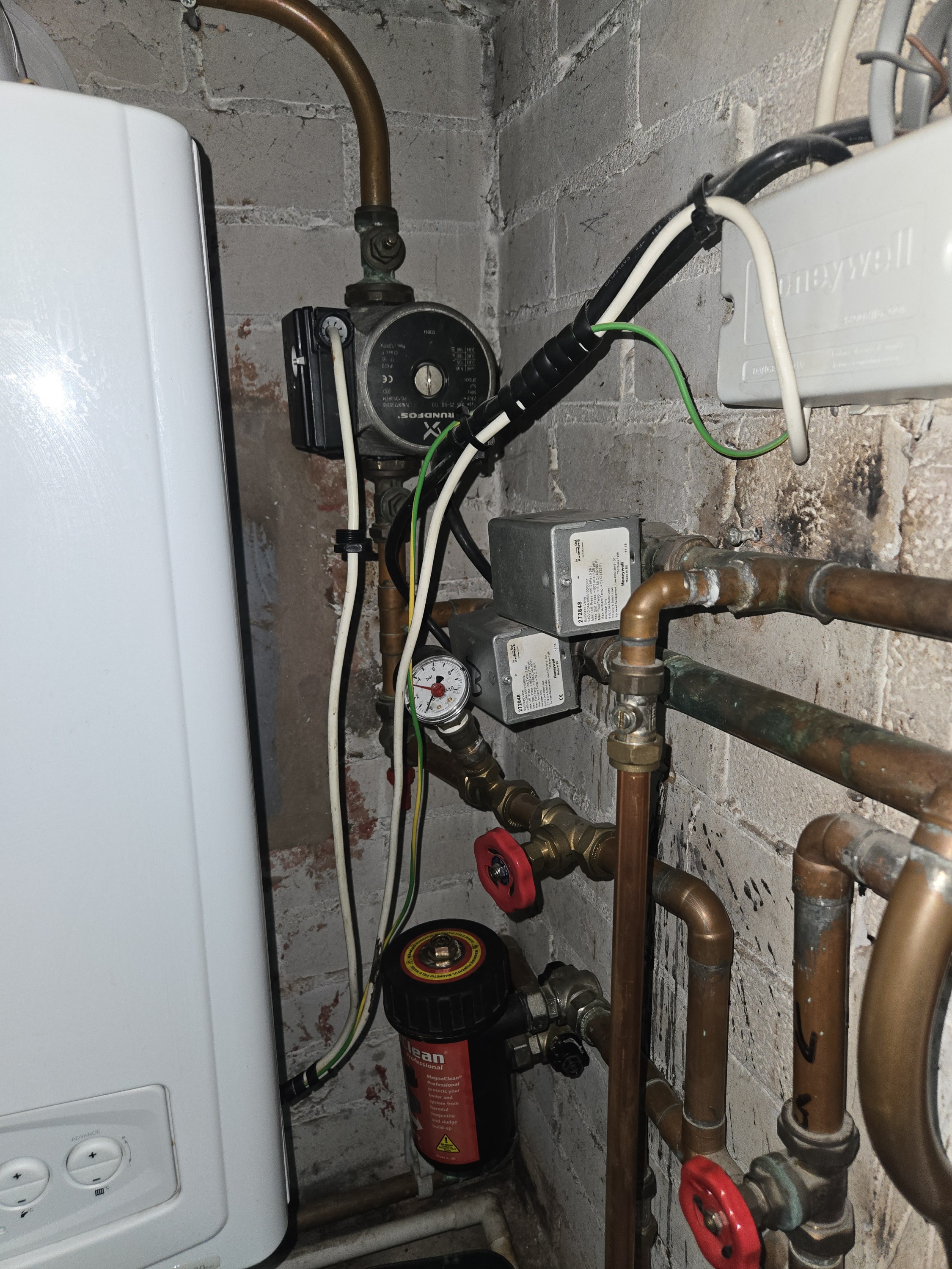

    where are you located? A 25-80 union body pump is not common in the US, and 240v is not common. It looks like Euro based components?
    25-80 the 80 is head in decimeter which converts to 26’ or about 11psi
    Those zone valved have an 8 psi shut off. It’s possible the circ is pushing them open a bit? Looks like a 2015 vintage valve.
    Take the cover off and see if someone disconnected one of the two springs, that reduces the shutoff even lower
    If it has always bypassed, perhaps there is a pressure bypass in the piping that is mis adjusted, or the rubber ball inside is damaged.
    a rebuild may or may not solve the problem. The least expensive first try is to pull the zone valve apart and inspect
    A few more piping pics would maybe show if you have a PAB bypass valve
    A delta P circulator would be a nice upgrade to avoid overpumping and save some electrical costs

    Hi yes i am in the UK 7 the bypass is shut
    And there should be two springs sure there is only one
    When you say they have an 8psi shut off does that mean they need more than 8 psi to get the ball to seat correctly
    Thanks
