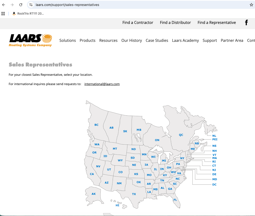

    Do I look to find the local distributor of the Laars and ask them who they would recommend? Or is there another method to find a knowledgeable service company?
    hot_rod Posts: 28,705
    If you are supporting and buying from a local supplier, start there.
    If not the area reps generally know who the best qualified installers and techs work for.
