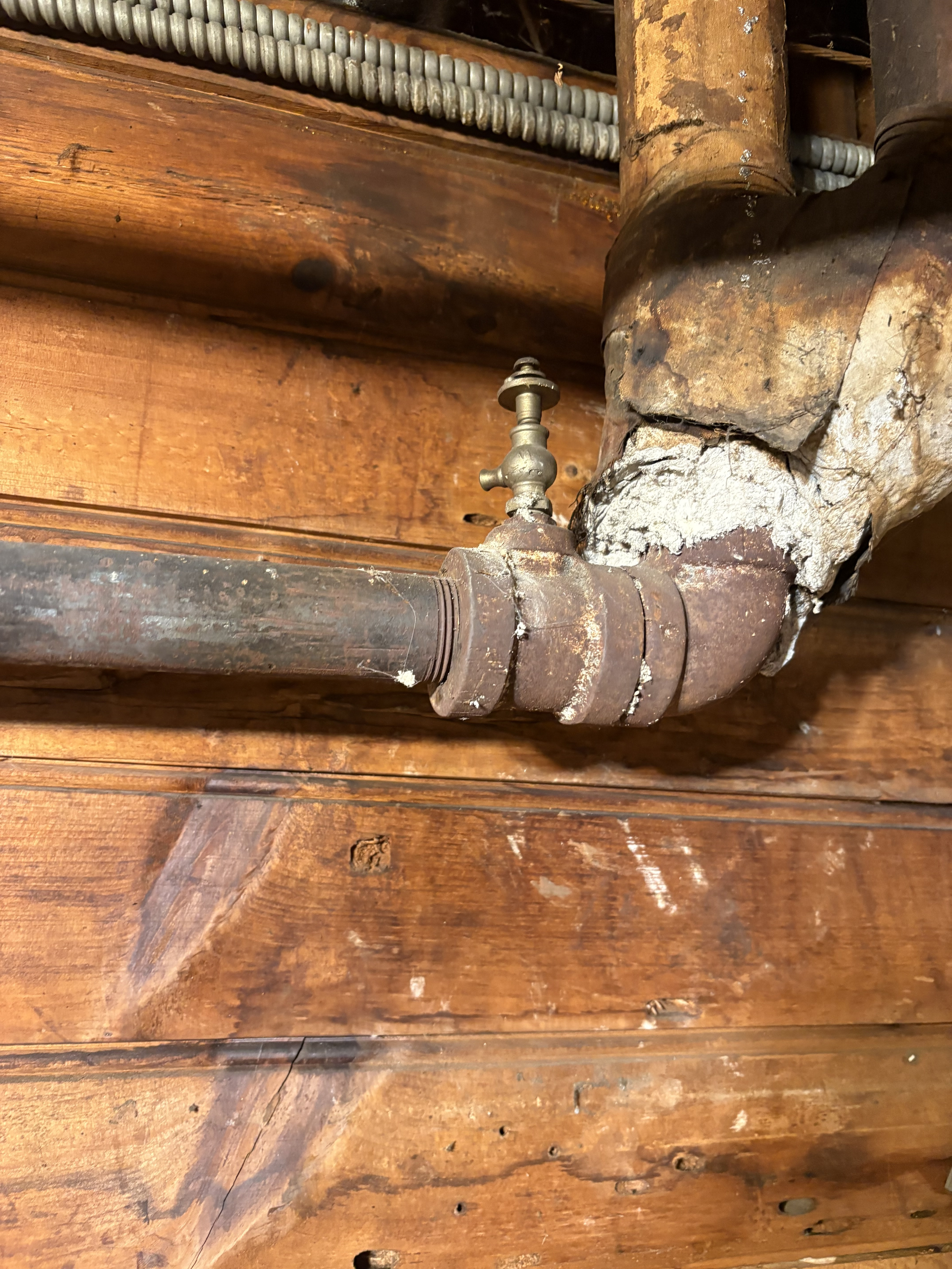

Strange device on one pipe steam system
Looks like an ancient Hot Water bleeder cock. Probably an attempt at venting. Mad Dog
2 -
looks like a try cock that the handle rotted off of.
@Mad Dog_2 and @STEAM DOCTOR are right. The earliest steam systems had manual vents because automatic vents as we know them today had not been invented yet. I still occasionally see these in the field.
How does that vent fit into the system?
1 -
this had been 10/10 helpful. its awards the end of the steam system would it be a a good idea to swap this out with a vent?
its on the bottom leg of the one pipe system about 200 ft away from the boiler right before the one pipe system drops down 6 feet then runs straight back to the boiler. the only other main vents in the system seem to be 3 vents side by side installed 5 story up. after those 3 vent the steam then drops down to heat all of the pipes on that side of the building (that side is typically the coldest)
Put a huge vent there and watch how much better it works.
