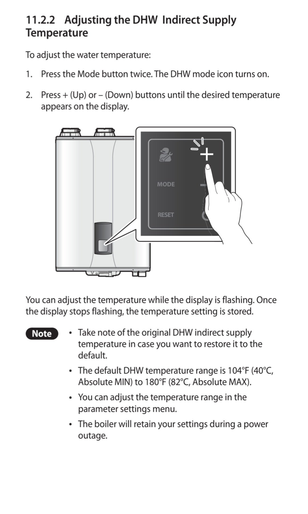

After replacing the PCB board in this navien NHB 150, I noticed that when making DHW it is down modulating to keep the supply water temp going to the indirect water heater at around 165. I feel like it should be supplying 180, to maximize the DHW water supply and recovering time. Are we missing something with the settings or jumpers? Thanks!
How do we know if you missed something if we don’t know what you didn't miss? I'll blindly throw a dart anyway.
Thanks, I figured it out, dip switch 8 on the PCB for exhaust temp limit was in the wrong position. This boiler has a polypropylene vent and it is safe to operate at 180, but the boiler was limiting the vent temp for PVC.
