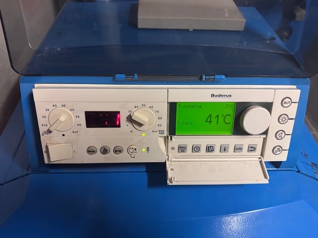

I have a Buderus GB125-22 oil‑fired condensing boiler.
Right now I’m using a Buderus RC35 thermostat located inside the house, which controls the boiler via an on/off contact (with the appropriate mounting base and contact jumper).
I have a doubt about how the boiler is operating.
I’ve disabled domestic hot water (DHW), so it is working only to heat the radiators in the house.
The boiler is in a separate room from the house, where it’s cold.
The boiler has an outdoor sensor to read the outdoor ambient temperature.
Now, with:
Thermostat OFF (boiler in standby/keep‑warm)
The boiler continuously heats the water from 40 °C (set using the manual dial on the boiler) up to 58 °C.
The water never drops below 40 °C.
Thermostat ON
The boiler does exactly the same thing, but with more frequent cycles.
I don’t understand whether, in temperature maintenance, the boiler should always bring the water temperature up to 58 °C without letting it drop, or if this is an error caused by the thermostat.

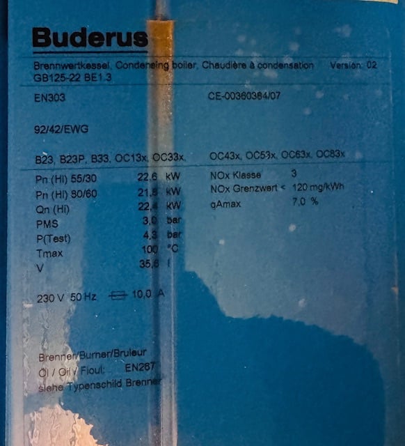

    No friend, it is
    Buderus GB125-22 BE 1-3 (boiler)
    RC35 (controller)
  • christianmlr
    christianmlr Member Posts: 5
    this is a picture of my boiler (when I received it)
    Attention:
    The RC35 controller is now installed inside the house and not on the boiler.
    HVACNUT Member Posts: 7,522
    I've never seen that control in the States. I thought the R35 was the thermostat. You missed a comma.
    Have you tried disconnecting the thermostat wires at the R35? That will at least confirm or eliminate the thermostat and wiring between the thermostat and the R35.
    No error code?
    Where are you located? There should be Bosch/Buderus customer service. They should be able to help if its programming rather than mechanical. Do you have an electrical meter capable of reading Ohms? If its not programming or an obvious short, they'll probably ask for resistance numbers on sensors.

    if there was a problem with the wiring or not turned on in the main control, you will get disco lights .. If you never seen lights …. it is disconnected at the main control and all adjustments need to be done at the boiler …

    Hello friends,
    no maybe you have misunderstood my info.
    I am in Italy and R35 is the thermostat (in the house); the picture (as I have written) is just to share the model and controller.
    The controller is running correctly and the boiler is working since 2010 but this is just my doubt because in the last time I am following the working flow of the boiler (temperature) and I have noticed this water behavior.
    No error, no mistakes and no fault.
    But I don't know if it is the best way for the boiler setting to decrease consumption and cost.
    Regarding this point:
    Thewater never drops below 40 °C.
    Thermostat ON
    What do you think?
    What are your settings?
    Thank you so much
