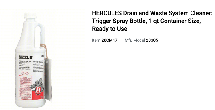

    This is an example of a products that works well in scaled copper boilers.

    Tech is here again. Believe he set the tank to support the higher operating pressure. He flushed out the heat exchanger numerous times and got some black flakes out of the system. Operating pressure is now consistently around 21 psi, but problem in the video persists. Latest thought is something still intermittently blocking the heat exchanger. Mentioned letting it sit w/ something like a CLR (product above) for several days in the hopes it breaks down whatever is blocking the heat exchanger.
    hot_rod Posts: 28,705
    I would go with a more aggressive cleaner than CLR.
    This is another product that you can find at hardware and box stores. It has directions on the bottle for descaling water heaters and heat exchangers. What is the boiler pressure without any pumps running, boiler at room temperature if possible?
    21psi is too high, unless the gauge is mounted at a pump discharge. Generally the gauge on the boiler itself is where you monitor fill pressure. Or the tech could put a temporary test gauge on the system.

    This product you could squirt in yourself. It screws on a hose connection on the boiler drain or purge valve. Pull the trigger and it squirts in.
    It is more of a detergent based product, I prefer acid for limescale problems.
