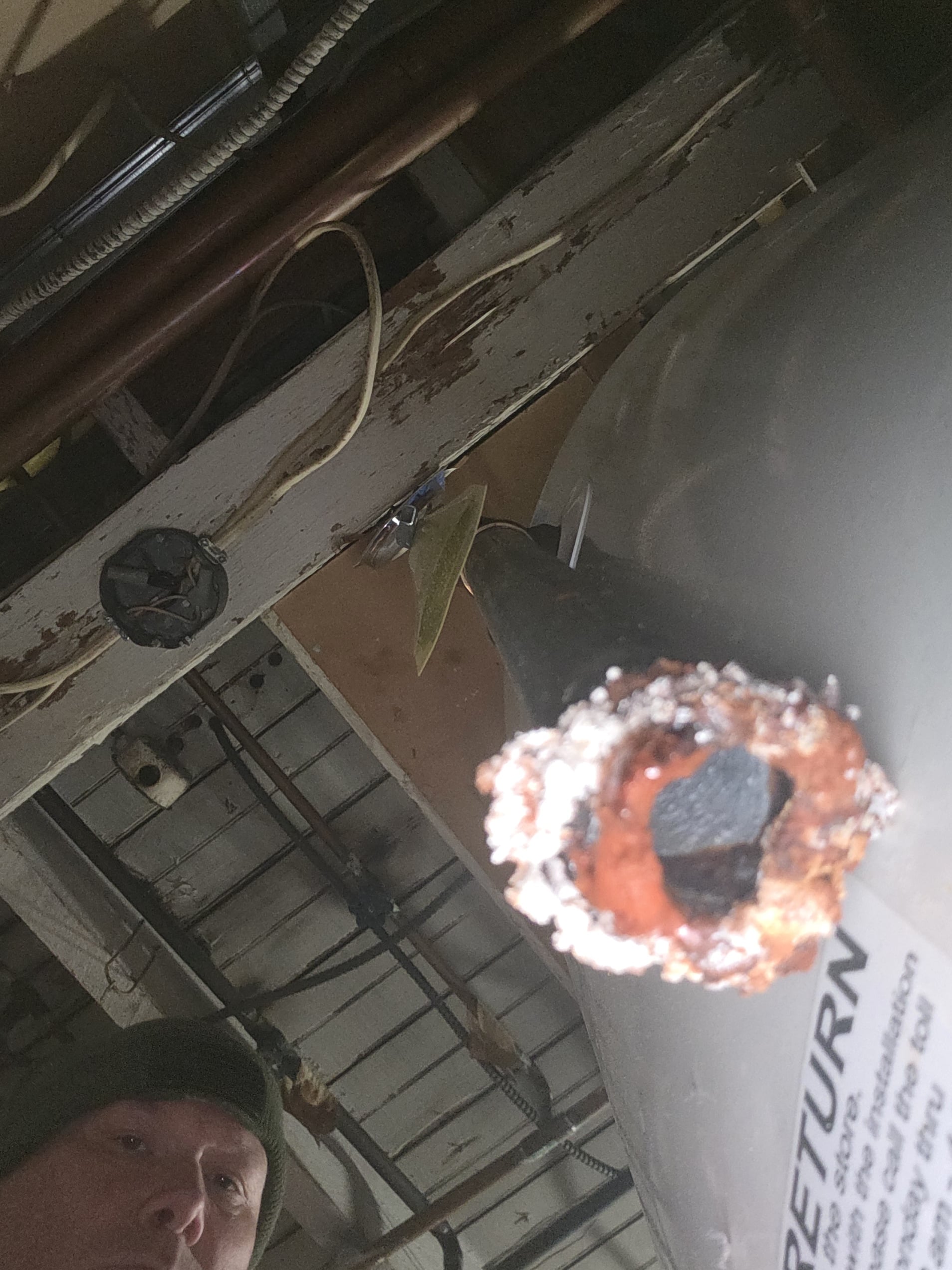

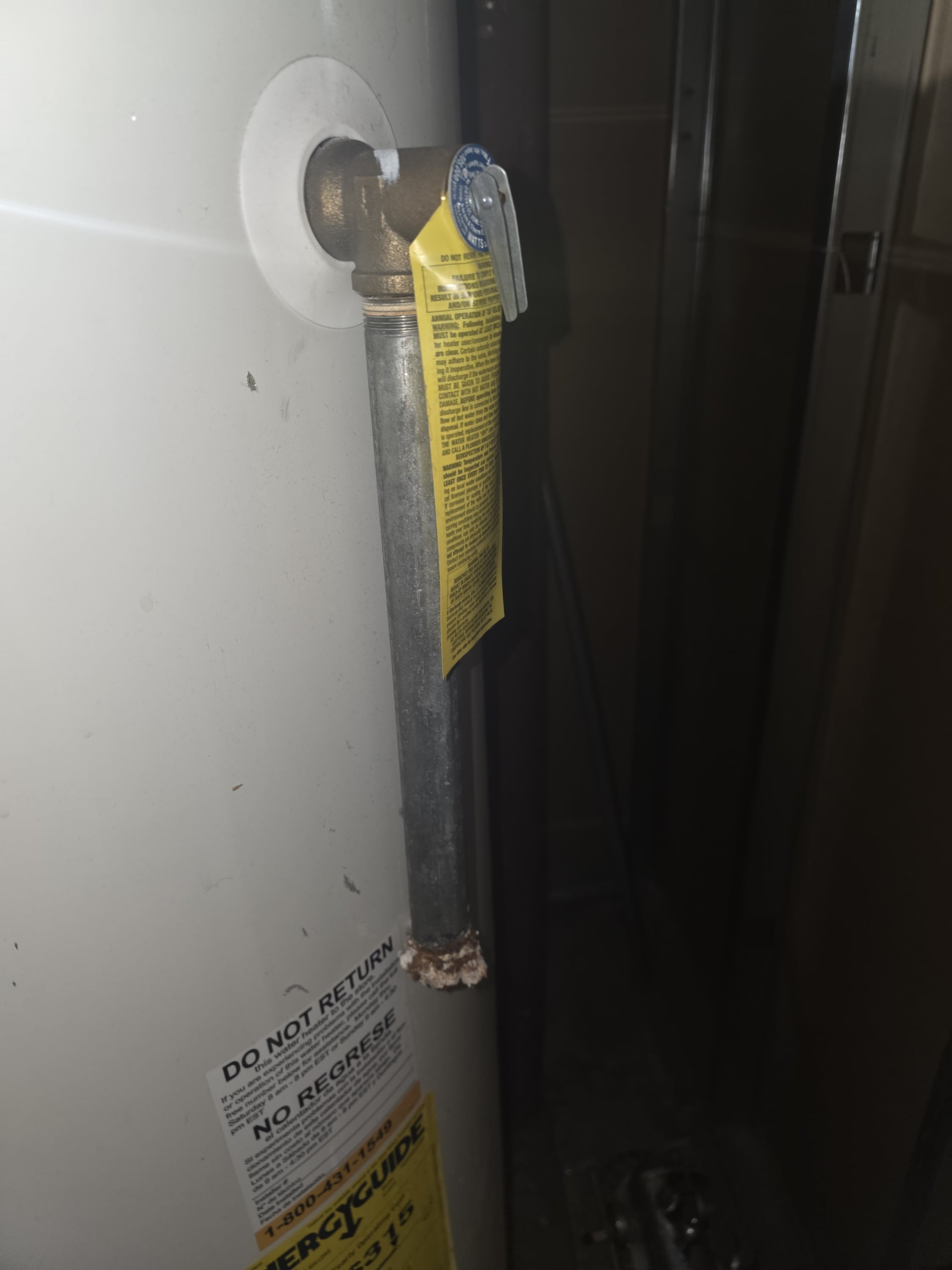

    I think the current plumbing codes allow relief lines to be any material suitable to the discharge temperature? So I see the plastic tubes being passed now, looks like the same material as the dip tubes.
    Old codes required metallic discharge tube as I recall.

    I dont use pvc for discharge, but better than this! Scary. Mad Dog
  • Hi, A benefit of copper is you don't get galvanic corrosion where copper meets the brass valve. A detail is the line is supposed to be run down to no more than six inches off the floor, so people are less likely to get burned. No doubt @EBEBRATT-Ed could comment on the wiring in the first photo too. 🤨
    Yours, Larry

    mass plumbing code
    10.14.(6).(f).2.c
    c. The discharge outlet if the T&P relief valve shall be full-size and pipe using non-ferrous material or tubing rated to withstand the maximum relief valve temperature with no shut-off, toa fixture or a point to within twelve inches of the floor.
    Mad Dog_2Larry Weingarten
    in michigan it is worded such that water heaters need to be metallic but boilers just need to be rated for the working temp of the system.(at least as of the 2015 code we've been using for a decade, the new code may be different, not sure if we've actually are using it yet, it was adopted then some lawsuit paused it)
    @Larry Weingarten
    Octagon box with no cover and 4 runs of romex in it. Two runs of romex in one clamp only allowed if the connector is listed for it. Looks like one of those ground clips on the box edge to ground the box. I hate them but its code so I will let it go this time. But don't do it in my town ever again. And no romex staples seen. The romex has to be secured within 12 " of a box. I will have to look up the box fill for 4 #14s and 4 Grounds in a 4" octagon but I think its ok.
