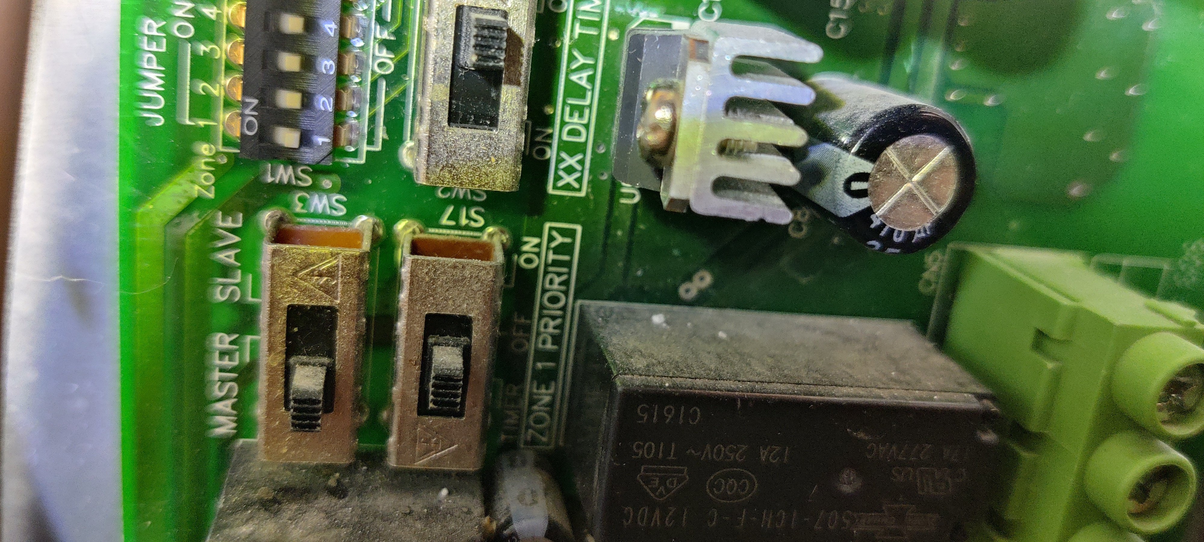

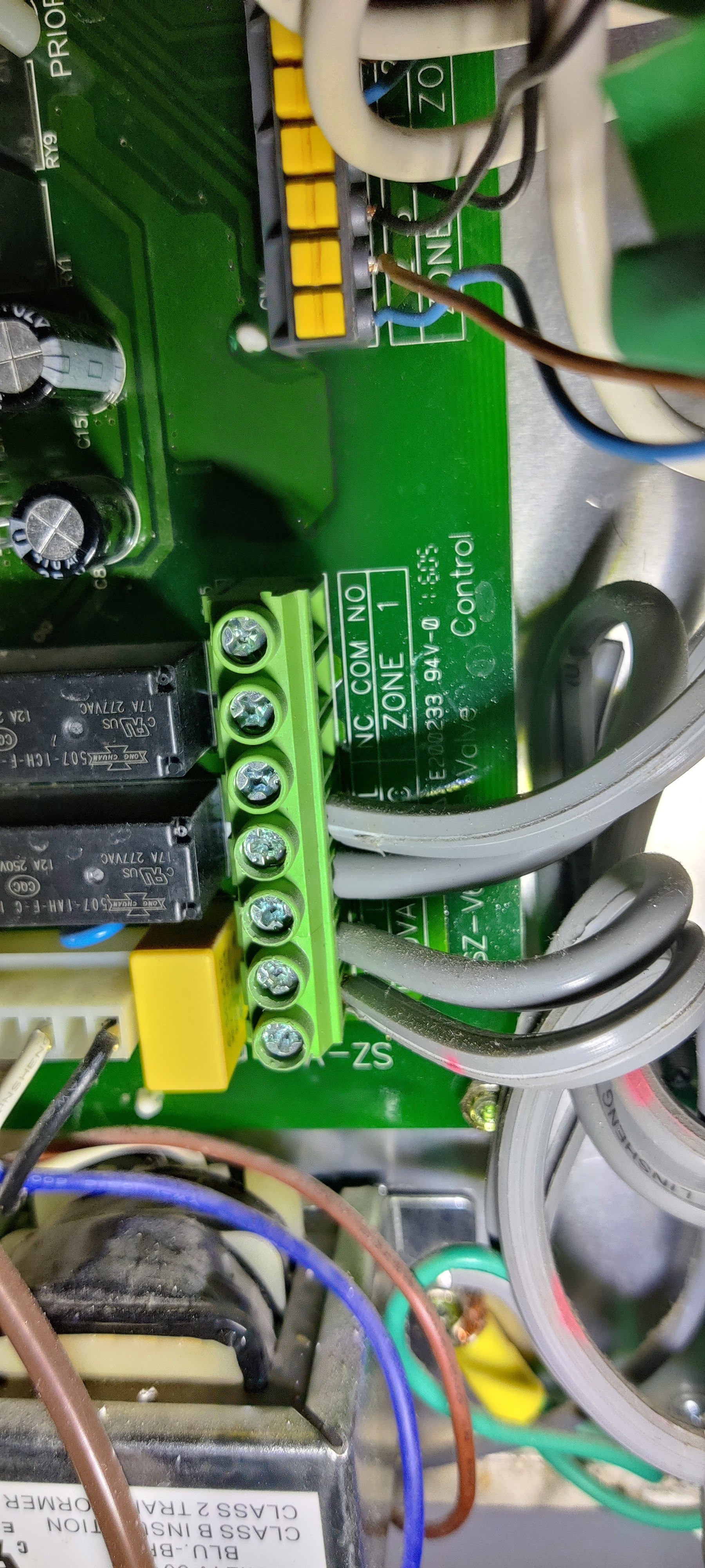

I recently replaced my old tank water heater that was used to heat my radiant system with the navien combi boiler. I'm trying to understand how to connect my valve controller to the boiler.
The controller is an I-link which powers the circulator pump and valves.
Do I wire from the Zone 1 location on the controller to the boiler? Where do I land on the boiler? TT or Zone 3?
The controller has a master/slave switch. It is currently set as master. When wiring to the boiler would I need to switch to slave?

    Master / Slave is probably if there is more than one I-Link controller.

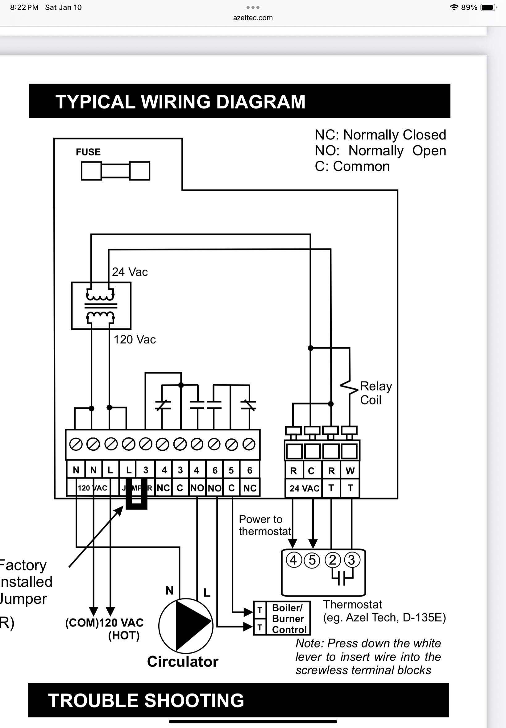

    that may be an Azel brand control, the wiring should be similar to this, or go to the Azel site for and earlier version wiring schematic
    There should be a NO , normally open, and C common connection to wire the boiler TT connection. 2 conductor thermostat wire is fine.
    The priority dip switch to off if you don’t have an indirect

    I can't quite see if this priority switch is on or off? It would seem to indicate indirect priority is zone 1.

    https://azeltec.com/images/SZV6instruction.pdf
  • Tallred
    Tallred Posts: 4
    The diagram from azeltec.com matches what I have. If I'm reading that correctly, I can wire from X1 X1 to zone 3 on the boiler. Am I correct? The zone controller does control the circulating pump.
    If I understand this correctly, the controller will start the pump and request hot water when a valve is open, dropping the signal when the valve closes.
    I'm going to check voltages but my understanding is I connect to the NO point on the boiler. Is that right?

    Thanks for the help. I've been away for the last week.
    I got everything hooked up today and it's working. Thanks for the help.
