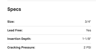

    That seems like a high cracking pressure, being low lead it may be more for domestic water applications?

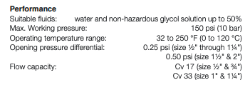

    Screenshot 2026-01-08 at 9.48.53 AM.png Screenshot 2026-01-08 at 9.49.06 AM.png
    Typical hydronic spring checks crack at .25- .50 psi. I believe the same for the internal circulator checks ICFs.

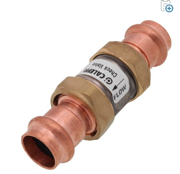

    A serviceable check is a handy feature, debris can cause them to leak through. Here is an option.
    Screenshot 2026-01-08 at 9.50.05 AM.png Screenshot 2026-01-08 at 9.49.50 AM.png

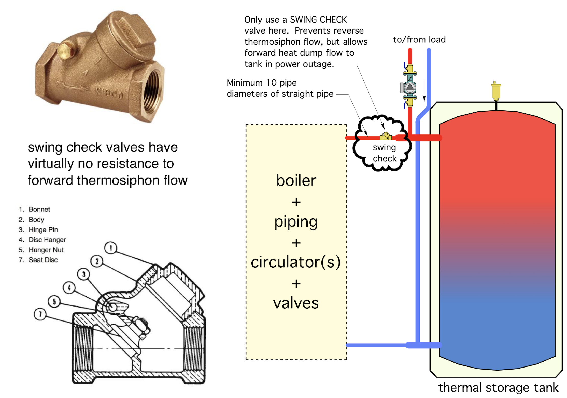

    Swing checks don't have a place in hydronics as they depend on a backflow condition (pressure differential) to close. Although they work well for over-heat protection as they will leak across
