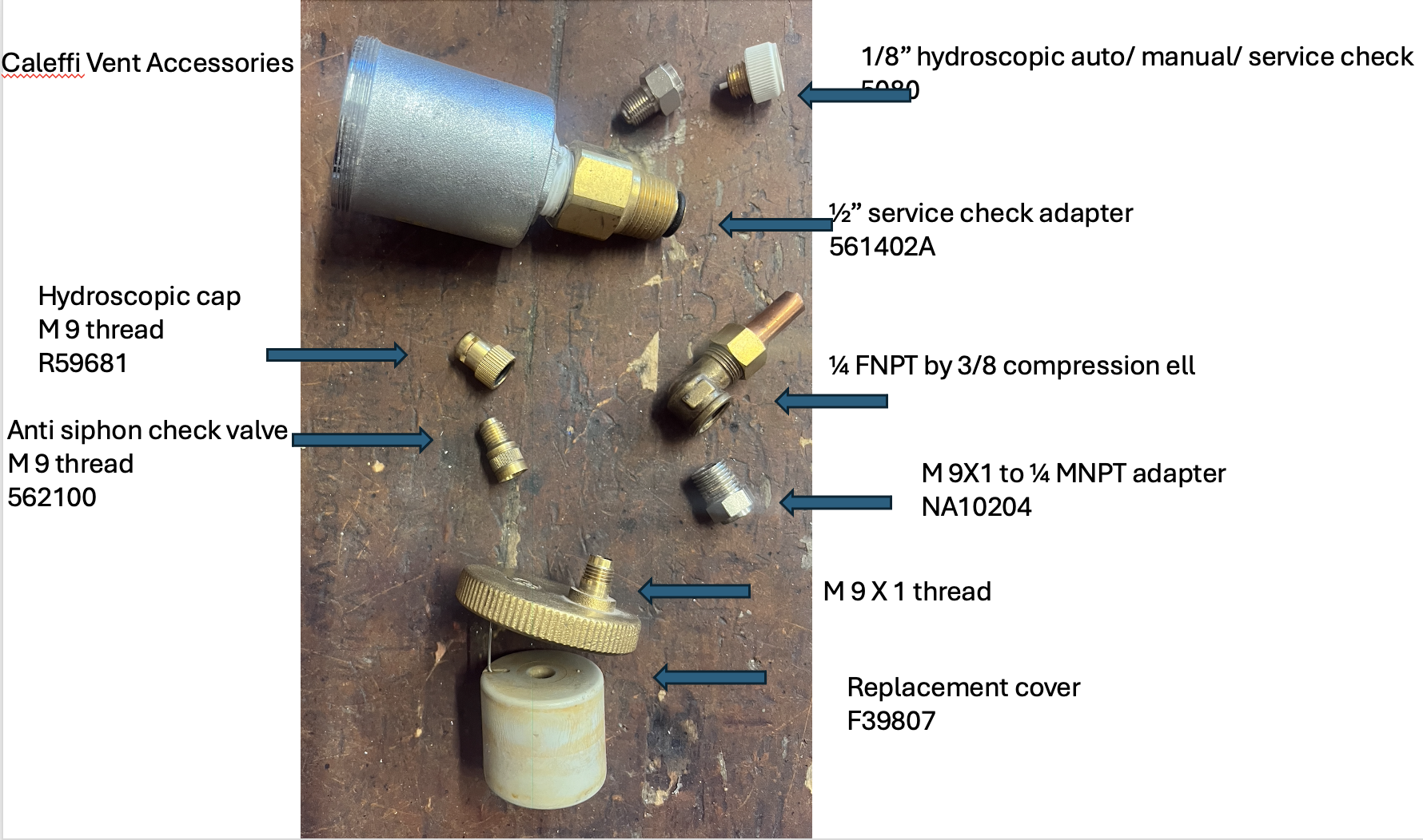

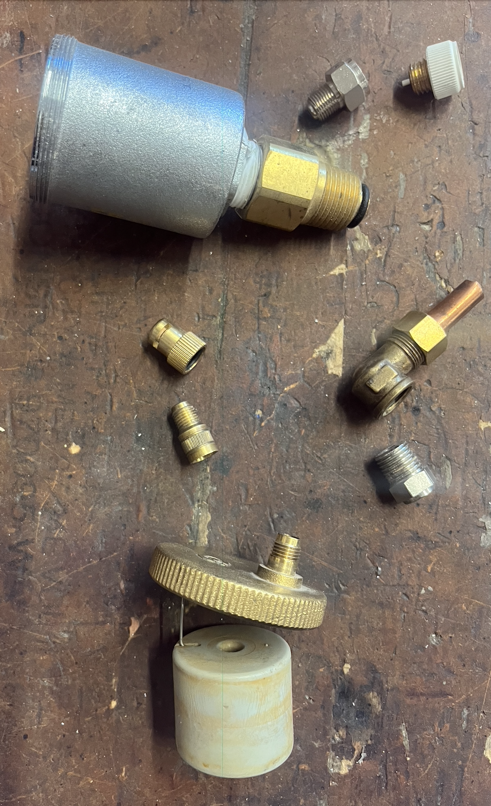

    Any brand of hydroscopic vent will need occasional replacement. We suggest every 3 years on the Caleffi. It really depends on how many wet dry cycles the see, dirt in the system, etc.
    Caleffi, probably others have a manual off position should a leak develop the tenants should know how to turn them off.
    A float type auto vent is an option, not a great looking solution, and more prone to damage mounted high on a radiator.
    With the additional accessories a float type gives you two shutoff mechanisms, the internal float and a hydroscopic cap. Plus an added "anti siphon" check to prevent air from going backwards into the vent.
    This pic from top shows an 1/8 hydroscopic auto/ manual/ and built in service check
    A service check on on the plated auto vent body.
    The anti siphon adapter, hydroscopic cap.
    To the right the chrome thread adapter to put a NPT thread and discharge tube on the vent.
    So you have a few options to select from.

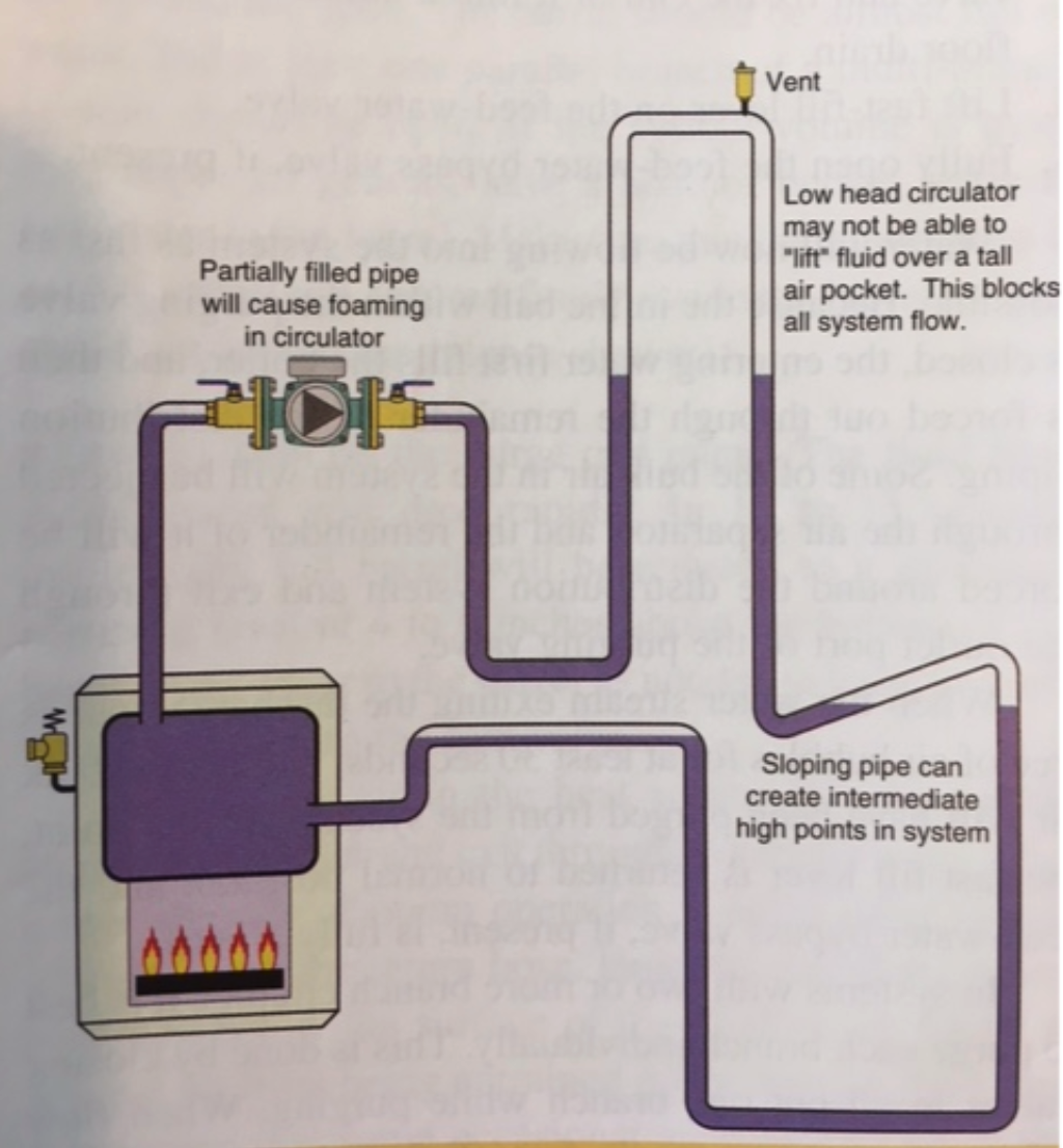

    hot_rod Posts: 28,708

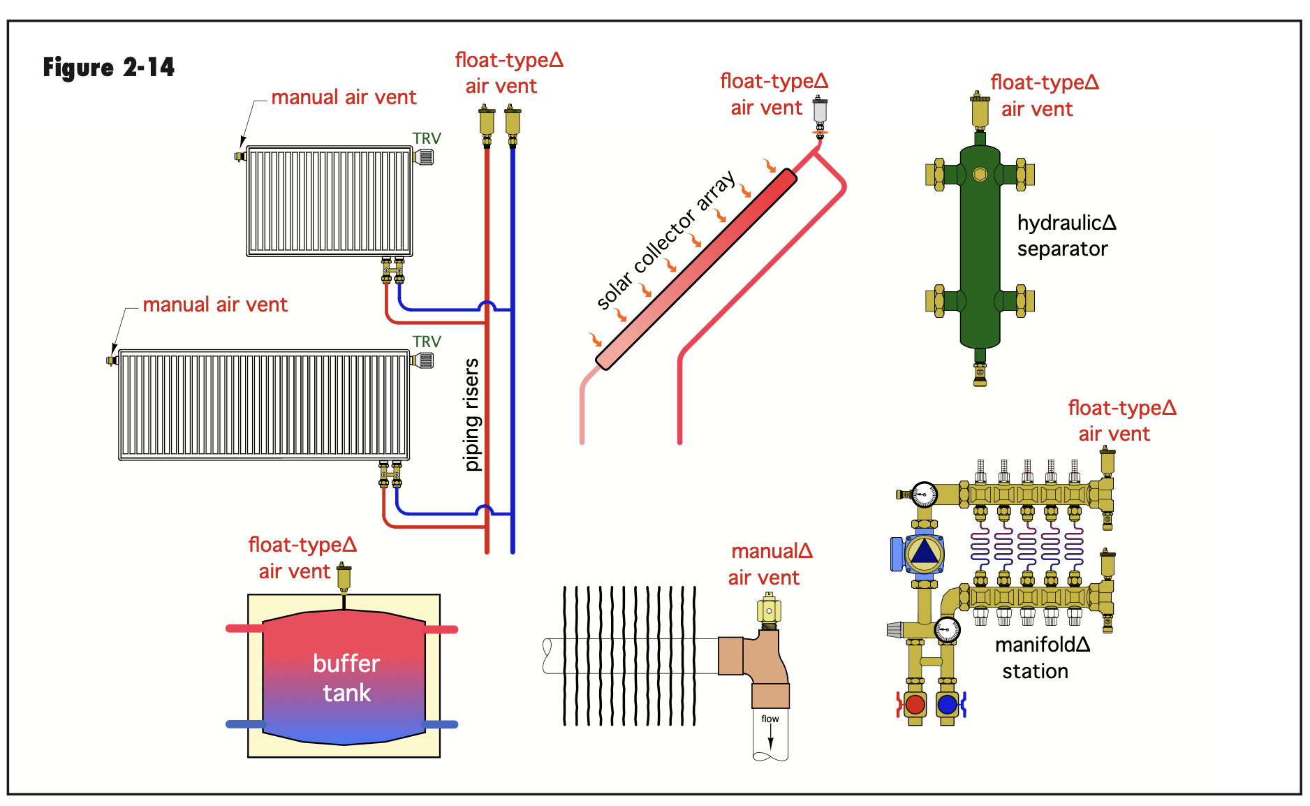

    The vents at cast radiators, for example are considered high point vents. Typically useful at first fill. Over extended periods on off cycles air will rise to high points, the radiators are high point areas. So any type of vent there is a compliment to the purger back at the boiler.
    Vents on radiators can be the only option if the purger at the boiler is: non existent, improperly applied, plugger, or low quality.
    Piping and flow velocity has a lot to do with air removal. Slow velocity under 2 fps doesn't allow air to be pushed along with the water flow, so especially on down flow in vertical piping, you need around 3-4 fps to push the bubbles.
    Variable speed pumping and large pipe diameter gravity conversions present even more air removal challenges. You need a lot of flow in a 2" pipe to shove air down the road.
    the air will dissolve in the cooler water in the emitters when the system cools and be removed at the boiler if the air elimination is designed right, put in the hottest and lowest pressure part of the system where it will come back out of solution.

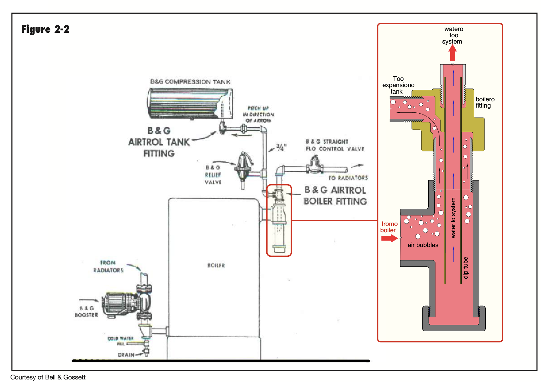

    The mechanics at work with the various air removal devices.
    With a compression tank you should have the Airtrol fitting for best result. The boiler it self is doing most of the air separation, the fitting assures it goes into the tank, and stays there. Some boilers had sectiond designed as air removal function.

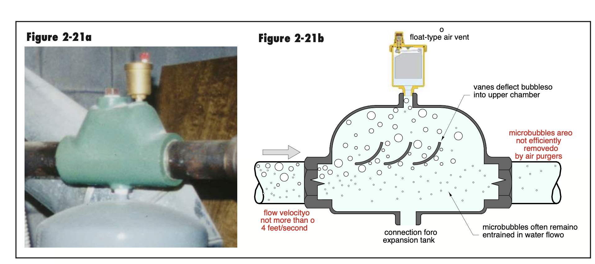

    The scoop or ramp "camelbacks" depend a lot on slowing the flow.it a wide spot creating a low velocity zone. So you want enough flow to get air to it, but not too much that air blows right through. The vanes inside and buoyancy of the bubble is at play also. A section of straight pipe upstream allows the bubbles to start to rise to the top of the pipe for a better removal opportunity in the "ramp"
    I've done numerous glass pipe demos with this type of purger, they struggle to grab the microbubbles. The bubbles often smaller than the eye can see.
    With microbubble type air purgers flow velocity doesn't have a lot of effect. It is still a low velocity chamber like a camelback, but the media stops and traps the bubbles. Microbubble resorbers were developed mainly to eliminate the smallest bubbles within 10- 20 passes through the device. Critical on glycol systems and high efficiency low water content boilers
