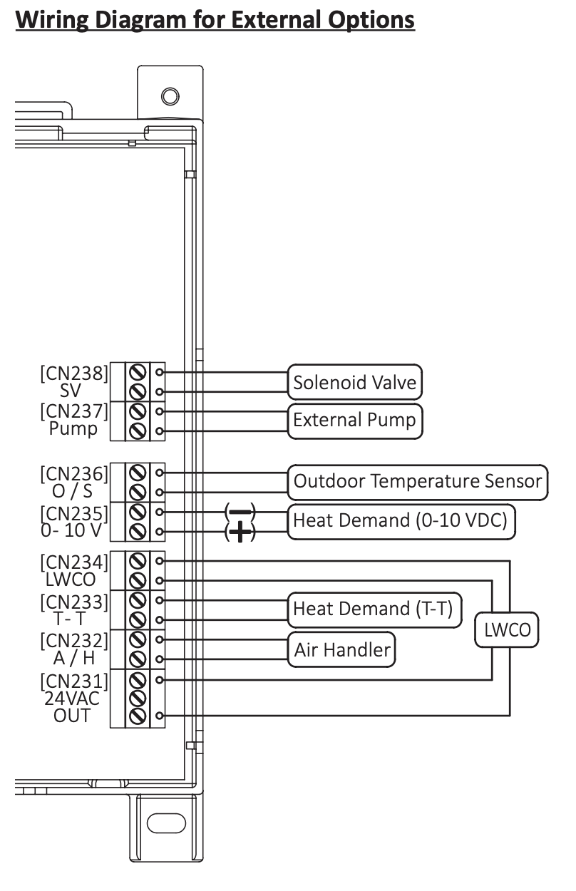

We have a Noritz NRCB199DV combi boiler installed in 2019 by a definitely-not-factory-authorized contractor. The setup includes a 20 gal buffer tank and a single-zone Taco relay with some sort of analog hydrostat, and the single zone consists of 6 emitters - all either fin-tube or panel radiators, and not nearly enough to allow us to run the boiler at condensation temperatures, but that's a separate issue.
The contractor set up the boiler to be controlled by the indoor thermostat used by the prior furnace. I'd like to replace this with outdoor reset and want to get a sense of what I'm in for. I understand the unit should have come with the outdoor temperature sensor (Noritz part NPH-190 I believe), but because the installer didn't provide it, I'm going to buy one. I also understand that adding a control unit can be helpful, though not essential. I've been looking at the Tekmar 256 and the Taco PC700. Our setup includes the Taco pump control so not sure if it's worth staying consistent with that or not, or whether I even really want a controller separate from the features and capabilities of the boiler itself. Thoughts and suggestions happily accepted!

    I believe the Combi Boiler already has the outdoor reset ODR logic in the control panel. No need to purchase a Taco or Tekmar. All you need is the sensor connected to the proper place on the boiler.
    The instructions on how to operate the ODR function are on page 54 of the Noritz GHQ manual.

    hot_rod Posts: 28,705
    I second using the onboard reset function, no additional parts or interface, settings display on the boiler control screen
