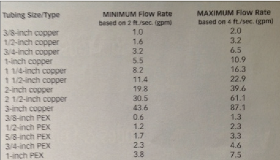

    hot_rod Posts: 28,705
    Purging, or power purge with a pump, to me, is pushing enough flow thtough the tube to remove air and any dirt ot debris. To move heavy particles you need about 5 fps velocity. I would consider that closer to 1" pex size, so you need about 8 gpm flow

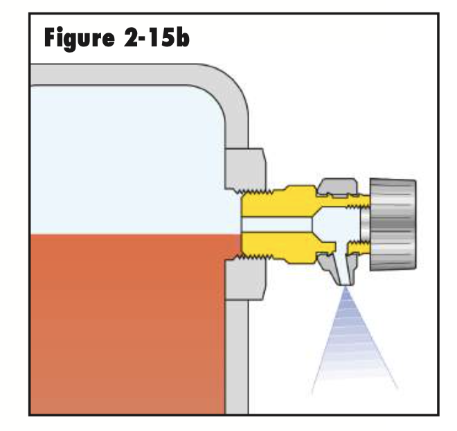

    Bleeding is more for removing a small air bubble trapped at a high point in a tank or radiator, for example
