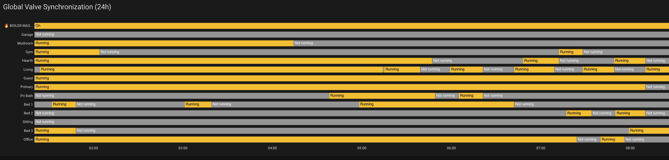

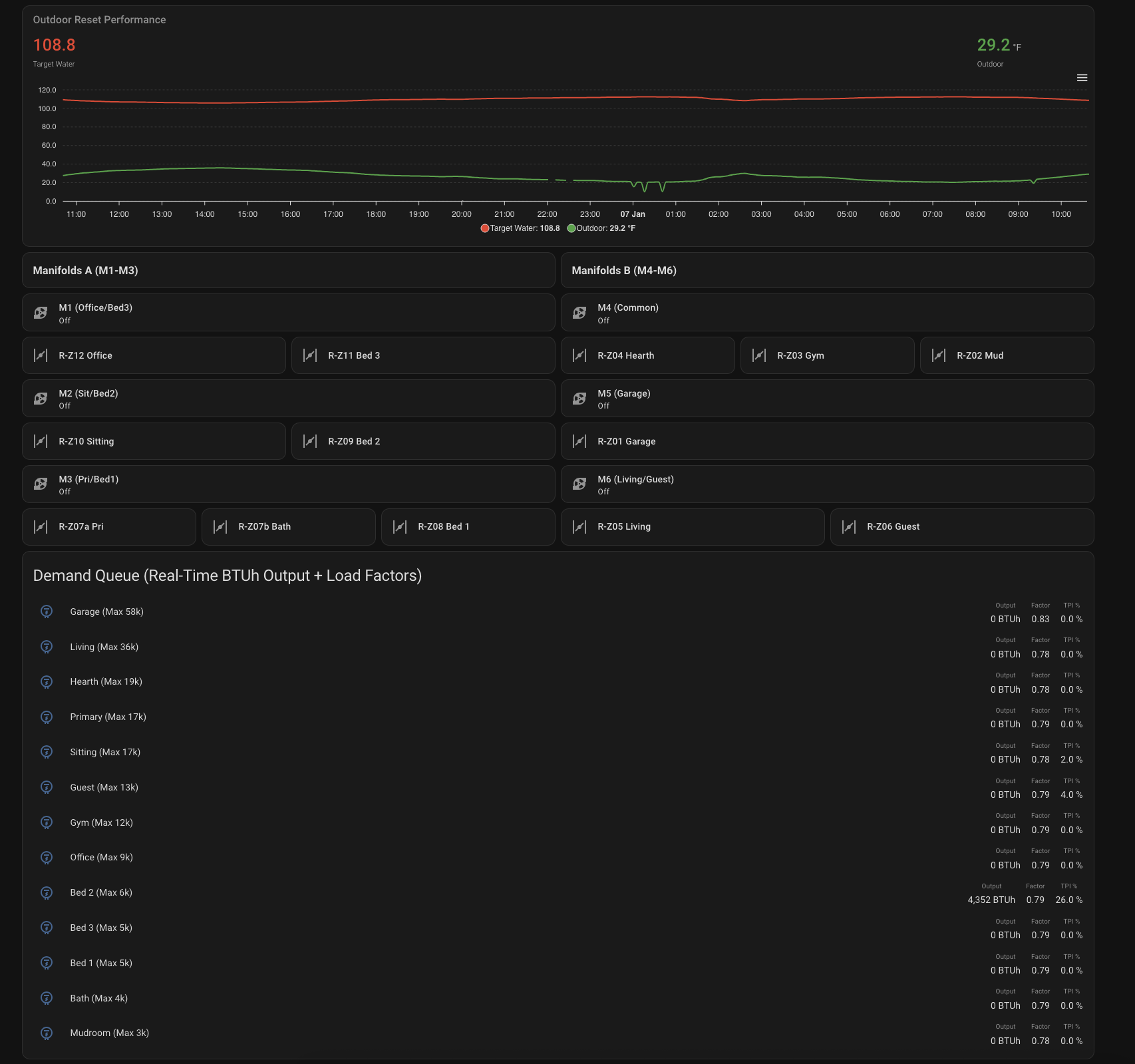

Hi folks,
First post but periodic lurker. I've been working on a project for myself that is essentially an orchestration layer for controlling the radiant system for my home and as I was writing the documentation (for my own memory purposes) I decided that others might find something like this useful. My house had a pretty simple implementation of a bunch of smart thermostats that operated as their own individual brain vs. a centrally controlled system and had some short cycling issues for smaller zones, so I decided to solve that with some software :) It's runs/requires Home Assistant and is built in python (via pyscript) and I'm at a point where I think it's good enough to consider sharing. Since this was purpose built for me (via learning/iteration/testing, etc) it has a good bit of specific details to my house however I could spend some time cleaning it up and making it more generic and reusable by others if it would seem useful.
I've included some dashboard pics of the system. Note that these include some purposeful testing of overshooting and crash recovery over the past couple days as I am still making some operational tweaks and ODR curve tweaks.
Let me know if there is any demand for something like this beyond… me :)
Full details here: https://github.com/pcericm/radiant_manager/blob/main/README.md (the code is actually in a private repo but I shared the README to a public location). Definitely check it out because it's pretty exhaustive (I'll forget how the thing works once I stop tuning it so a bit of verbosity :))
Here is the tl;dr
This project is an intelligent orchestration layer running in Home Assistant (Pyscript). It sits between your smart thermostats and your boiler/valves, treating them as simple sensors and actuators.
Key Features:
  • Orchestration vs. Control: Instead of reactive on/off, it uses TPI (Time Proportional & Integral) logic to "Pulse Maintain" slabs, preventing overshoot.
  • Physics-Aware: Solves the "Minimum Fire Rate" problem by intelligently batching zones and recruiting smart buffers (e.g., heating the bathroom and the sitting room) to ensure the boiler runs long and efficient.
  • Solar Feed-Forward: Features "Rocket Logic" to brake early on sunny days and "Catching the Knife" to pre-charge slabs before cold nights.
  • Hardware Agnostic: Works with any thermostat exposed to HA (Ecobee, Nest, Z-Wave, ESPHome).
It turns a collection of disconnected zones into a single, cohesive, efficient fuel-sipping machine with lots of customizable knobs to tune the overall system.

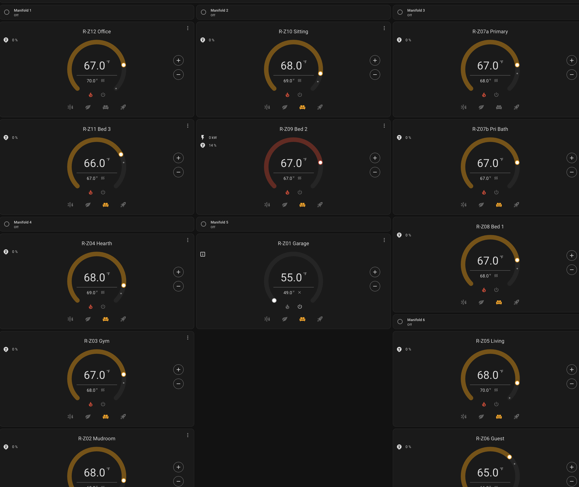

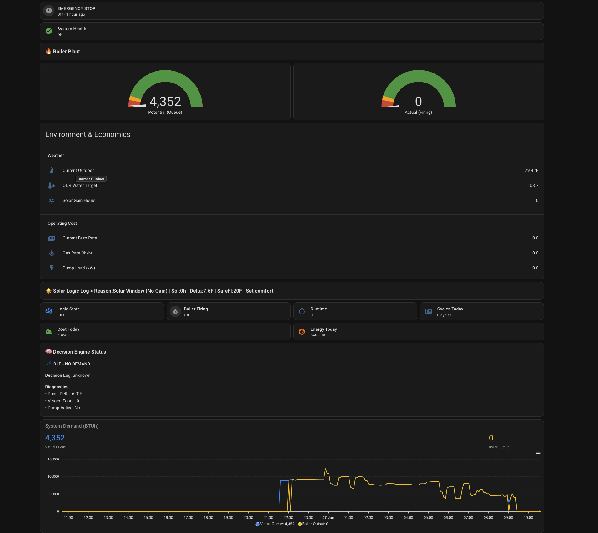

Here are some snippets of the dashboard system:
Primary view:
Primary view (2nd part) (BTU loads dynamically adjust with outdoor temp)
Temperature Control

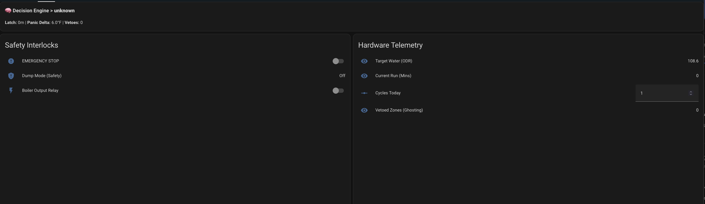

Details of the brains (need to update the decision engine log):

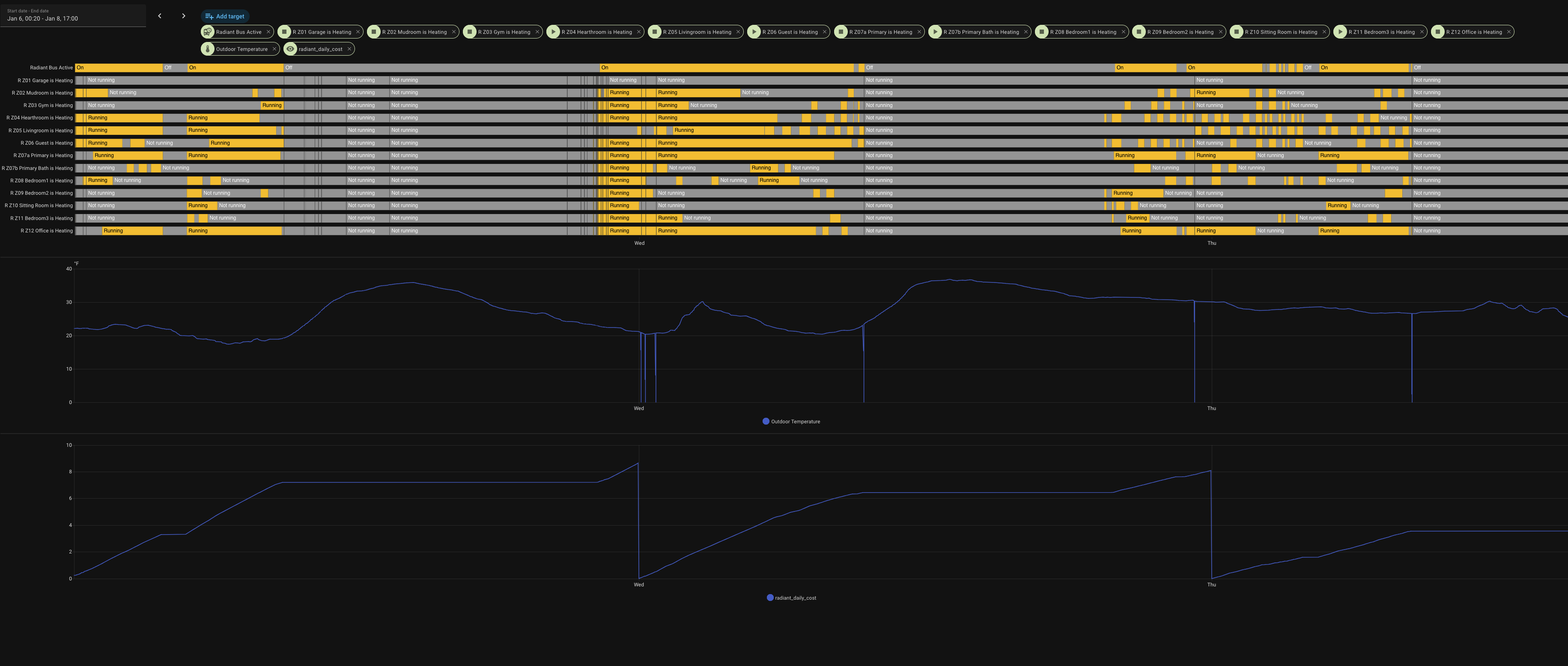

Overnight zone view (zoomed in to smaller window of time for more details)

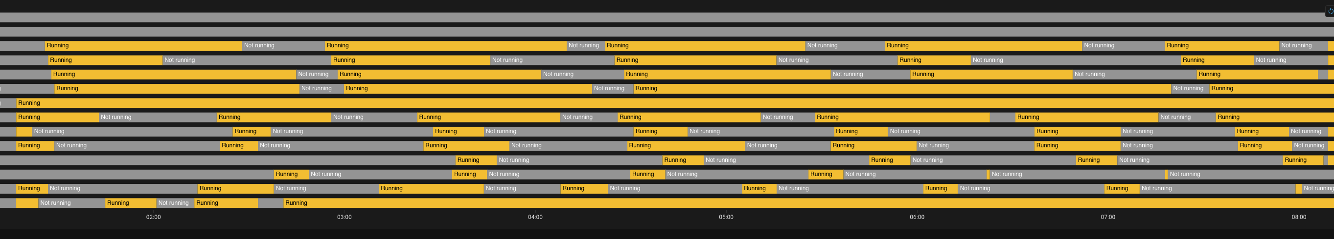

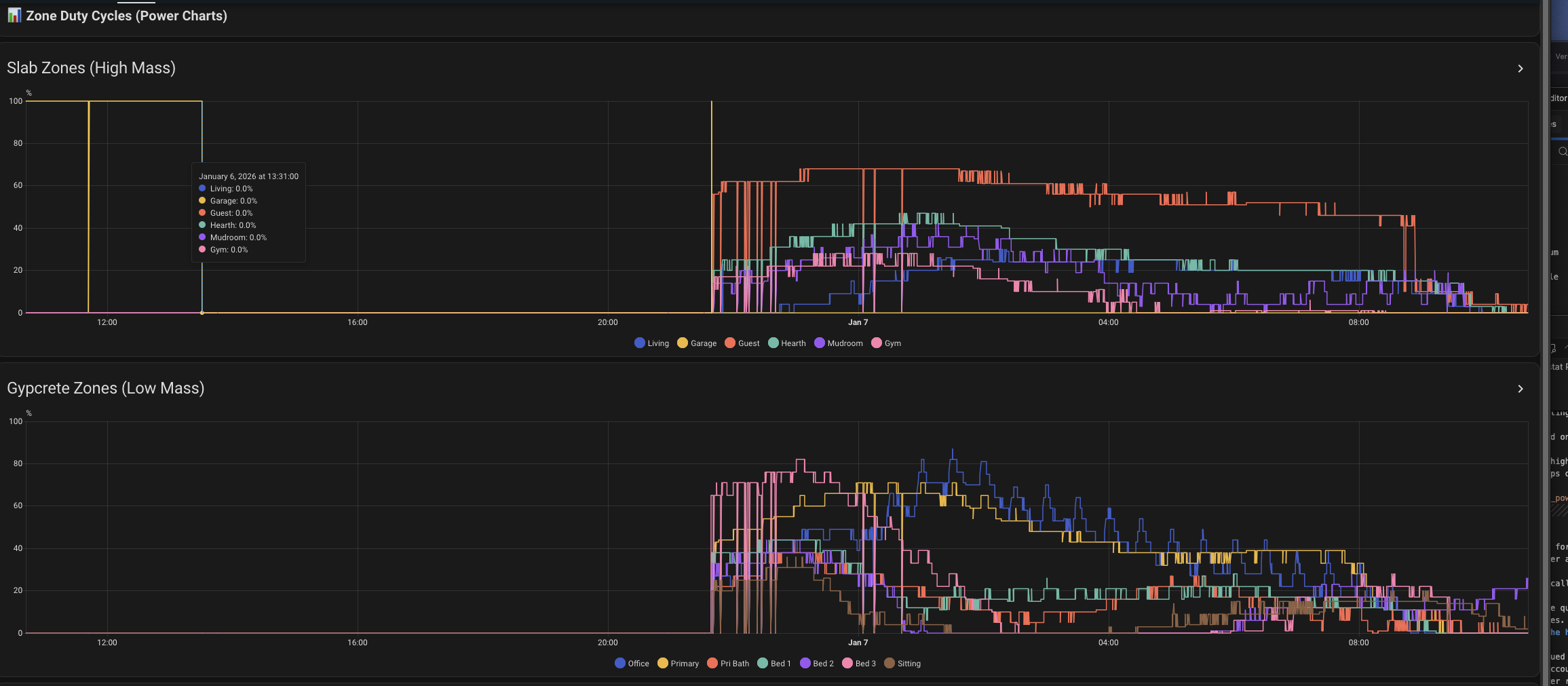

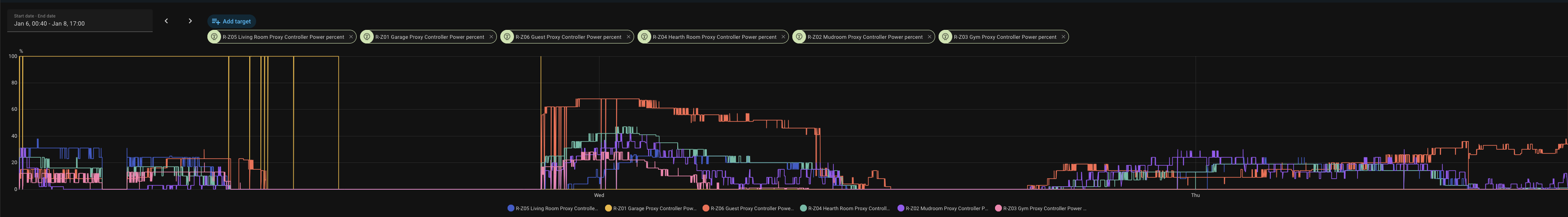

Duty cycles per zone (note the flat spot/system off to cool) The jagged spikes are actually from my forced air systems circulating air so there is a bit of dampening in the enter/exit of the system.

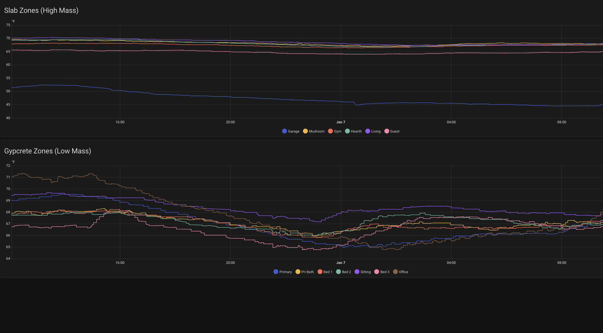

24 hour zone temp differences (with crash in between). This does a good job showing different programming tunables between two days with similar conditions

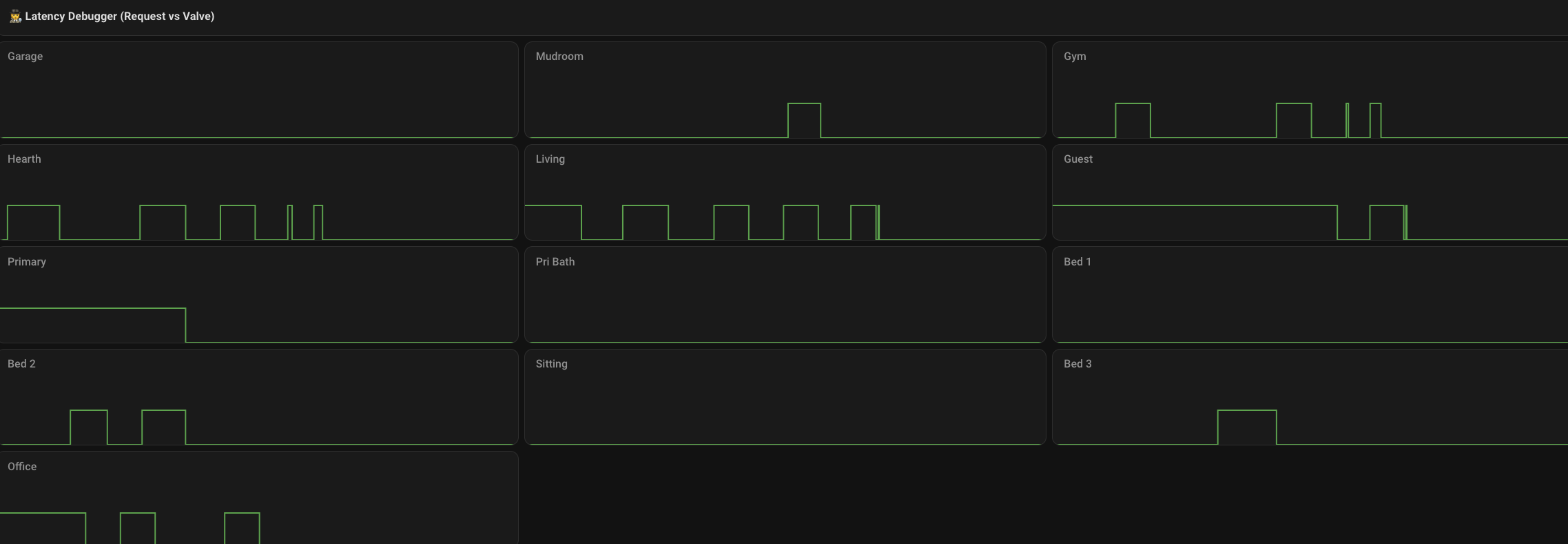

This will show a call vs. valve status (stuck valves show up here)

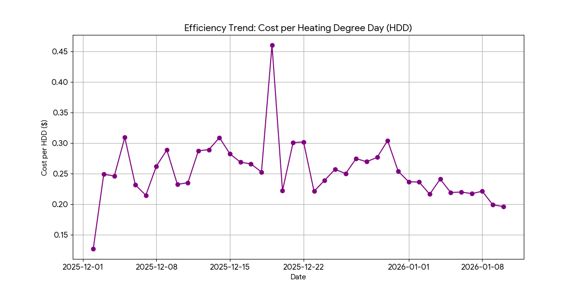

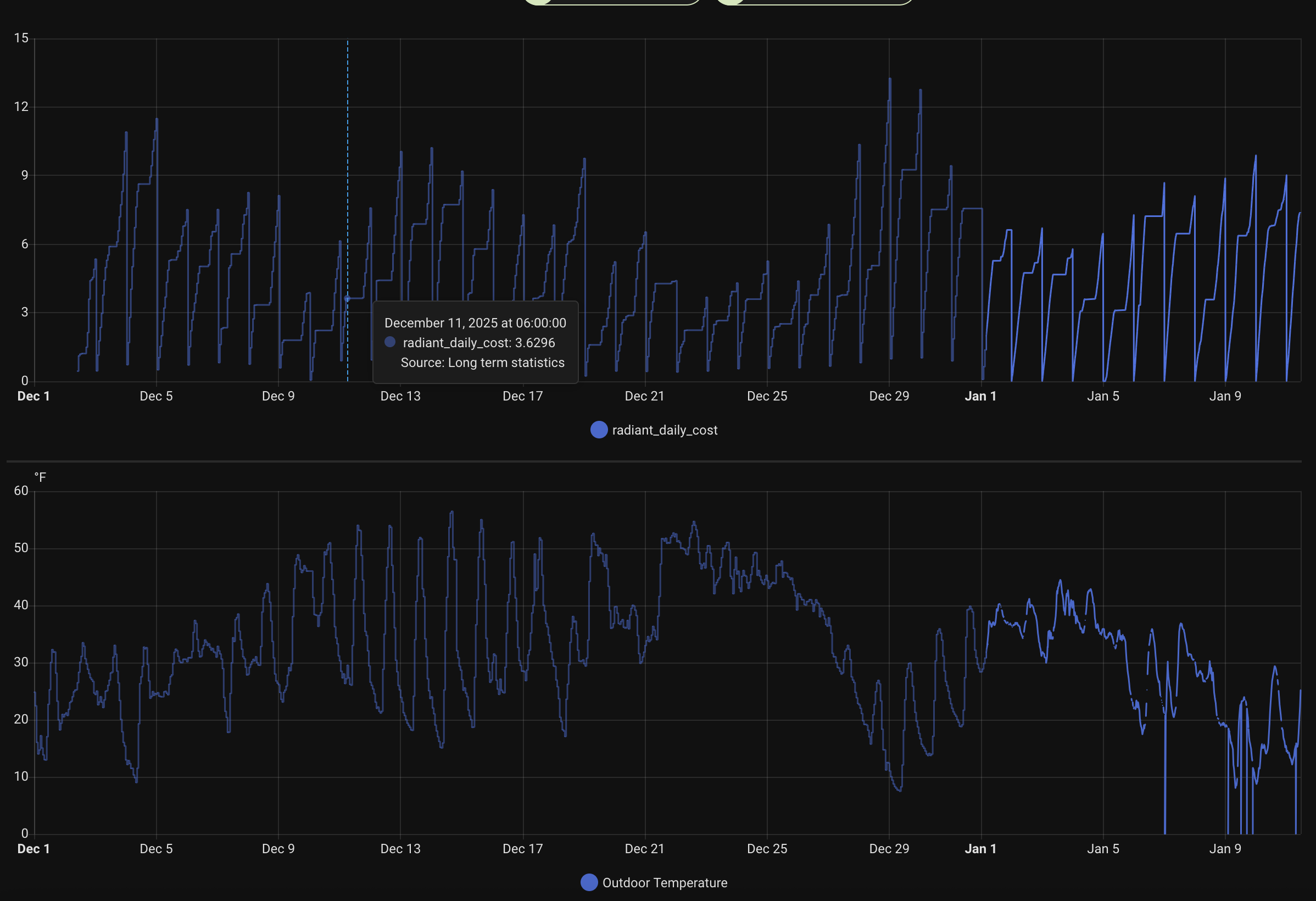

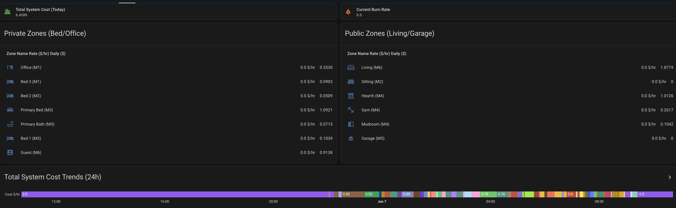

Real-time and per day cost per room! The first column will show active fire cost and the second is accumulated. Costs dynamically cost with real-time BTU loads

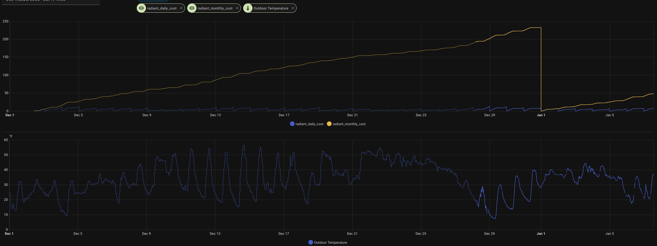

Daily and monthly cost (just about dead on since it's load factored).

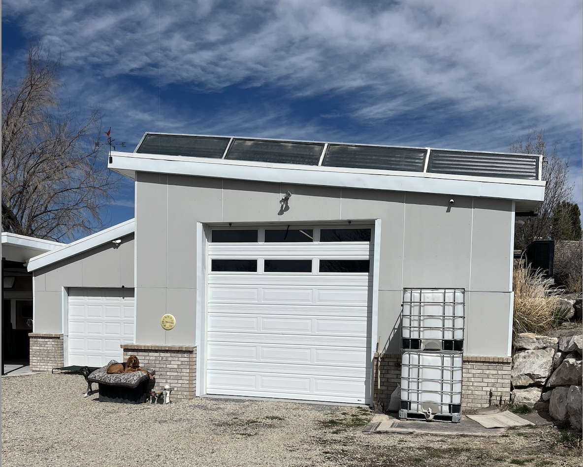

    Personally I would go with PV instead of thermal now a dazes. I'm running heat pumps at the shop and house and have an EV, so electricity is more useful.
    Although I have a large homebuilt thermal collector on the shop, mainly for DHW generation, and the homebuilt outdoor shower you see.

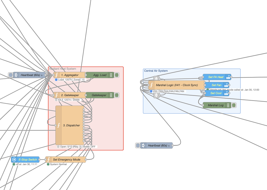

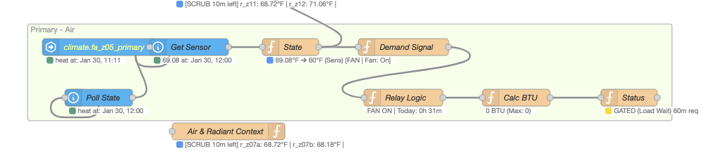

    New here too and I also built something VERY similar to this haha. Mine is more of a "so simple you don't know its there" design though. I didn't want to get stuck in the Home Assistant trap so I went with Raspberry Pi devices for my zone controller and thermostats.

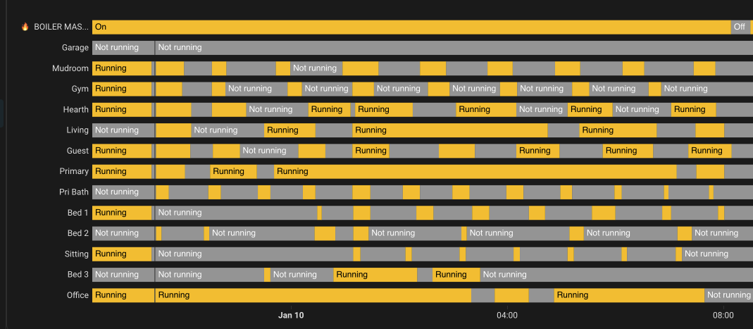

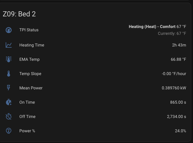

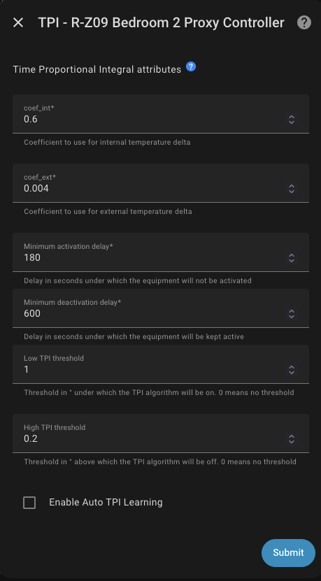

    @DCContrarian I am using versatile thermostat (https://github.com/jmcollin78/versatile_thermostat) within home assistant. I've set up my ecobees as basically dumb on/off switches and have a proxy layer to interact with them (you don't even need this, but I did it because I've been playing with things like zone scavenging, load accumulation, etc…). You can set up the TPI configurations as a central config, or you can use per room TPI settings which controls the pulsing based on it's observed behavior of each individual room. As an example if you have a high BTU loss room (drafty or lots of glass) you could set a very reactive algorithm that basically calls for larger chunks of heat faster (or the reverse for slower/stable slabs). There is an external temp factor as well that you can tune that basically adds a baseline of required power so it can fight the cold faster (or slower if your house is super tight).
    Here is an example of a room with gypcrete right now. It has a cycle time of 60 minutes, and to maintain the 67F setpoint it believes it needs to pulse for 865 seconds out of the 3600 to maintain. In the next hour it'll re-evaluate where it is in relation to that setpoint and will either add more or less time.
    Here are the settings for TPI for this zone:

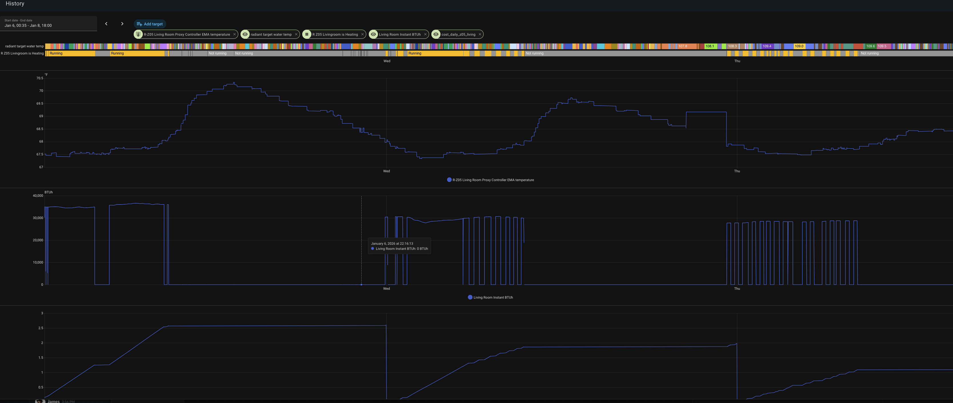

    Here is the chart for that zone (its set point is 67F) — you can see when it gets a bit of sun ;-) The system pulled out of it's solar brake around 330 and started a pre-charge. The algo is still 'settling' down as I have been changing it a good bit but given how much sun we had today it didn't do too bad. It'll be interesting to see how smooth it could stay on a consistently cold day. Today's range was 8F to 33F.
    Here is last night up through ~830-9am today. You can see some of the variability in the length of run times as it's adapting based on the environment.

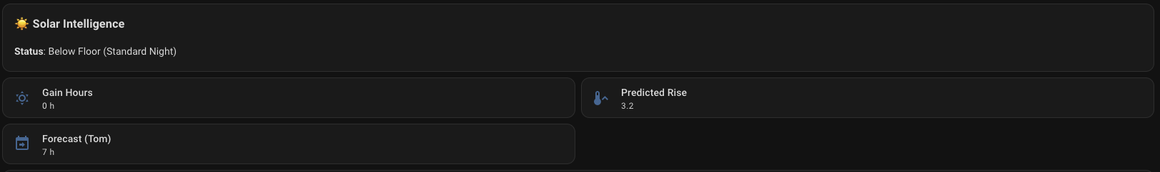

    And I have a solar brake that pulls the forecast, calculates the impact of the weather and will potentially put the brakes on the heat if necessary. In this case (as of now) the forecast sees that we'll have 7hrs of sun tomorrow and we've calculated a potential solar impact of about 3.2F. From there I can do different things; I can back off heavy slabs early in the AM (2-4AM depending on impact) and maybe be less aggressive with gypcrete zones, maybe those are 60 minutes before sunrise, etc… The cool part is that it recalculates all of this every 15 minutes so if the forecast drastically changes or something from my weather station (ie; starts raining) signals us of a change of plan — we won't leave the house in a vulnerable position. The same script calculates slab pre-charging in the evening so if we're going to have a cold night and we need to 'catch the knife' as that much solar gain may keep the slabs off for 12+ hours, we can do it a little easier.

    Kind of fun to see tangible impact to the cost of things. More efficient and more comfortable is a win-win :) Started rolling out iterations of PWM at the end of December and pushed some improved settings over the last 2-3 days.
    Raw data (cost is in dollars per day):
    What type of environment are you in? Ours is typically much much colder than what we're seeing this year.

    Ahh yeah not the direct motor control PWM — it's very similar though, just on a larger time scale (cycle time). The software I linked you actually does exactly what you're talking about being able to control motors/open %s, etc… I just adapted it to radiant slabs :)

    I recently made a pretty big change to this system that has made life and comfort so much better. I kept a bunch of the reporting/data metrics in place from above but I pulled the logic engine out and put it in node-red which has made it soooo much easier to plumb things together and do what I was ultimately setting out to do. When I get it into a final state I'll provide updated documentation on how to do it but the big changes are as follows:
    • I was finally able to get PID to work properly vs. depending just on duty cycle %s and a brake scenario
      • If I need to wait for the queue, any extra accumulated time to the PID run time will be applied at the next run. So if for instance if a room had a ~20 minute pulse demand and it sits in queue for say 5-10 minutes, it might have accumulated another 2-3 minutes of actual runtime, so that’ll get added when the gatekeeper unblocks the queued zones.
    • Instead of using preset switching for solar braking and pre-charging I was able to implement a feed forward bias into the PID itself. This is pretty cool because the processing logic stays a bit cleaner where all it needs to care about is pulse length/rest lengths per zone based on the PID. The feed forward utilizes outdoor environmental from local weather station + forecast to add or subtract bias, changing the input into the PID by up to ~20% (still playing with sweet spot). This has been working a lot better than just slamming the brakes on 2 or 3 hours before sunrise
    • Incorporated my 5 forced air units to work in conjunction with the radiant system by way of a new air marshal system. Each unit services a subset of the radiant zones so there was some opportunity to do smart things
      • Programmatic air scrubbing vs. the ecobees running 5 minute chunks of time at varying times per hour. Supports quiet time dynamically
      • Air shuttling: basically if there is an imbalance between the radiant zones being serviced by a specific air handling unit from say solar radiation, it’ll dynamically spin up that fan and it’ll start mixing the colder air from the other rooms and warmer air from the room being slammed with sun to flatten the overall temp curve
      • Harvesting: if a single room is either struggling to keep up, or maybe a window or door was left open, it’ll first try to harvest warm air from other rooms, and if not it’ll move onto the next point
      • Heat support: if the above harvesting doesn’t work, or the temperature slope is too steep, the forced air system will turn on the heat and lend a hand. There is significant boosting capacity (7-8F increase in < 1hr)
    • Created a much cleaner input system to the feed forward process where you can see exactly why/how it’s making decisions
    New functionality being worked on:
    • Humidity harvesting: any time there is a meaningful increase in detected humidity from showers, washing dishes, etc relative to the rest of the house the closest air handler will shuttle it before the next air scrubbing cycle
    • Use MRT as the driver of thermal control. Radiant base + more proactive forced air trimming (split PID strategy as an idea)
    • A real BMS-style dashboard that integrates the real time bits of these flows
    Here are some updated screenshots:
    Much nicer cycles. You'll see a reduction in the block sizes towards 8AM as it dynamically reduces the feed forward %.
    System flows(there's a bit of overshoot today but not bad at all given the temp has gone from 6F → 41!):
    ODR / Feed Forward Input data (bias %/brake):
    Brain core:
    Air handler performing air scrubbing:

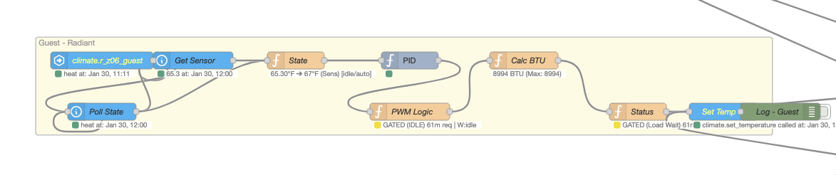

    Air handler performing harvesting for guest radiant(r_z06) (note temp delta (on purpose for testing)):
    Same guest radiant zone that is utilizing harvesting above (note the gated status):
    This new implementation still requires home assistant to manage the homekit+thermostats interaction since I didn't find a great homekit option for node RED. What I am probably going to do is just run a small home assistant core + node-red on it's own LXC or maybe even it's own industrial PC to just live on it's own :)
