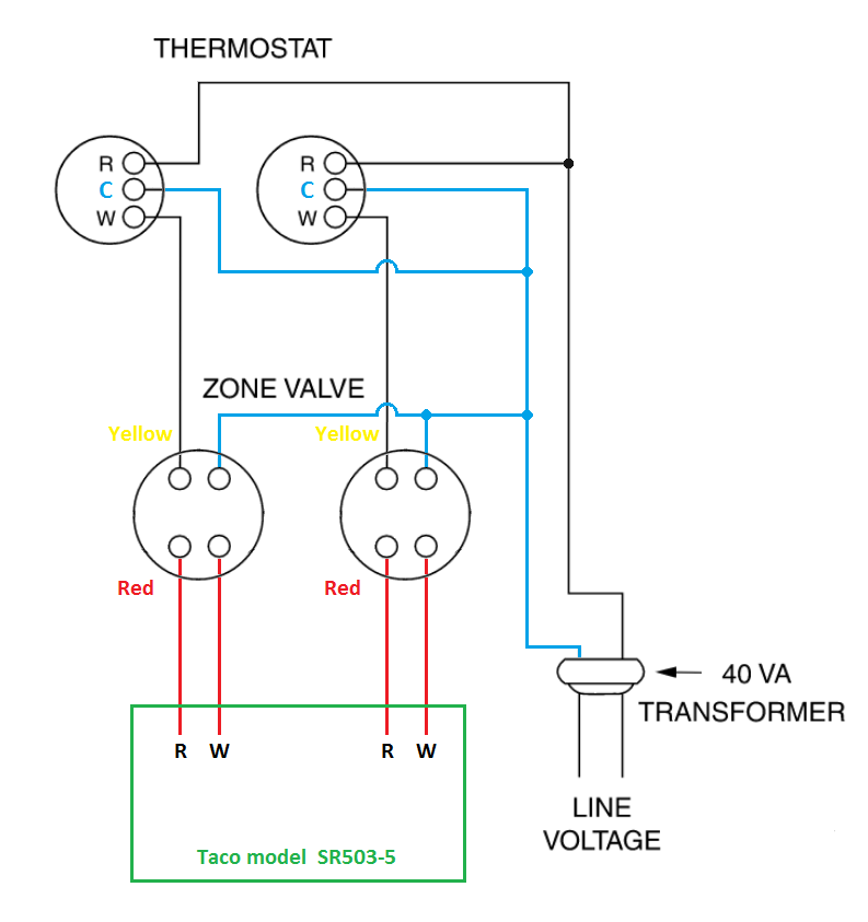

    I would do it like this, using your external transformer since you have the added loads of the zone valves. Thermostats control the zone valves, the zone valves control the Taco SR503-5.
    SR503 XX goes to TT on the boiler.
    Looks like the boiler TT is P5-7 and P5-9

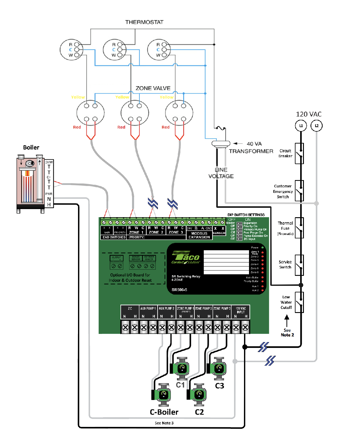

    EBEBRATT-Ed Member Posts: 20,712
    Here is my version down and dirty and quick. I may have missed something.
    Don't know if the main pump is powered from the boiler.
    You may need some sensors wired
    I did not show ground wires that are required
    edited January 7

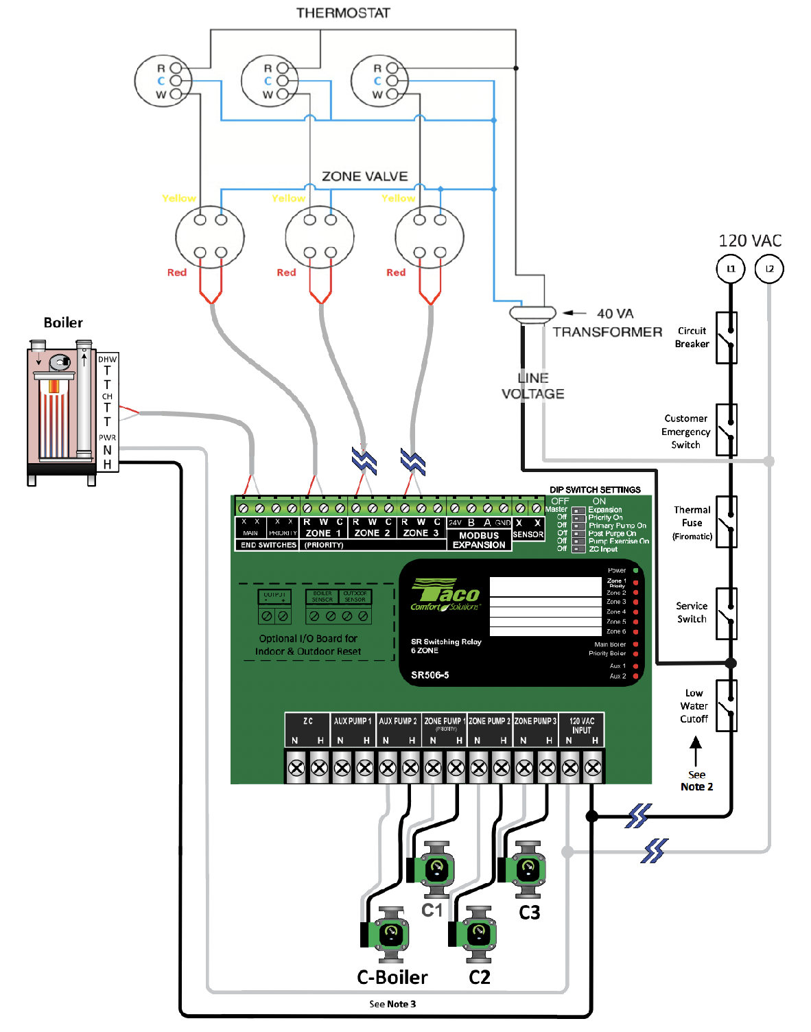

    Here is My version. I think it is eactly like @109A_5 and @EBEBRATT-Ed diagrams but sometimes it is easier to see it in the complete form and not just the part you are asking about.
    This is using the SR503-5 control. If you are using the SR503-4 I can re-do it with that control's diagram.

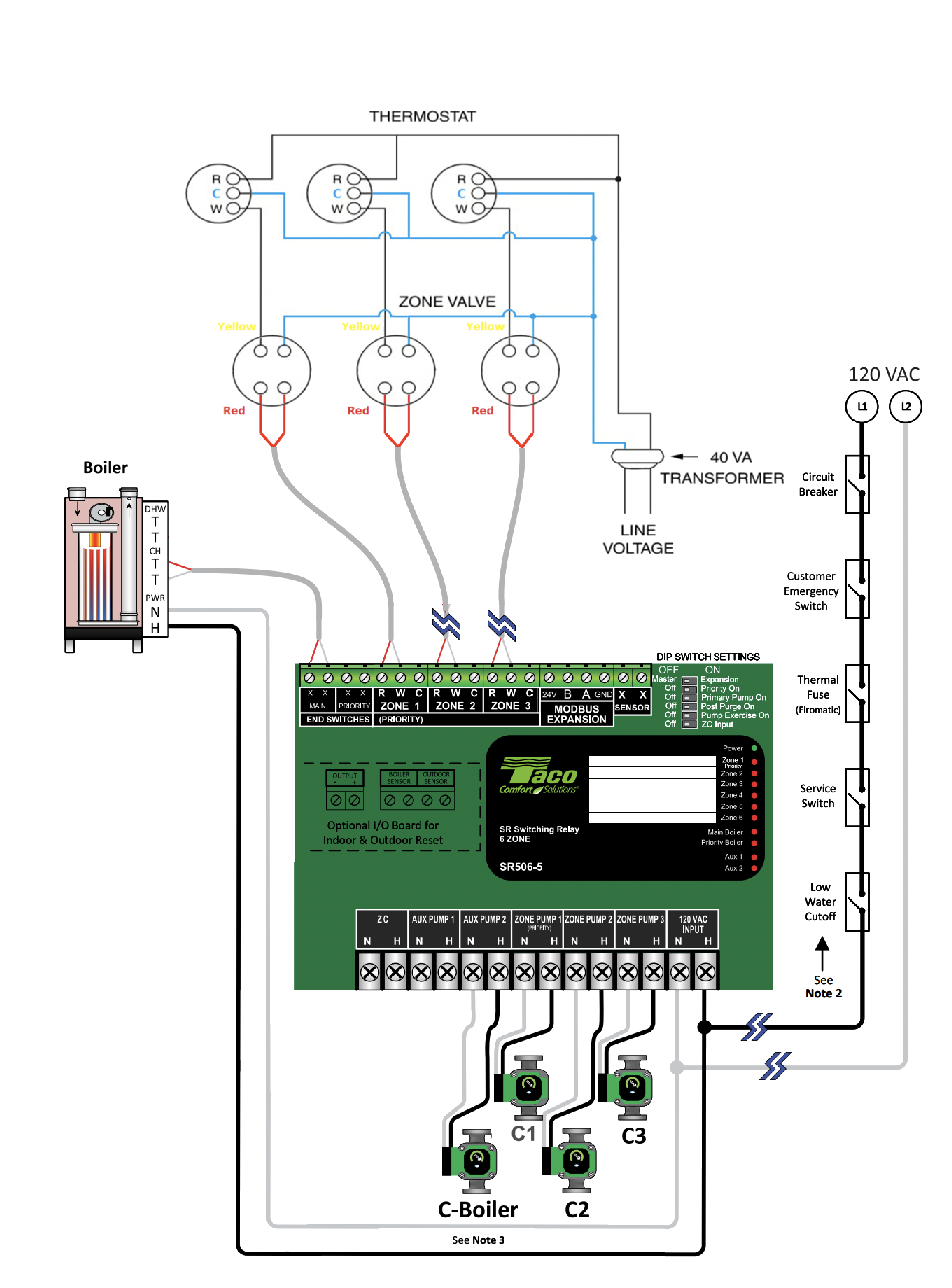

    If your Taco SR503-5 has the optional additional transformer for the additional loads of the zone valves and powered thermostats. You could do it this way.
    @109A_5 said: "If your Taco SR503-5 has the optional additional transformer for the additional loads of the zone valves and powered thermostats. You could do it this way."
    (Ecobee load + Zone valve Load) x 3 + Taco 503-5 load =
    (3.5 + 7.7) x 3 + 1.8 = 11.2 x 3 + 1.8 = 33.9 + 1.8 = 35.7 VA
    That might be getting a little too much for the Taco 503-5's onboard transformer. (which is only 20 VA without the optional second 20 VA transformer for a total or 40 VA).  I would stick with using the auxiliary transformer if you already have it.

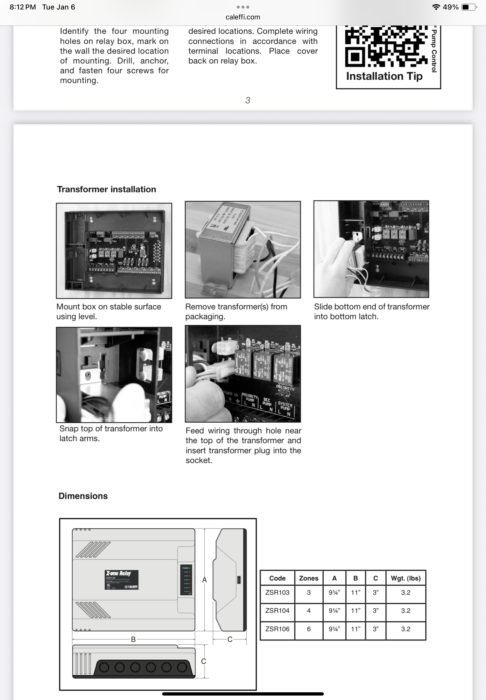

    hot_rod Member Posts: 28,010
    The Caleffi pump relay box has a replaceable 40VA transformer onboard, that would eliminate the extra transformer and wiring
    If you haven’t purchased parts yet.

    Thanks everyone.  I woke up in the middle of the night yesterday with what I thought would work.   I gave it a try on one zone and sure enough it did!  So I spent yesterday getting all components down to their individual wires and started over fresh.
    I hadn’t seen your comments until just now.  But what EdTheHeaterMan shows in his post is exactly what I did with the exact unit I had already purchased.  The challenge was to keep all the wiring to a minimum and as neat as possible.  I used WAGO’s instead of wire nuts and that helped a lot.  I kept the stat connections inside the Taco and put all the others in a separate adjacent box.
