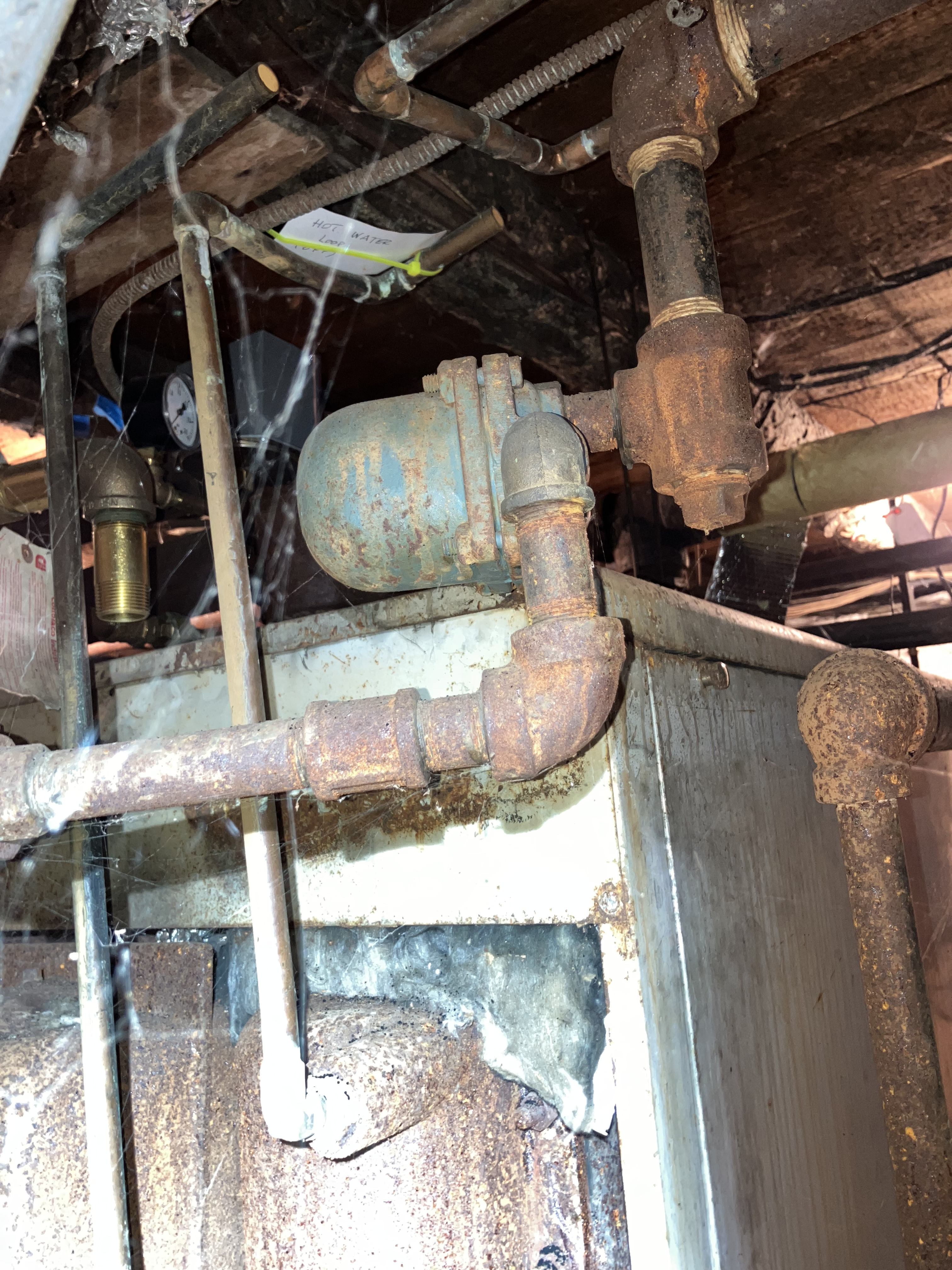

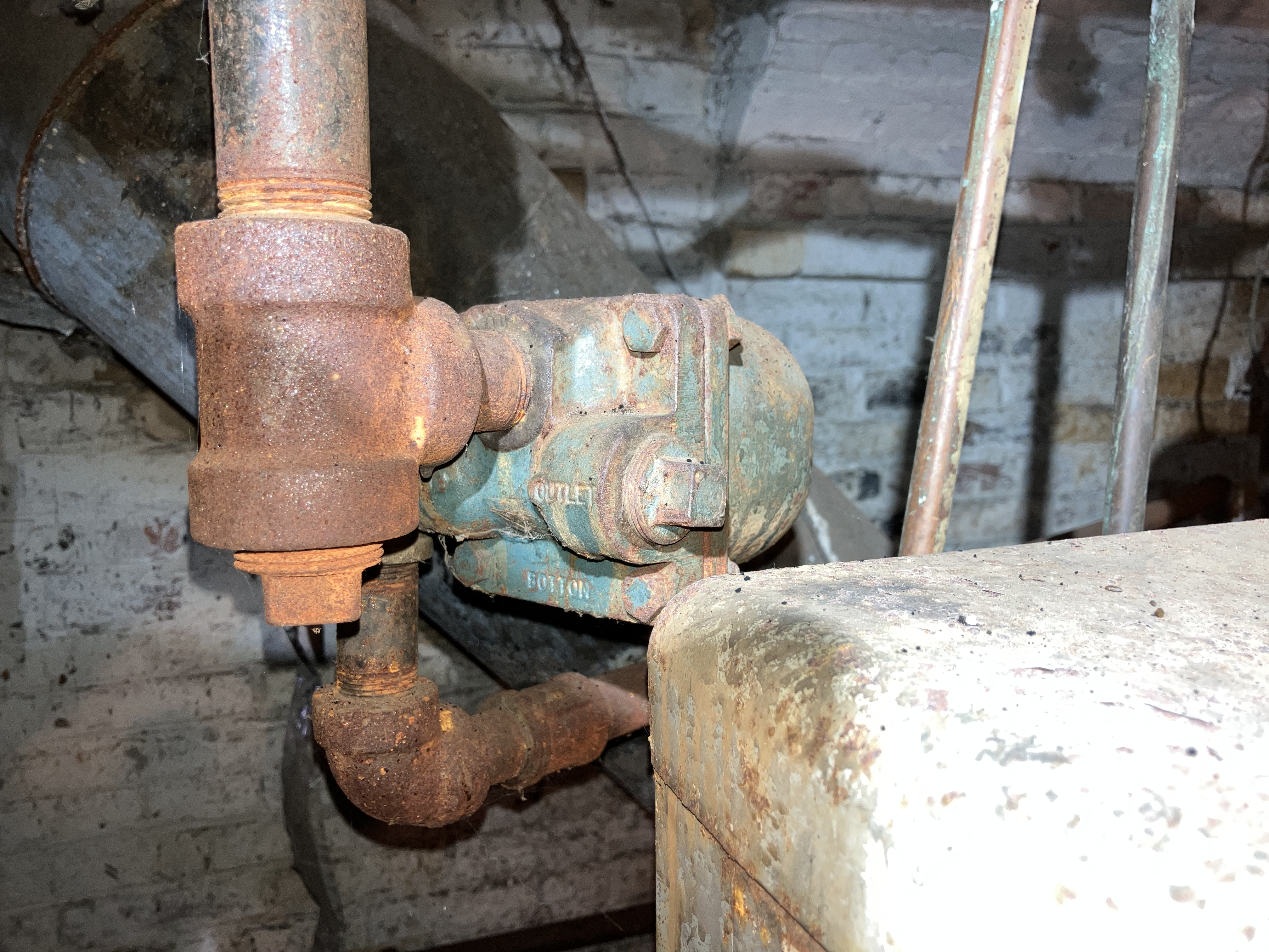

Can someone identify this F&T trap for rebuild parts?
PEvans
Posts: 148
I am thinking I might need to rebuild this one.
I don't see any mfr markings on the body.
Thanks very much!
@EBEBRATT-Ed is correct. But, there was a version of this style trap that could not be rebuilt. The later, better version is still available AFAIK, so you would not need to change any piping.
