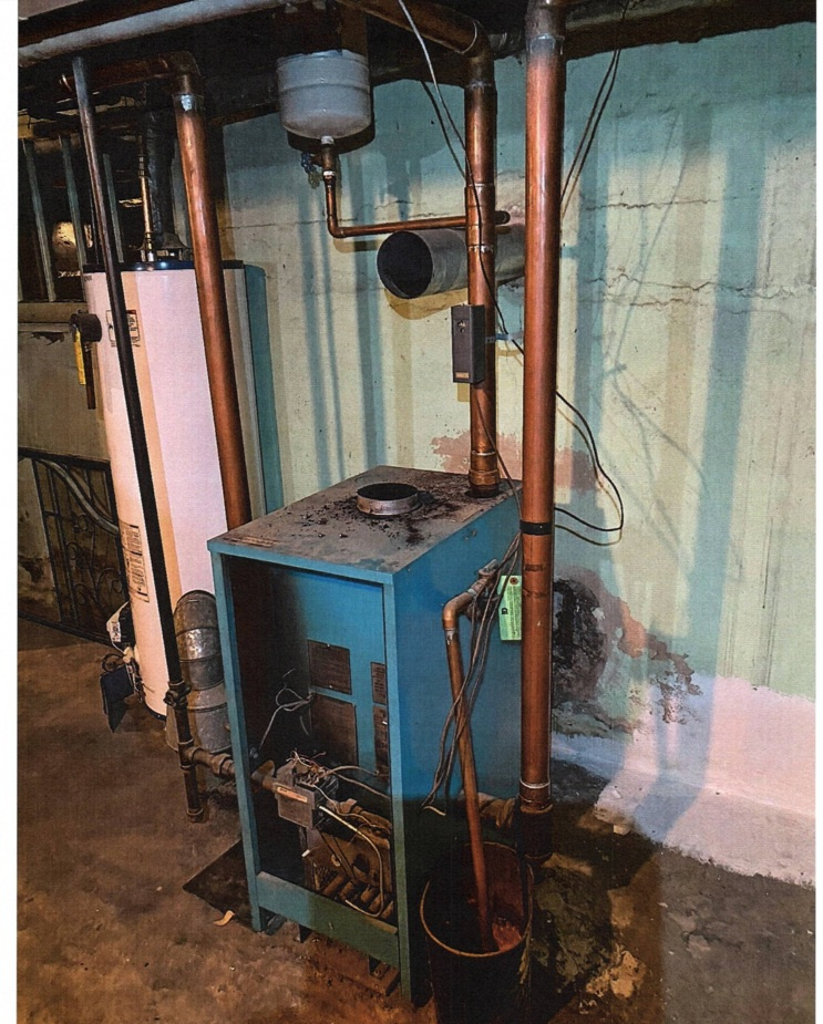

    it is set up for hot water. looks like a gravity system unless there is a circulator somewhere we can't see.
    also looks sooted from lack of return water temp protection.
  • there is no circ pump anywhere, not sure how it would cir hot water?! Why does it look like its set up for hot water but also gravity steam? Sorry Im not crazy familure with steam boiler
    it isn't steam, it is gravity hot water. no circulator, the water moves by changing density as at is heated in the boiler and cooled in the emitters.
    if it is replaced it probably has to be converted to a pumped system and if it is a conventional boiler it needs low water return temp protection.

    Are you a contractor quoting a boiler replacement?
    2014 Weil Mclain EG-40
    there is an aquastat on the outlet and an expansion tank. do you have a picture of a radiator? There is no sight glass or try cocks or pressuretrol on the boiler, right?

  • trying to troubleshoot since it seems to have worked fine as a steam boiler for 2 years without any service
  • ChrisJ
    ChrisJ Posts: 17,763
    I'm going to assume you didn't install this?
    What do the radiators look like?
    even as a steam boiler the new boiler is plumbed very wrong.

    these 2 pictures are not the same boiler,
    are they ?
