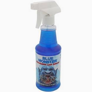

    The smell of gas is surely a concern. Call in the person who did the underground and have them fix it. And if you like, get some of this spray. It sticks nicely to the pipe and fittings. It shows a nice bubble at the leak. The other good idea is what @Mad Dog_2 says above. A soapy solution works too. I have found that the Blue stuff pictured here can find some of the smallest leaks.
