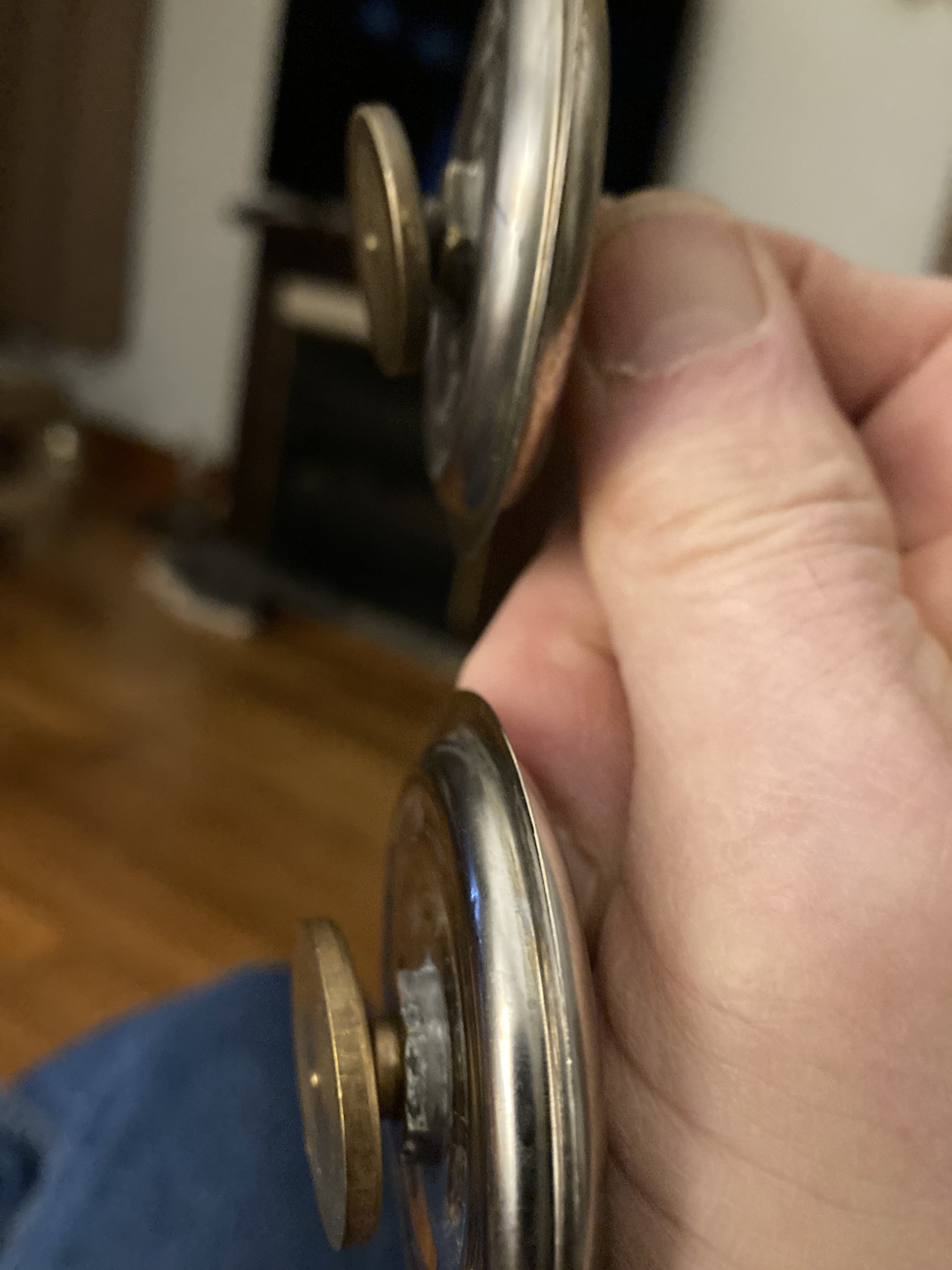

Purchased Big Mouth 2 heating seasons ago and starting leaking, replaced with high temperature O rings which performed flawlessly until this heating season.
Noticed slight sightglass water loss and after much investigative work found Big Mouth whisping steam periodically with a mirror, although it remained closed.
Contacted Barnes and Jones who stated in a properly operated and clean system expect 1-3 seasons, they which sent me a new compression disk (free with no questions asked), 1/2 inch wrench to remove old 13mm to install new) photo shows old/new disk for comparison (bottom is new) new disk is stiffer and appears would seat better due to aligment with O ring.
Reinstalled assembly and after one cycle still seeps a small amount…maybe needs more time
For the record, 3 seasons ago I purchased 1 Gorton 2 with the Big Mouth because I wanted super fast venting…still no issues with Gorton.
Knowing now and spending over $300 on main vents and after 2-3 seasons should expect a faliure, Big Mouth will remain a backup for Gorton which appear to be a superior product for longevity
So why do you think it is presently seeping ? I have not looked at mine lately.
I would think all vents would seep a bit in an oscillating fashion, since you have to replenish the steam in the vent to keep them closed.
Maybe the Gorton #2 with the larger chamber volume makes better use of the vacuum of collapsing steam to draw in more steam.
One Pipe System0 -
You may be correct in your assessment, can only compare one vent behavior to another, I have asked the BJ representative if this is considered normal.
The seepage may have been going on before I just didn’t pay as much attention, I stopped blowing down the LWCO weekly to Bi-weekly now and how I caught it.
That is the draw back on Big Mouths: If your pressure and dimensions aren't perfect, they can GUSH condensate. Great on crossover traps and very large radiators, but Not for every situation, especially as Main Vents. Mad Dog
