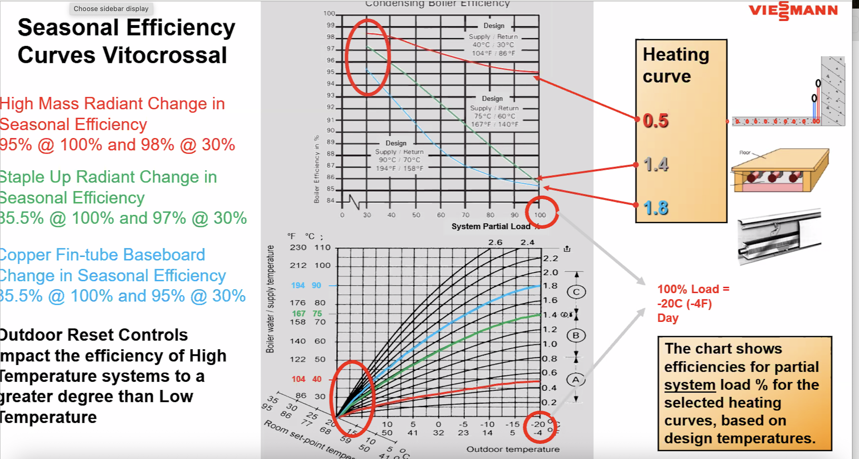

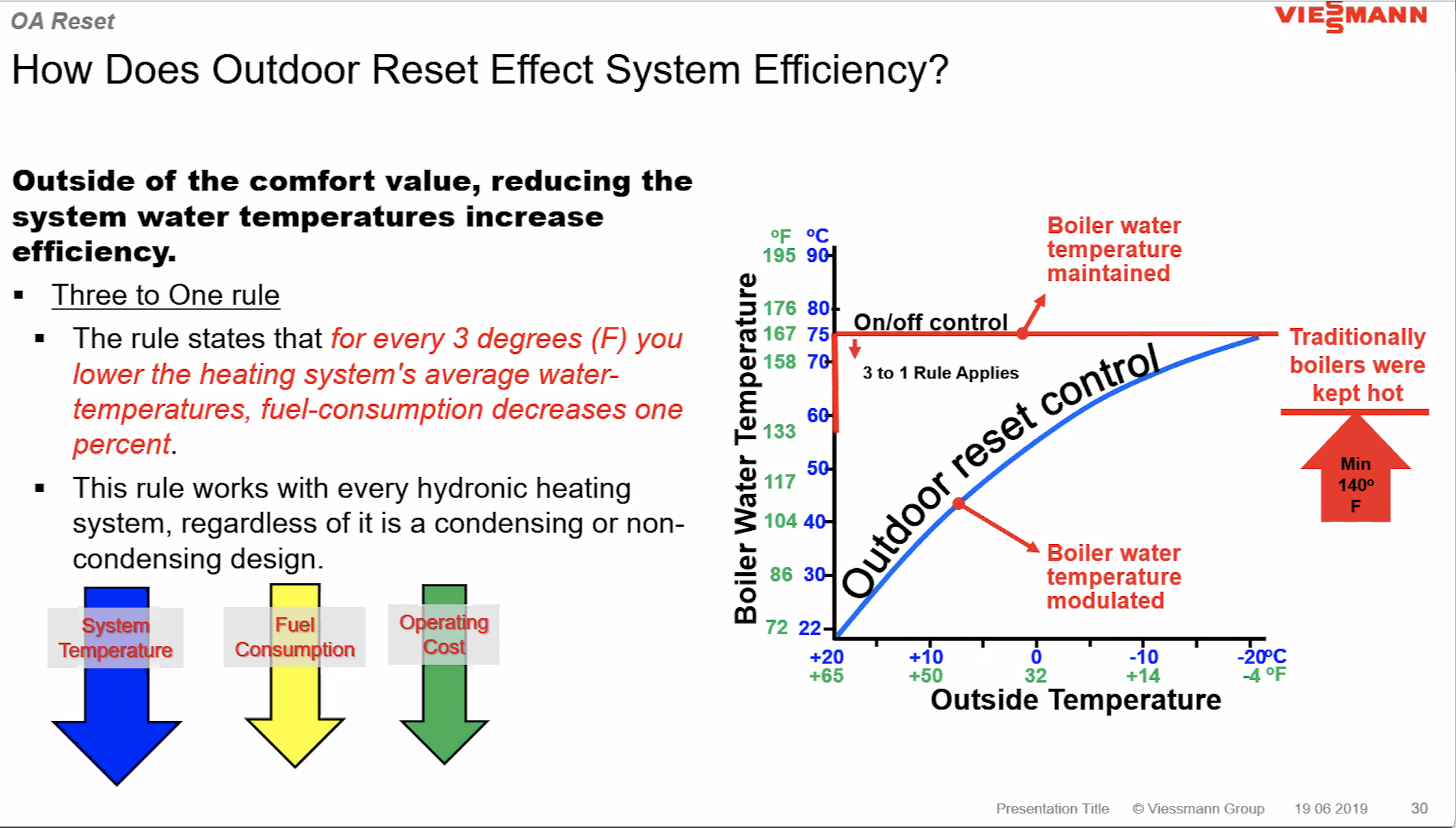

The lower the boiler operating temperature the more efficiently it runs. So comfort and fuel efficiency are what you can chase with the tuning of ODR.
Some training slides from Viessmann.
