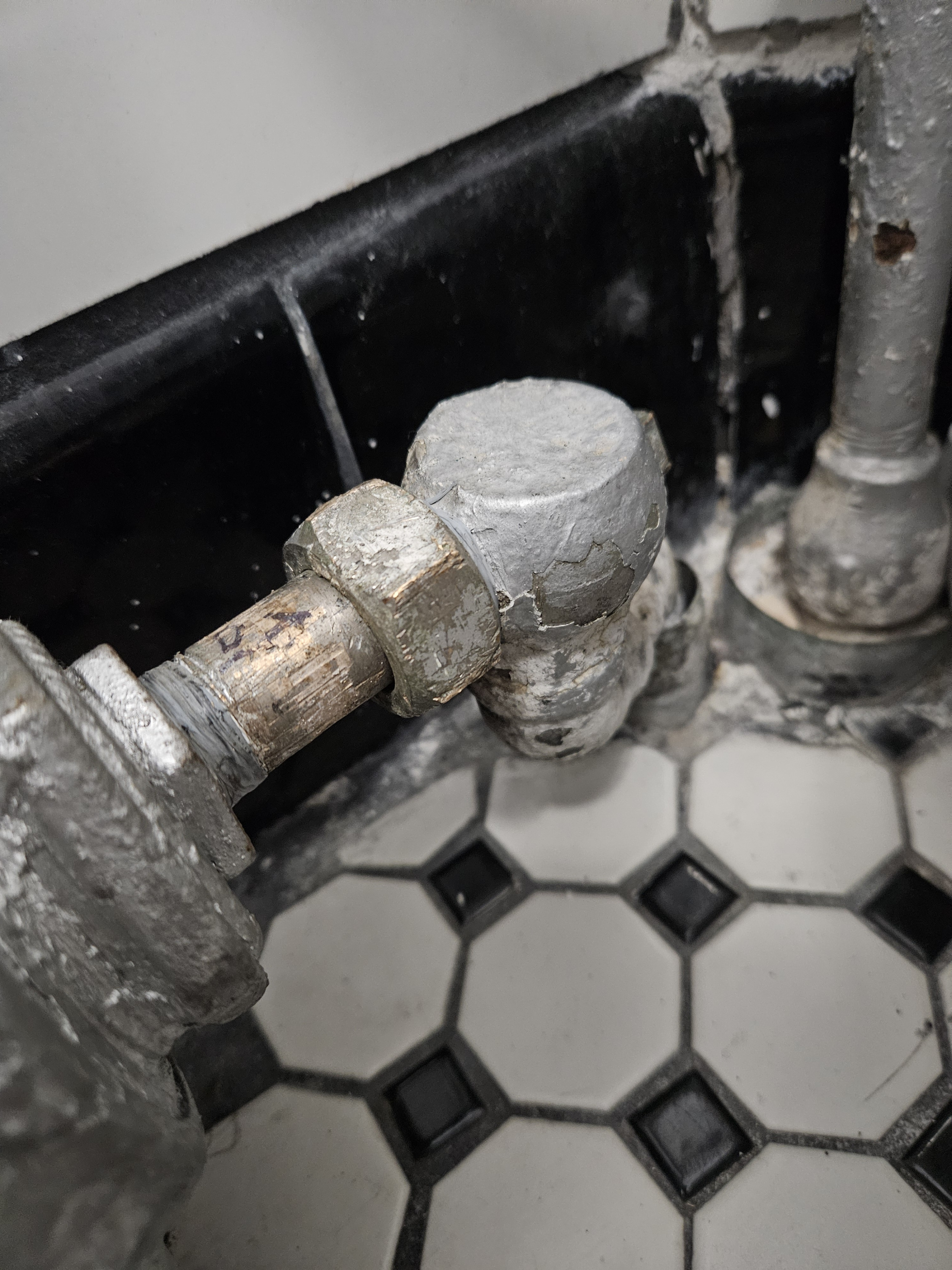

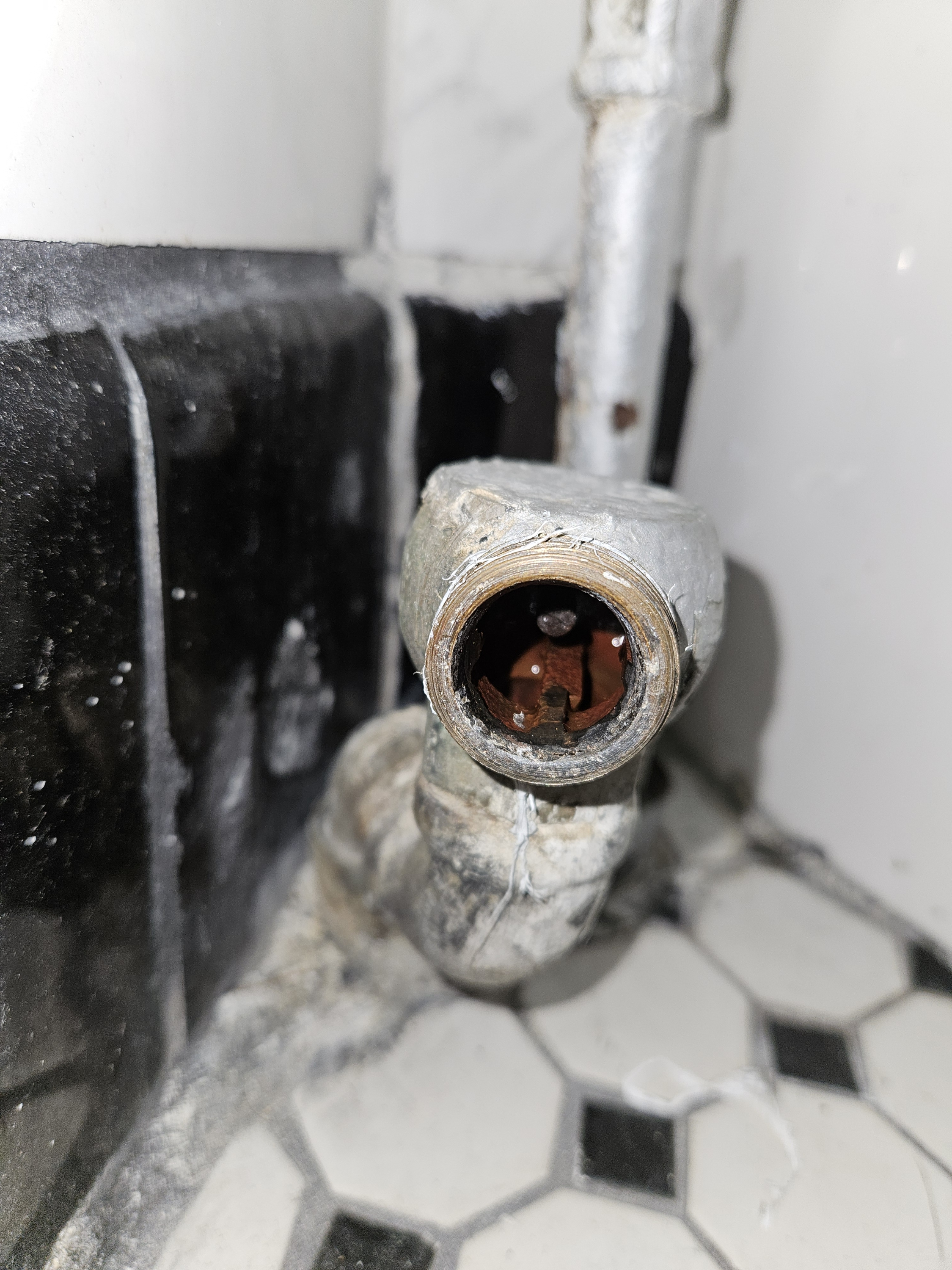

Where can I find a ball for this trap?
rohan_1794
Posts: 22
Your probably out of luck looking for that. This is a vapor system correct? I would put an orifice in the supply valve.
