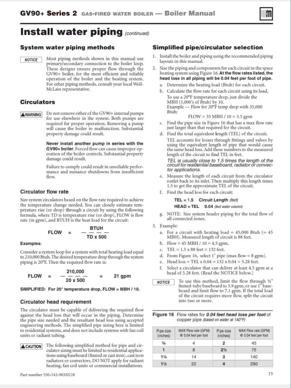

    What's the Economy dial set to?
    Is it piped Primary/Secondary? What circulator is being used on the secondary loop?
    hot_rod Posts: 28,705
    doesn’t that boiler have a built in primary secondary piping? If so you may not have 180 going out to the system just because the boiler reads 180as @HVACNUT eludes to
    Measure the temperature leaving the boiler room to that rad

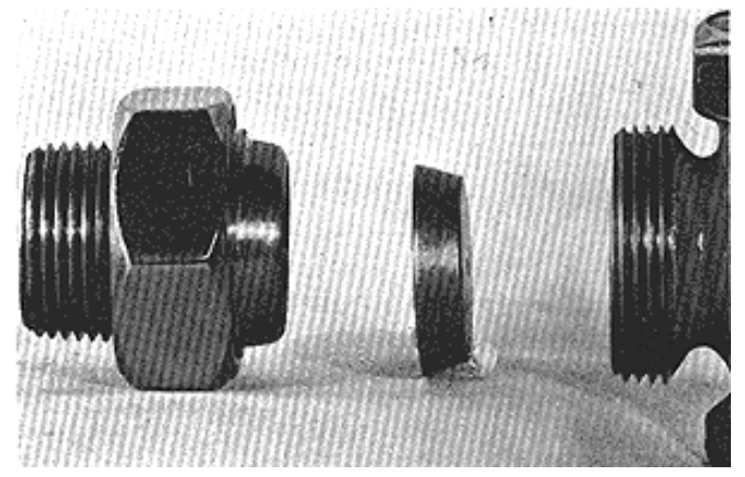

    You may have orifice plates on the top floor radiator valves
    In this article https://www.heatinghelp.com/systems-help-center/gravity-hot-water-heating-q-and-a/ Dan explains that top floor radiators on gravity systems often had orifice plates inserted into the valve connection union:
    Q: So the top floors tend to heat more quickly than the bottom floors in a gravity system?
    A: Yes, and that leads to system imbalance..
    Q: How did the old-timers get around this problem? They sometimes added orifice plates to the top-floor radiator hand valves. Here's what one looks like
    Q: What exactly is an orifice plate?
    A: It's a round piece of metal with a small hole drilled through its center. You could make one yourself out of sheet metal; most of the old-timers made their own.
    Q: How did the orifice plate direct the water?
    A: By increasing the resistance through the radiator it was assigned to. If water found it difficult to enter, say, a top-floor radiator because of the orifice plate, it would go to a radiator on a lower floor instead. In this sense, the orifice plate was similar to the "O-S" and "Monoflo" fitting. The big difference, however, was that instead of directing the water into the radiator it was assigned to, an orifice plate directed the water away from that radiator.
    In another article Dan poses the problem with these orifice plates when converting to a system to use a circulator. Now the circulator pump will force the water thru the shortest circuits which are on the first floor, causing the first floor to overheat and the top floor to get less flow. Now with those orifice plates restricting those radiators, you barely get any heat thru those circuits. His suggestion is to remove the top floor orifice plates and install the orifice plates on the first floor radiators.  With gravity the top floor overheats, with a pumped system the bottom floor overheats, so the orifice plates need to be on the overheating radiators.
