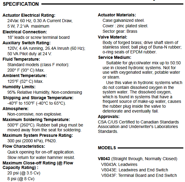

I noticed that the Honeywell residential hydronic zone valve has a limit to the time it can remain energized. To avoid premature failure the valve should not be energized for more than 30 minutes. There is no information on minimum rest time. Are there residential zone valves with no time limit to energizing time? I have a zone that needs a nearly continuous call for heat when outdoor temperature falls below 30F. I have to put up with a chilly master bedroom to make sure the valve cycles in winter cold weather.

    StanKatz Posts: 20
    I read this in a Honeywell spec sheet some 15 years ago. They no longer give the 30 minute maximum energized, but if you read the last paragraph of the following Honeywell spec sheet they specifically warn of shortened life if continuosly energized:
    https://www.honeywellmanual.com/pdf/ea156978-8edb-4793-8014-c6a1af3e0932.pdf
    109A_5 Posts: 4,759
    So what do you use to cycle the valve every 30 minutes ? I see no 'Duty Cycle' data in the specifications.

    hot_rod Posts: 28,705
    i suppose any design or below design day could have the zone valve powered open 24/7
    Also jobs where rooms are under radiated would see the same condition. That includes radiant systems with actuators on the manifold, or a manifold with a zone valve.
    Data from the weather service shows many heating climates at design temperature conditions 10% or so of the year?
    We still sell a fair amount on NO zone valves to commercial projects. They do have a shorter life cycle however.
    Caleffi testing shows as many a 5000 cycles per year in a Wisconsin test with a NC zone valve
    Components are designed with 100,000 cycles life, so 20 years in a severe climate
