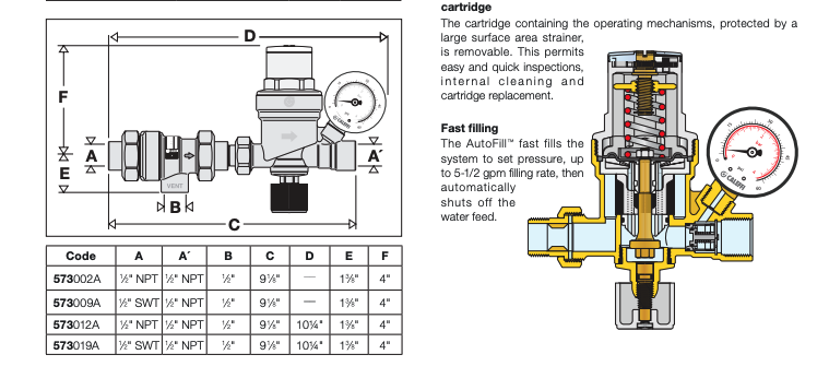

    The Caleffi 573 does have a spring check on the outlet, right below the gauge in this pic, basically the same check you find in most BFD. So with a combo fill/ BFD 573 on the left, you get 3 check valves and vent to atmosphere.
    There are markets in the world where that check in the fill valve is considered a BFD.

  • Thanks. I was looking at the non-combo Caleffi 553 with gauge. My assumption was that anything downstream of the BFD didn't have to be lead-free.
    I have a Legend S-459 which isn't lead-free (planned to return in favor of a Matco-Norca BFP-90-1/2LF or equivalent that was).
    My theory, and likely overthinking, is that the BFD is connected to potable water and might want to be lead-free as my "bridge." Then anything after doesn't have to be.
    But, similar to an outdoor spigot, I don't see how water makes it back across as you mention, especially since I'm now looking at three check valves.

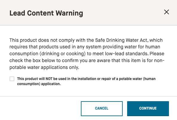

    I see some online suppliers now have a disclaimer if you but leaded brass valves and parts.

    At days end it takes a fairly specific water condition to allow lead to leach out, Flint, MI for example. Most water piping and valves develop a "patina" inside within days that could prevent lead for leaching out.
    But the genie is out of the bottle now, so…

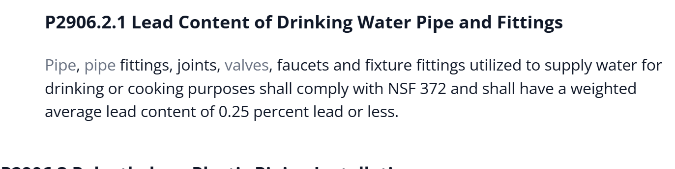

    if i am reading the michigan residential code right, only things supplying drinking and cooking water need to be low lead so the boiler feed does not need to be low lead
    @mattmia i doubt any inspector will let that fly. They want anything in the potable water to be lead free.
    That would mean you don't need lead free in a bathroom or outside faucet or the dishwasher, washing machine etc.?
    exactly. none of woodford's stuff is low lead.
