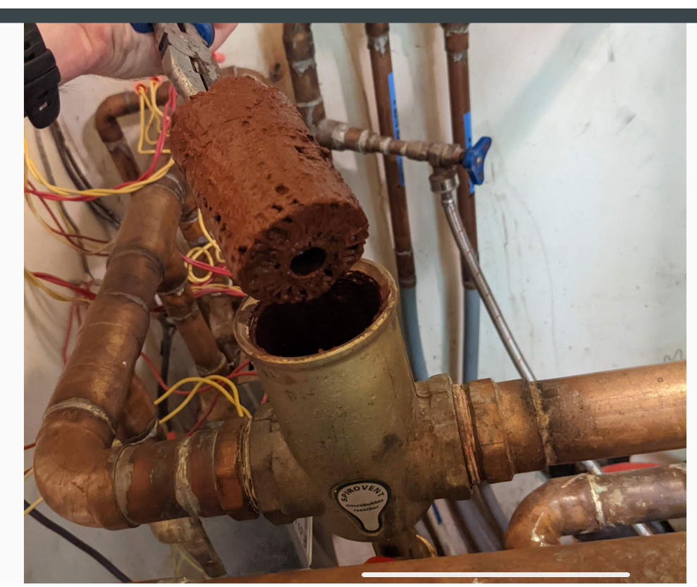

Are there any Y strainers in the system?

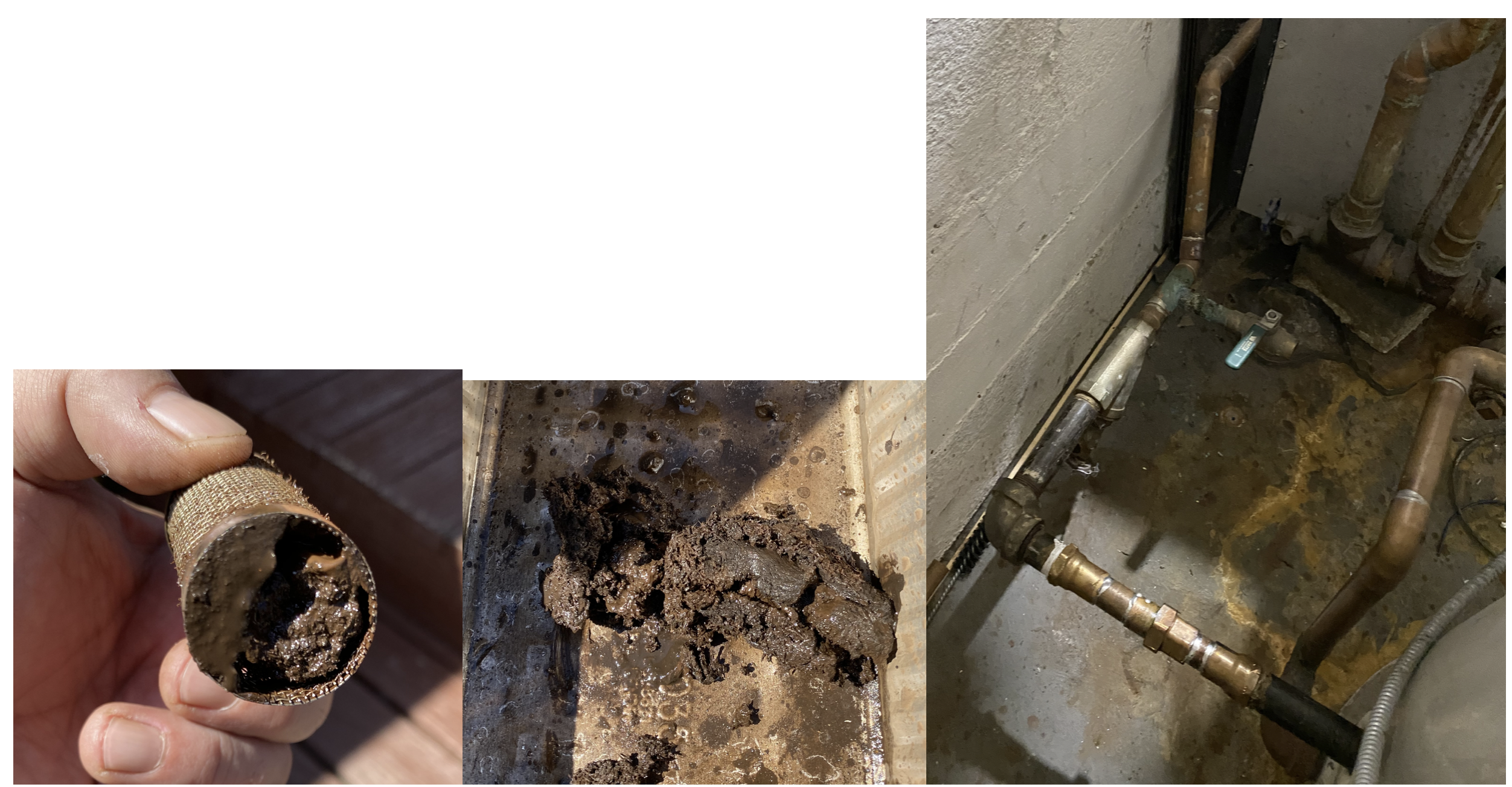

We have also seen air purgers sludge to the point of not allowing adequate flow.
