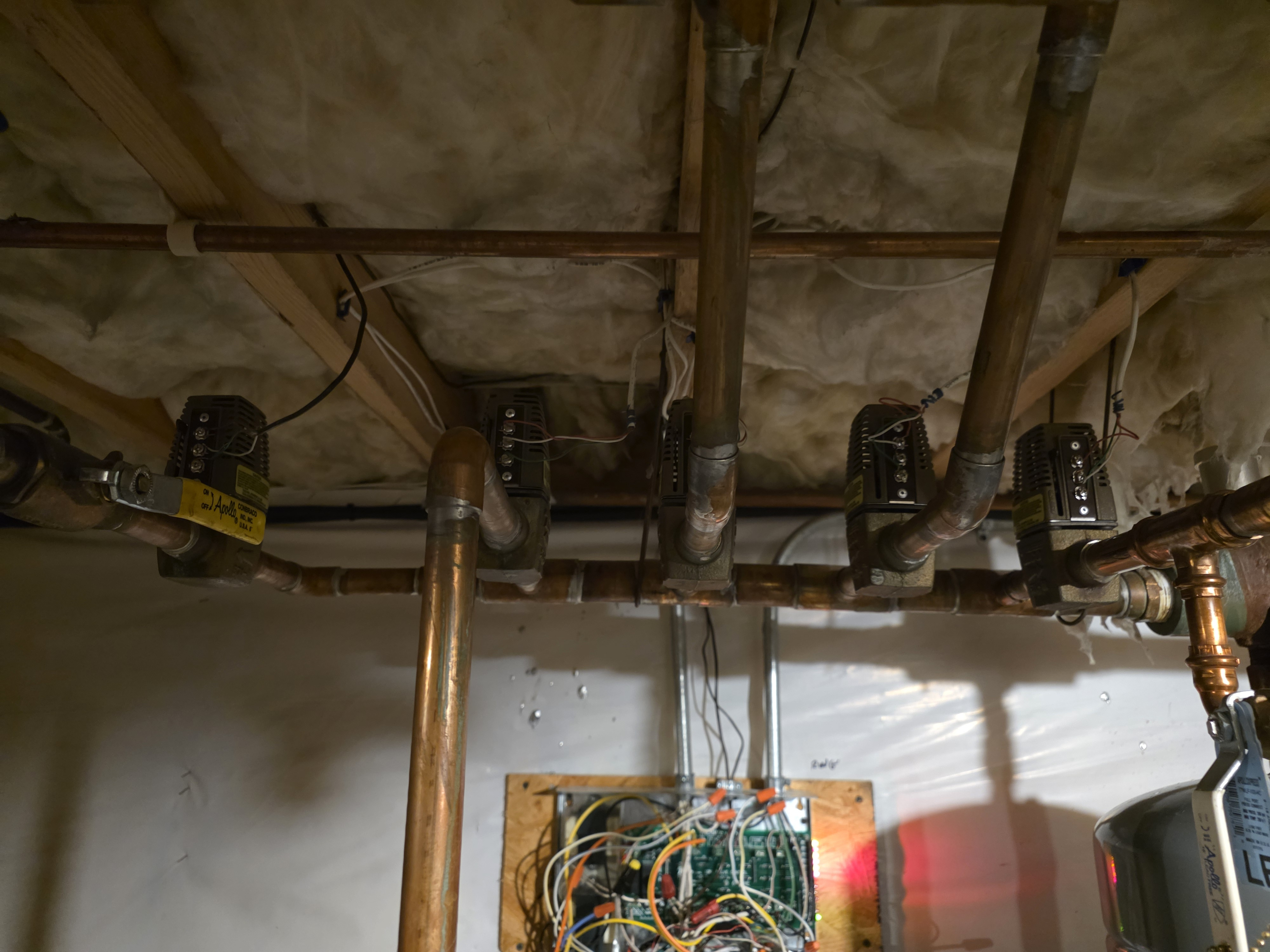

1 of 5 zones not getting hot. Taco zone valve head replaced but no difference.
I have a Burnham Revolution boiler with 5 zones (4 rooms and 1 hot water). There are 2 circulation pumps (1 in the boiler and 1 just outside the boiler in the supply). It also uses a taco valve control and there are 5 taco zone valves (1 for each zone).
4 of the 5 zones get very hot (touching the pipe from the taco zone valve for a second is scalding). However, the main upstairs zone valve pipe gets pretty hot but not scalding. Because it's upstairs and needs high pressure for the water to make it up, the upstairs baseboard heater never actually gets hot. For a contrast, the master bedroom is its own and does get hot despite also being upstairs.
I've replaced the main upstairs taco valve head but that didn't make any difference. I've also manually opened the valve but no difference either. I'm beginning to think there might be something wrong with the zone valve.
Any thing else I can try to single out the issue? Thanks

    The number one reason for lack of heat in a zone is air in the pipes/rads. Air will stop water circulation. Find the bleeder(s) on the radiators for the zone that isn't heating and open them slightly, one at a time, with something underneath to catch any drips. You may or may not be able to get all the air out that way. If you can't, you'll need some more advance air purging that the pros here can help you with.

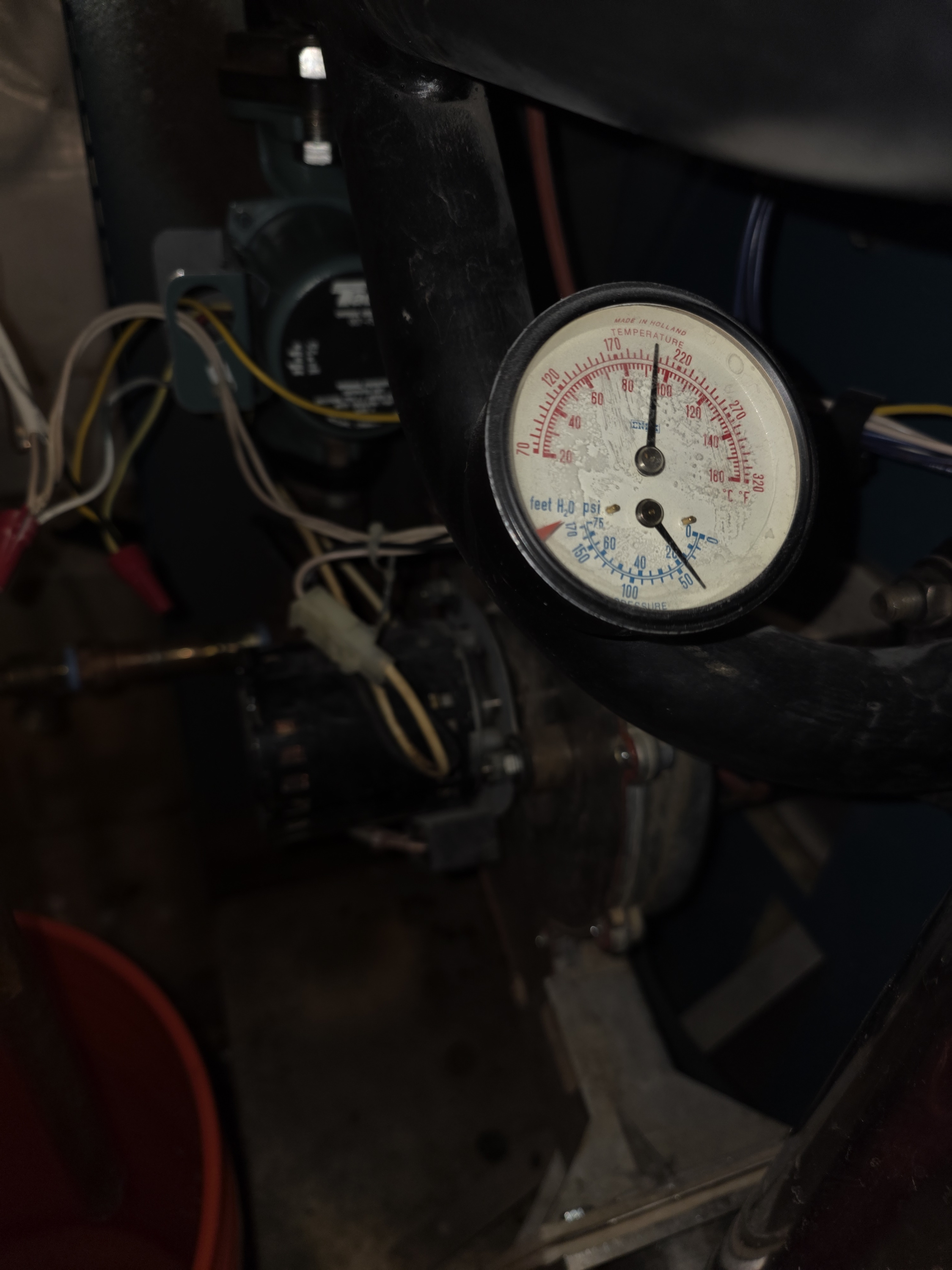

    Meanwhile, check the water pressure gauge on your boiler and report what it says. 12 psi or so is typical for a 2-story house. Lower pressure than that can allow air to leak into the system, resulting in circulation problems. So if your pressure is too low, that's something else that will need to be adjusted.
    hot_rod Posts: 28,708
    Which Taco valve do you have? Most zone valves allow you to push them open manually. That would rule out a bad ZV.
    If you push it open while other zones are heating, it should flow and get hot quickly at the valve.
    If not an air lock or frozen pipe are possibilities.

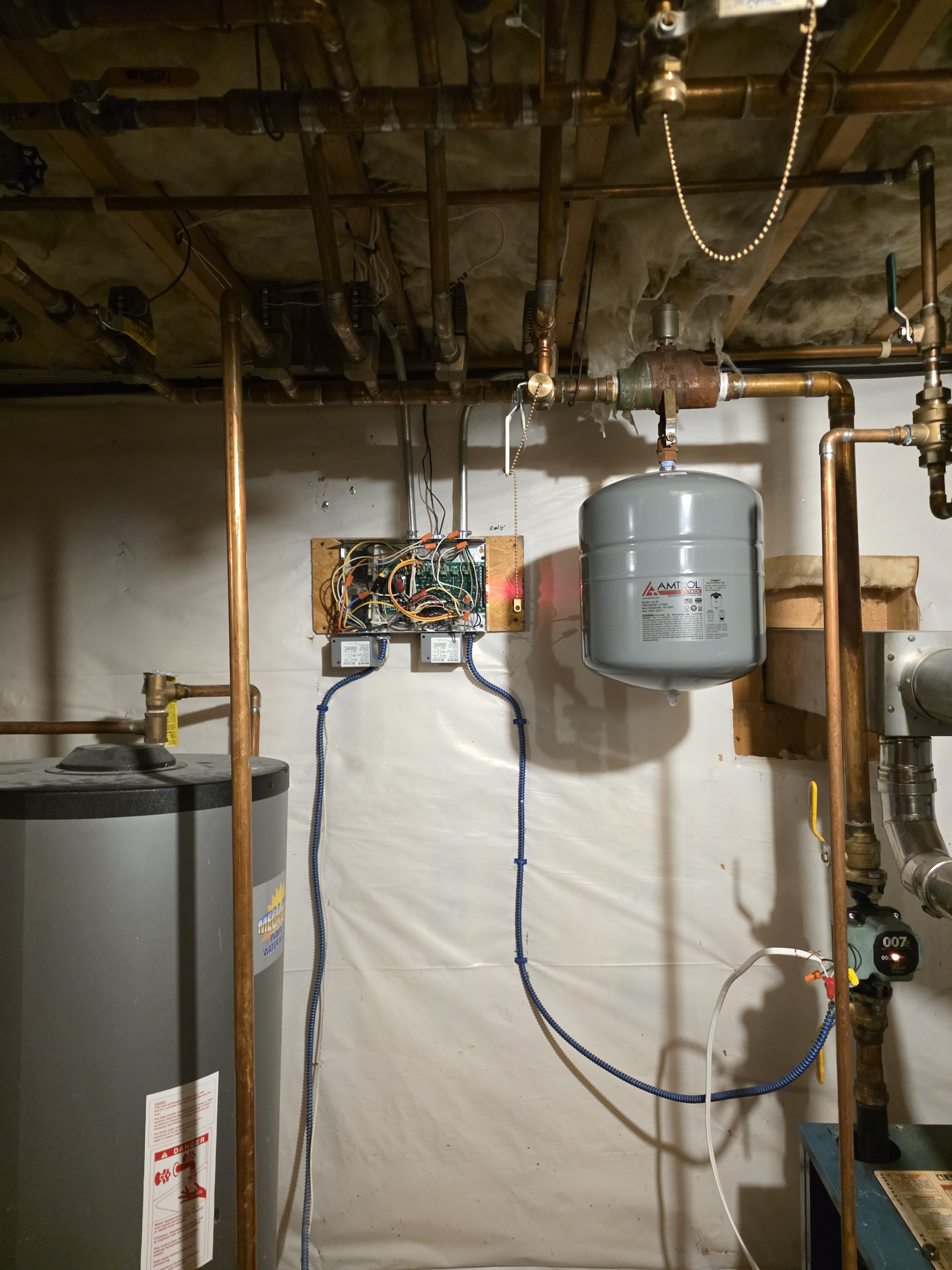

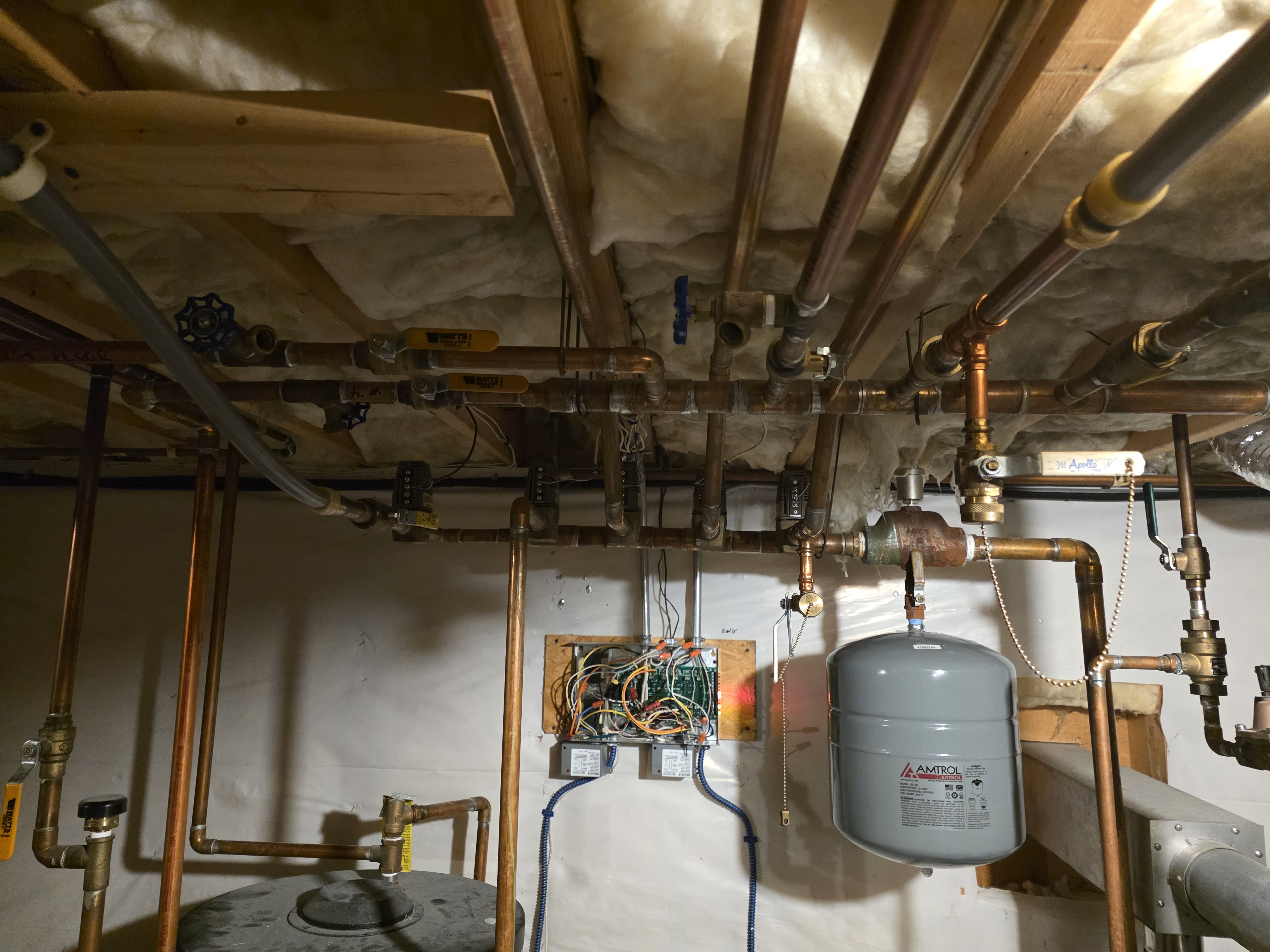

    You might not be able to bleed air at the radiators/emitters. If that is the case you will have to bleed that zone somewhere near the boiler. Pictures will help us help you accomplish that if you're willing.
  • I have the TACO 555-050RP. I already opened it up manually and it didn't get as hot as the other zones. I also had it as the only zone on and it still didn't get as hot as the other zones. I have bled that zone a few times recently (most recently about 3 weeks ago for about 40 minutes) so very much doubt it's an air issue. But even if it was an air lock, won't the supply pipe from the zone valve still be expected to get very hot? It's weird that that's the only pipe that doesn't get super hot when they all seem very connected.

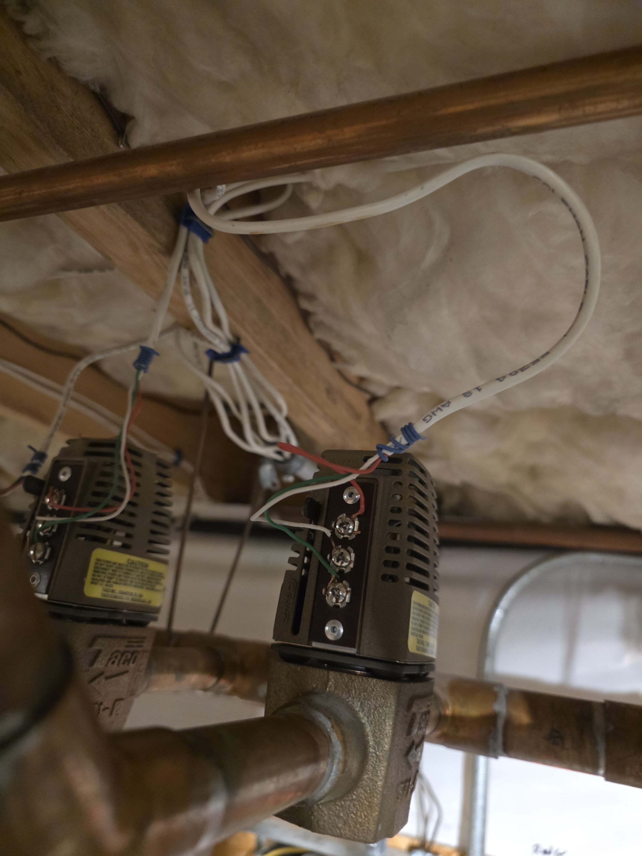

  • Here are some pictures. It's the pipes leading out the valve Im checking to get for the temperature and all of them except the one for upstairs scald my hand once I touch it.

    It looks like you have enough water pressure in the system.

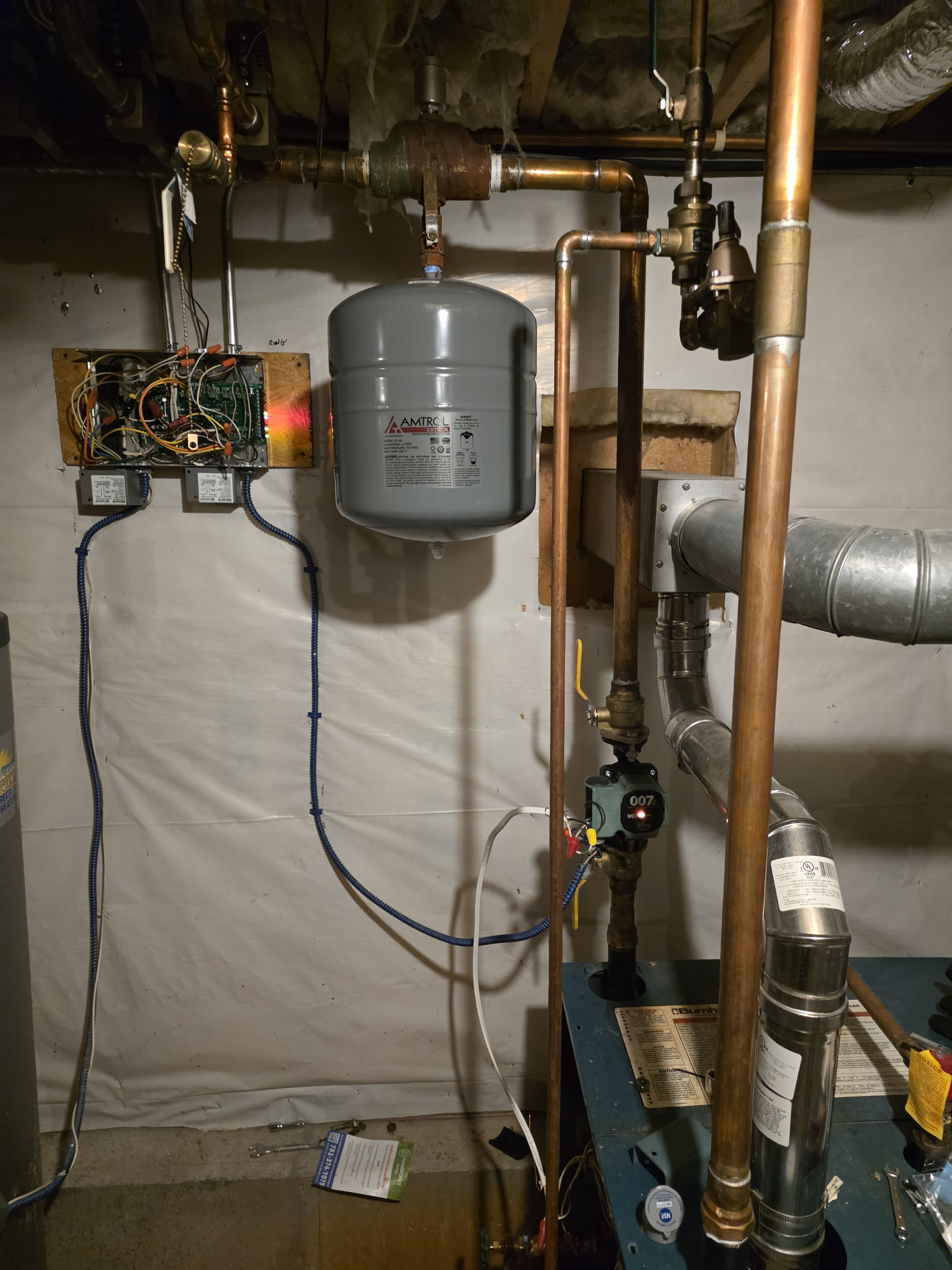

    Do you have purge stations and air elimination at the boiler? Take a few pics standing farther away so we can see what you have.
  • I do have purge statioins and air elimination at the boiler. When I said I bled the system, that's what I was referring to. My radiators don't have a way to bleed them. I use the service valves to bleed the system. I have replaced the circulator pumps since then so maybe air was introduced as was suggested. I'll purge again.

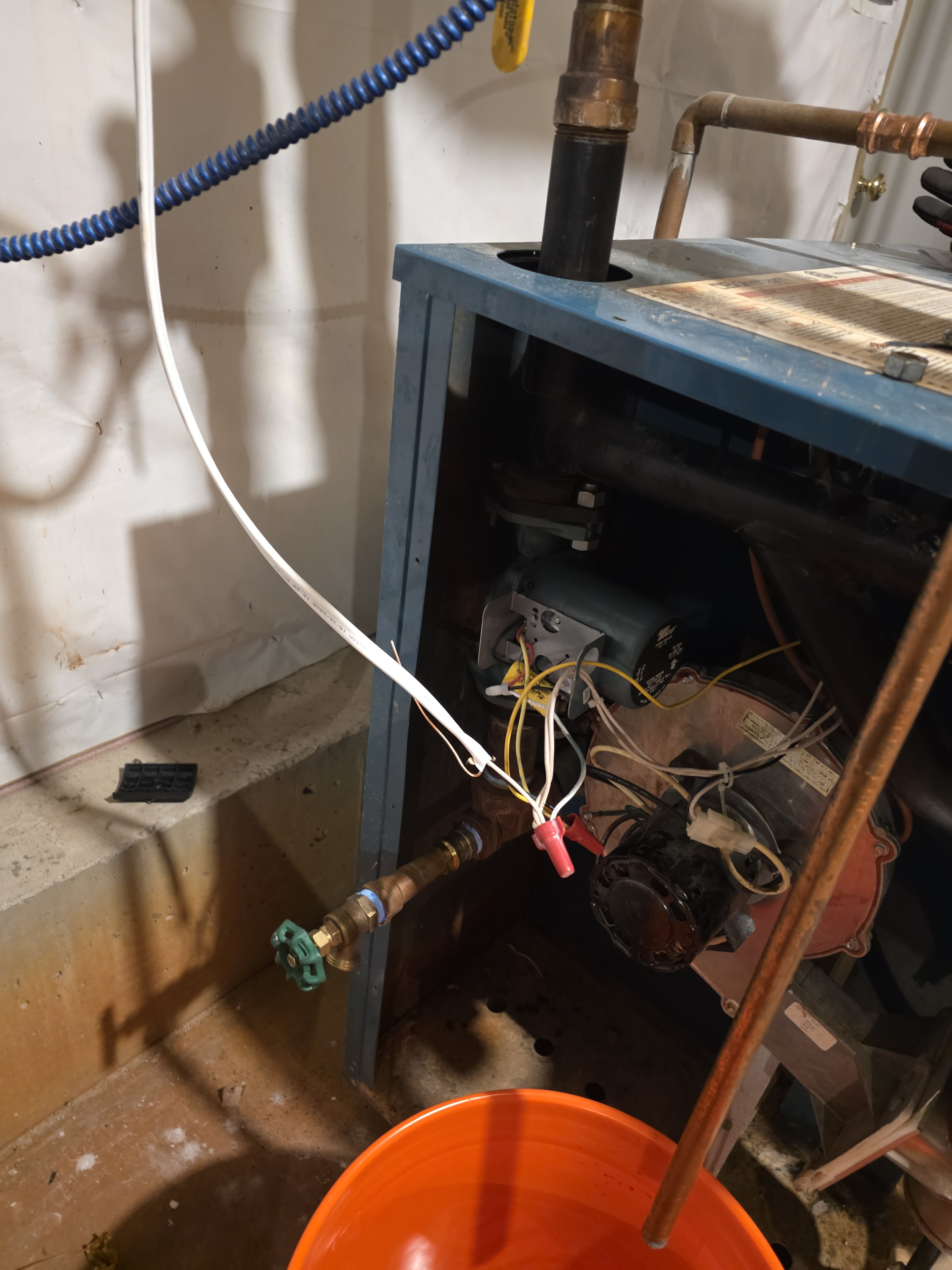

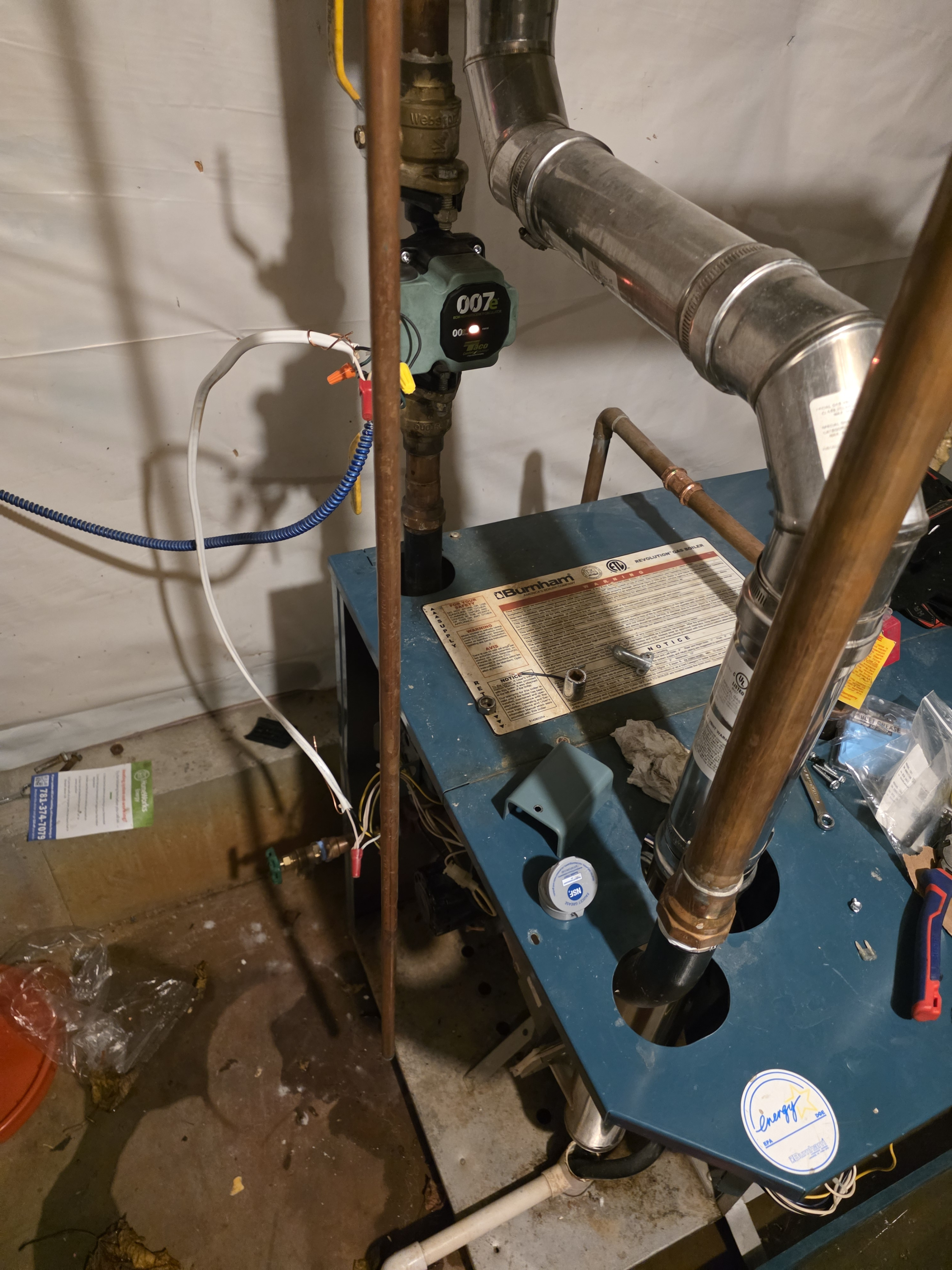

    This is what I did. Sorry, I called it bleeding but I guess that's considered purging.
    I have pics of the system in this thread. I purged using the return side of each zone. I saw another thread that also suggested using the supply side. Can try that if worth it.
    Some more pics of the system. Please ignore the hardwiring. The mixing board needs to be replaced so have hardwired the circulator pump for now.
  • Yeah, just started purging the upstairs zone again and there's a ton of air (water barely coming out actually , mainly air) and the water is very dirty. Must have introduced a lot of air when I changed the circulator pumps. Going to purge all zones now.
    If it has worked in the past, a good purge, zone by zone should get it heating. Check to see the brass air vent above the boiler is working by pressing down the tire stem valve at the top. You should get a shot of air followed by water.
    Plenty of room to upgrade the system on some warm day. A better air purger, pump to expansion tank switch, clean up some wiring at the pump and relay box. Odd to see those extra relays on the relay box?
  • Purging did the trick. Now the house is warming up very nicely and upstairs gets warm. Thanks guys!
