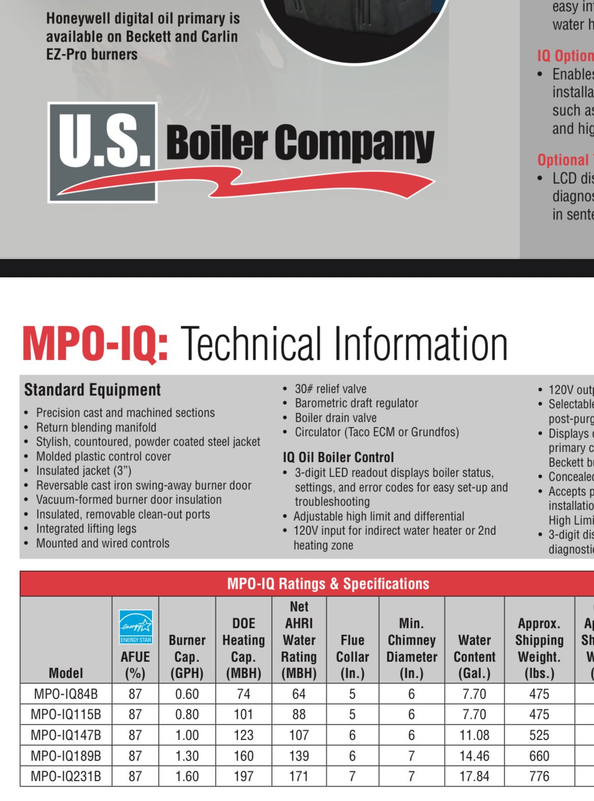

  • @hot_rod oil can be found in 60?
    hot_rod Posts: 28,705
    keep in mind also, 80% of the heating season you are below design conditions. So even if you got it sized perfectly for design day, most of the season it is sill oversized and will cycle accordingly
    Steamhead suggested this MPO is about the smallest, so the 64k output gets closest
