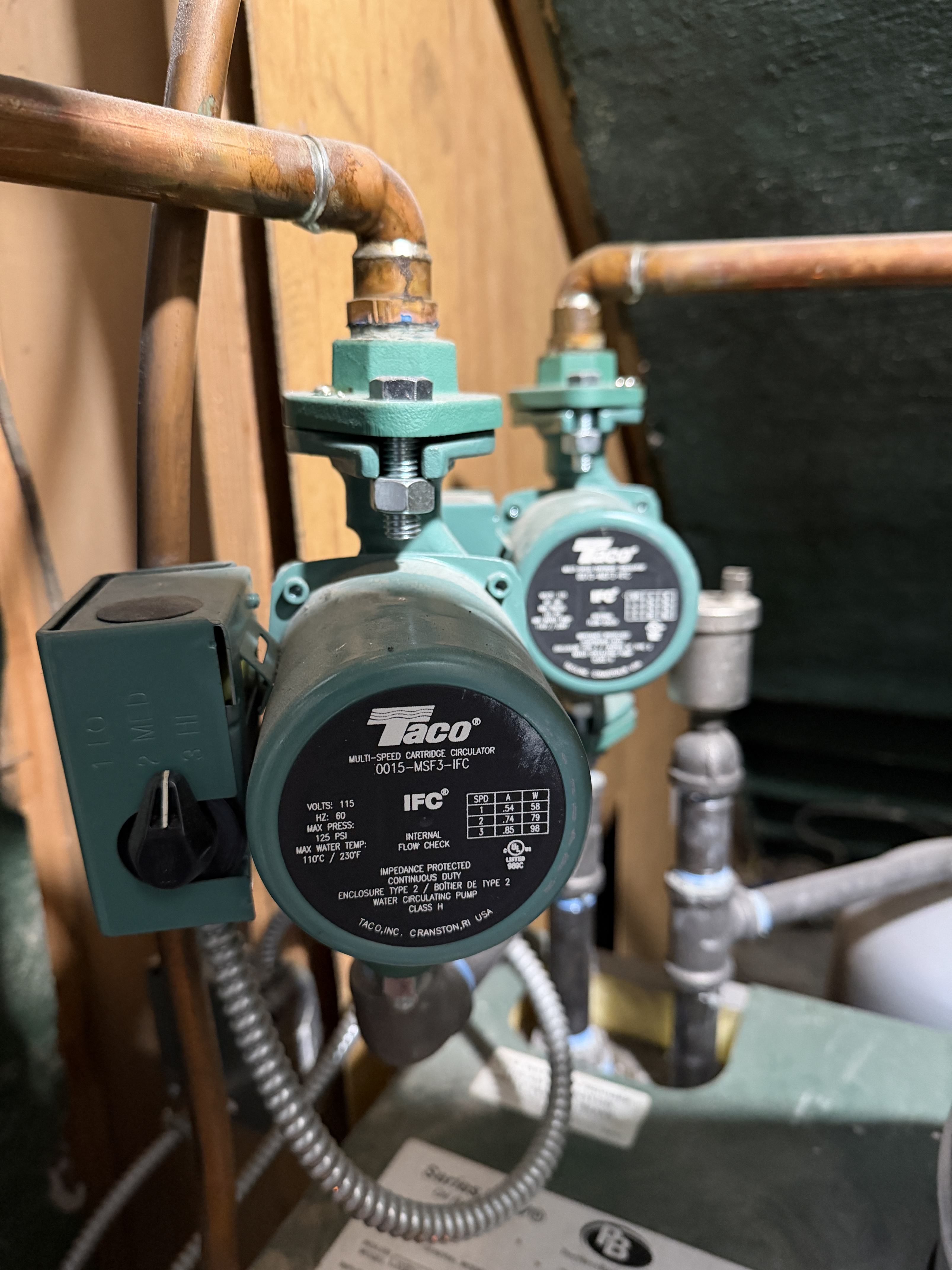

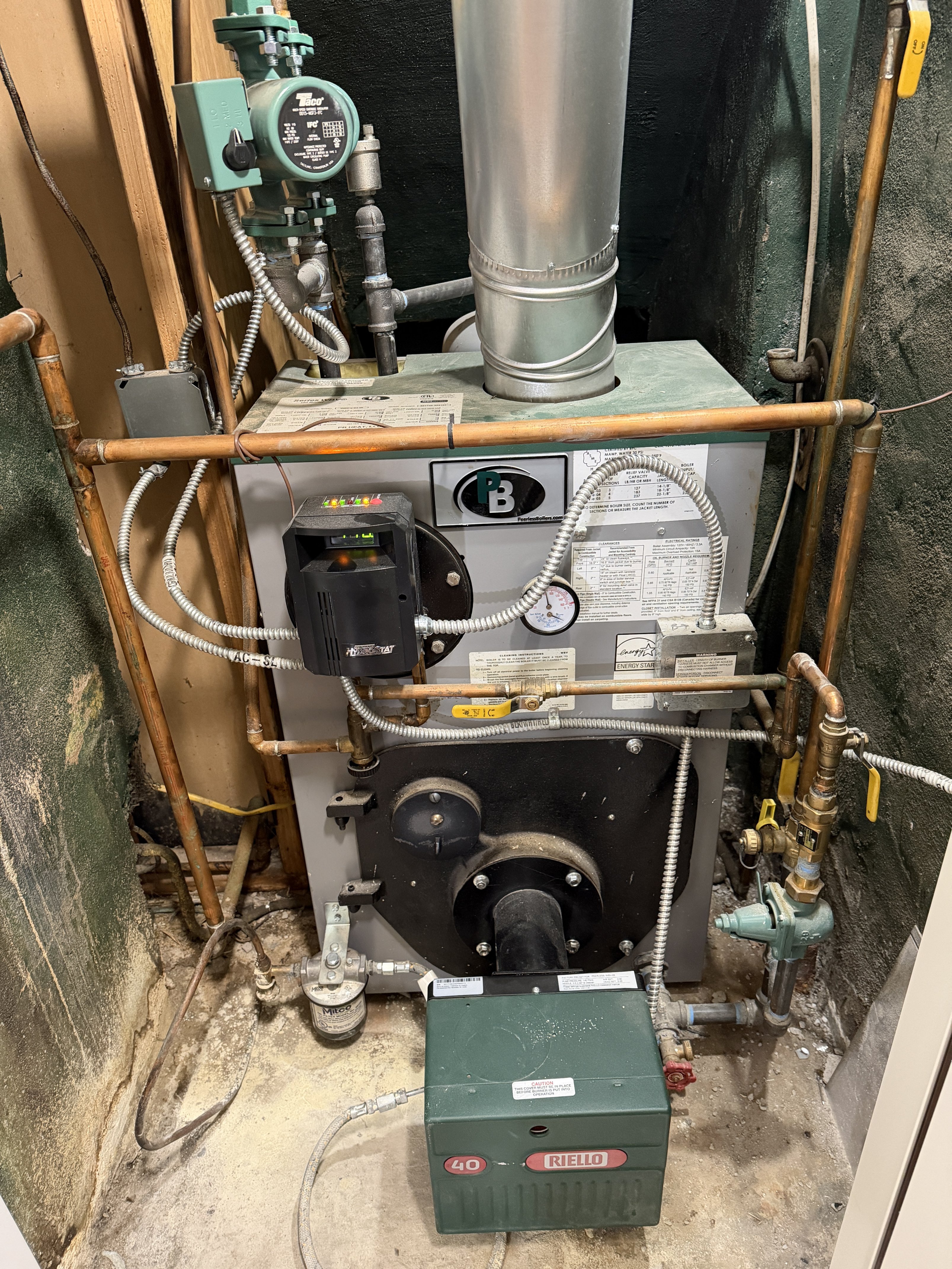

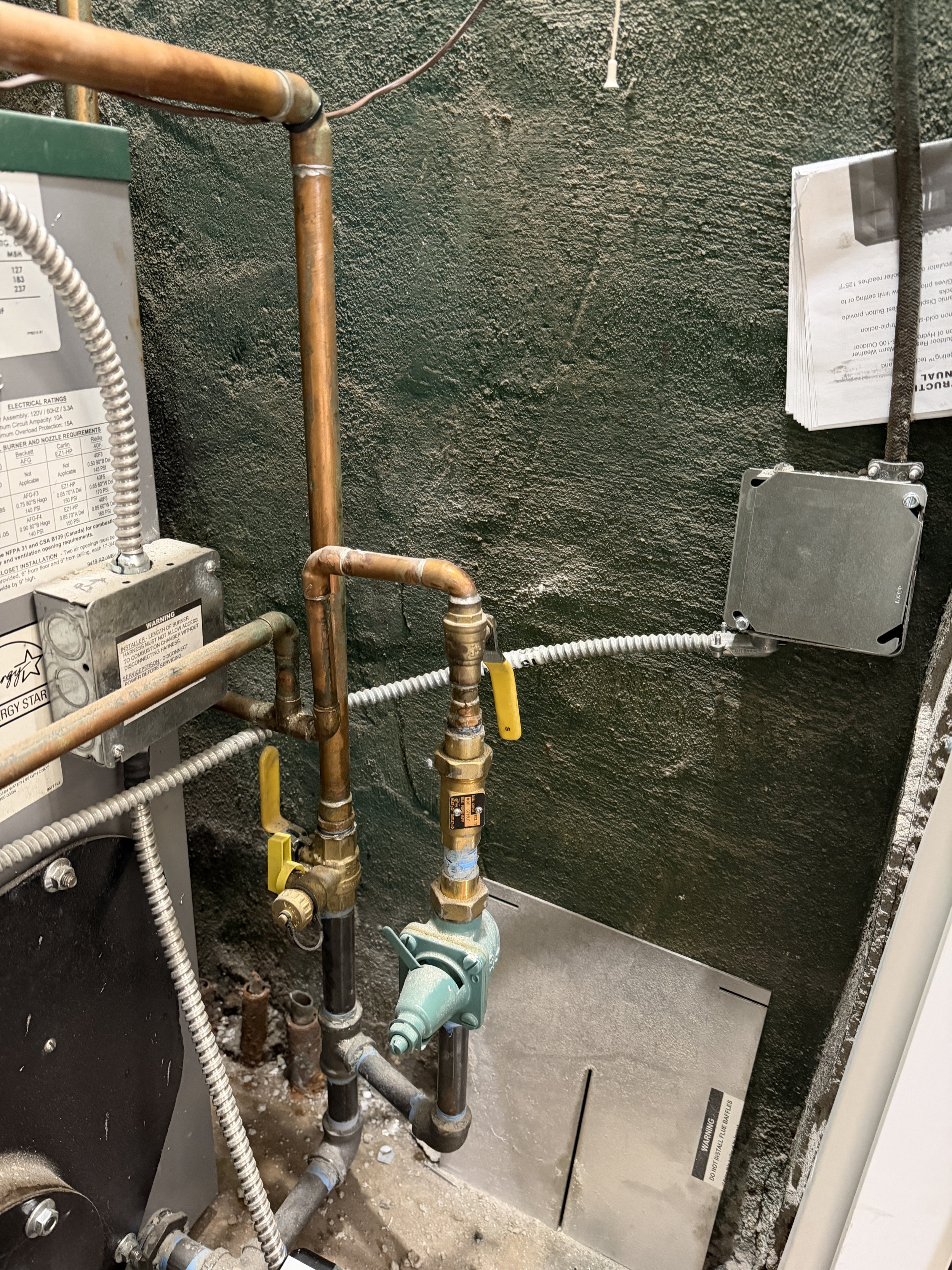

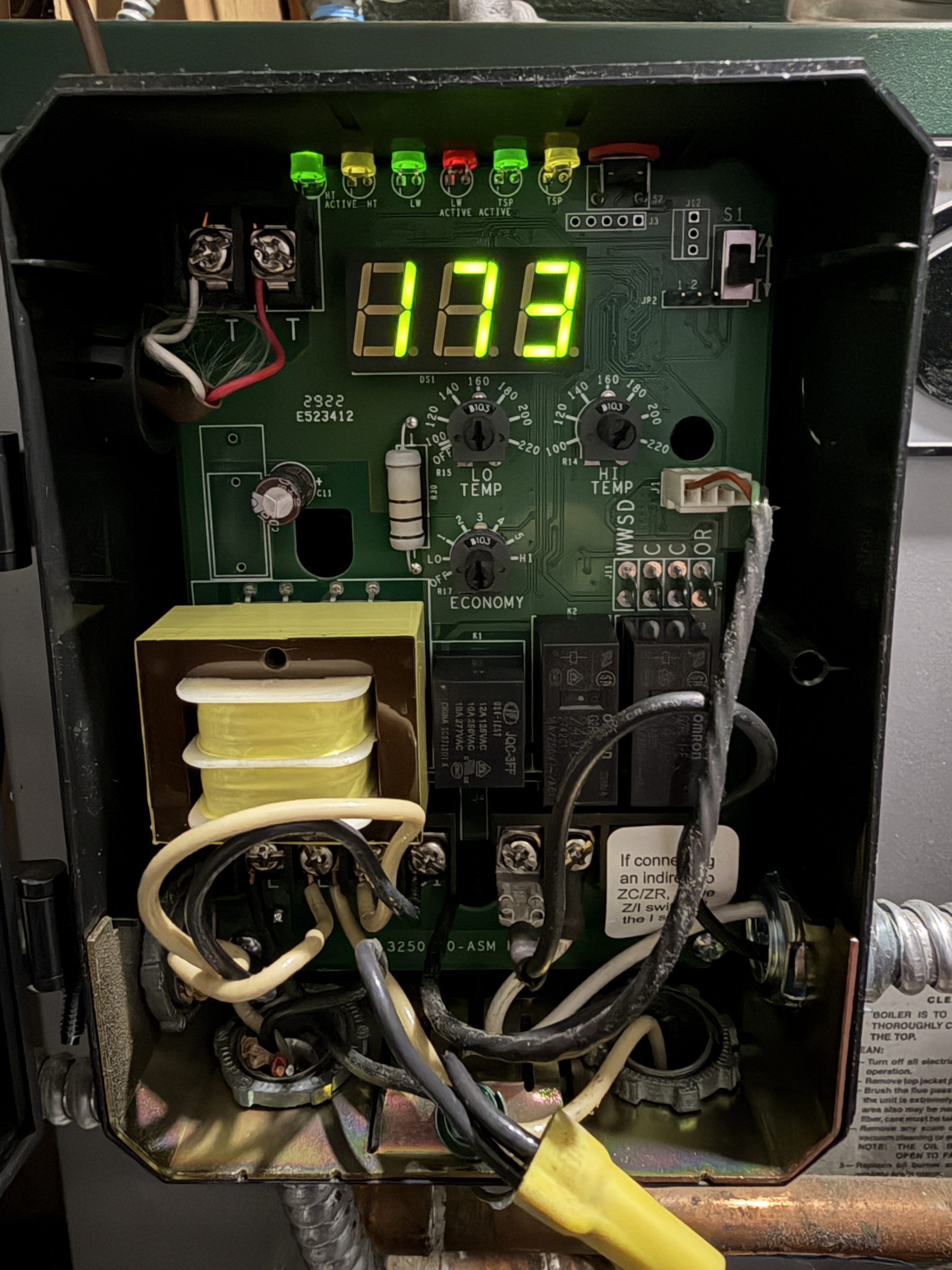

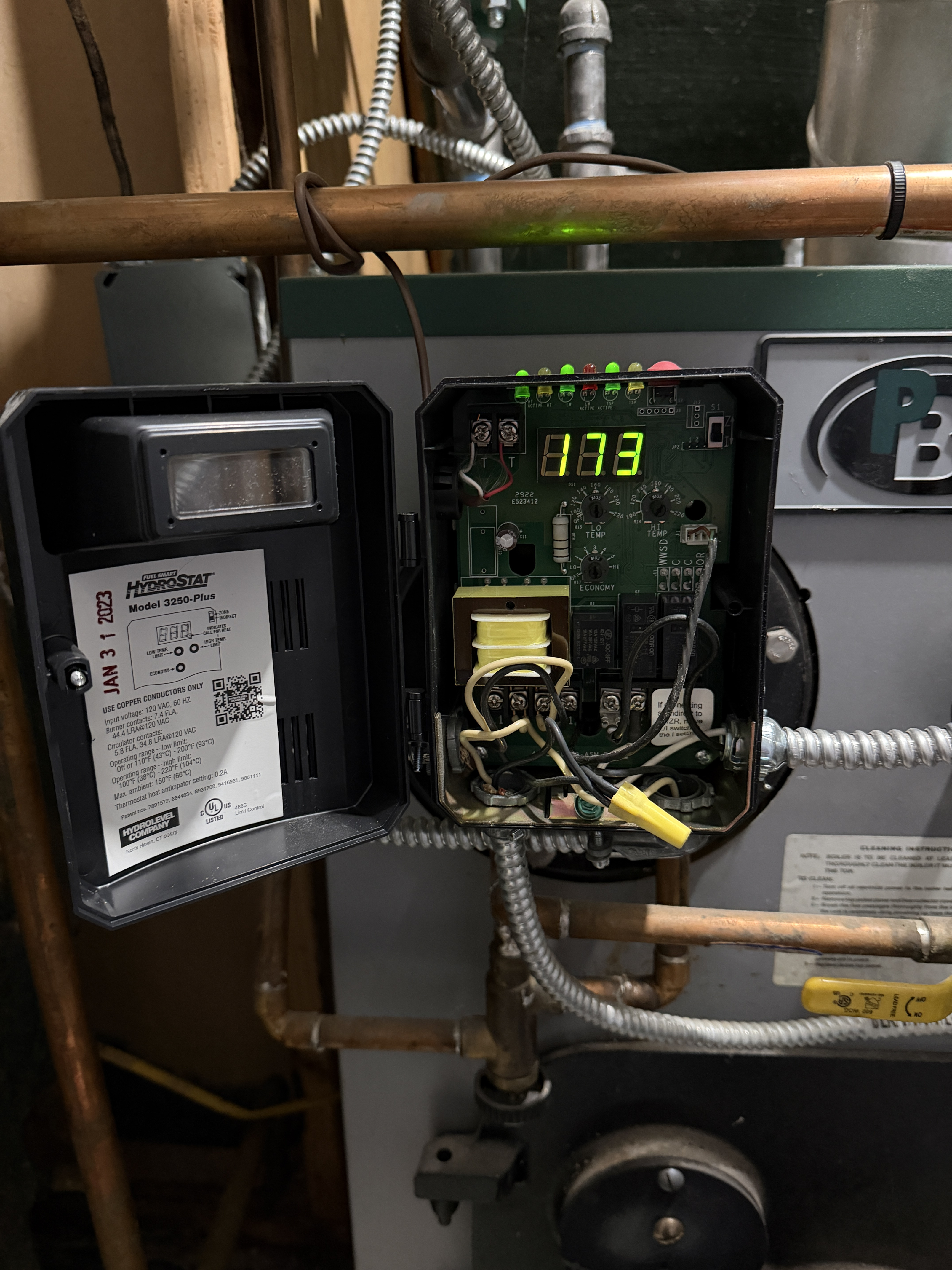

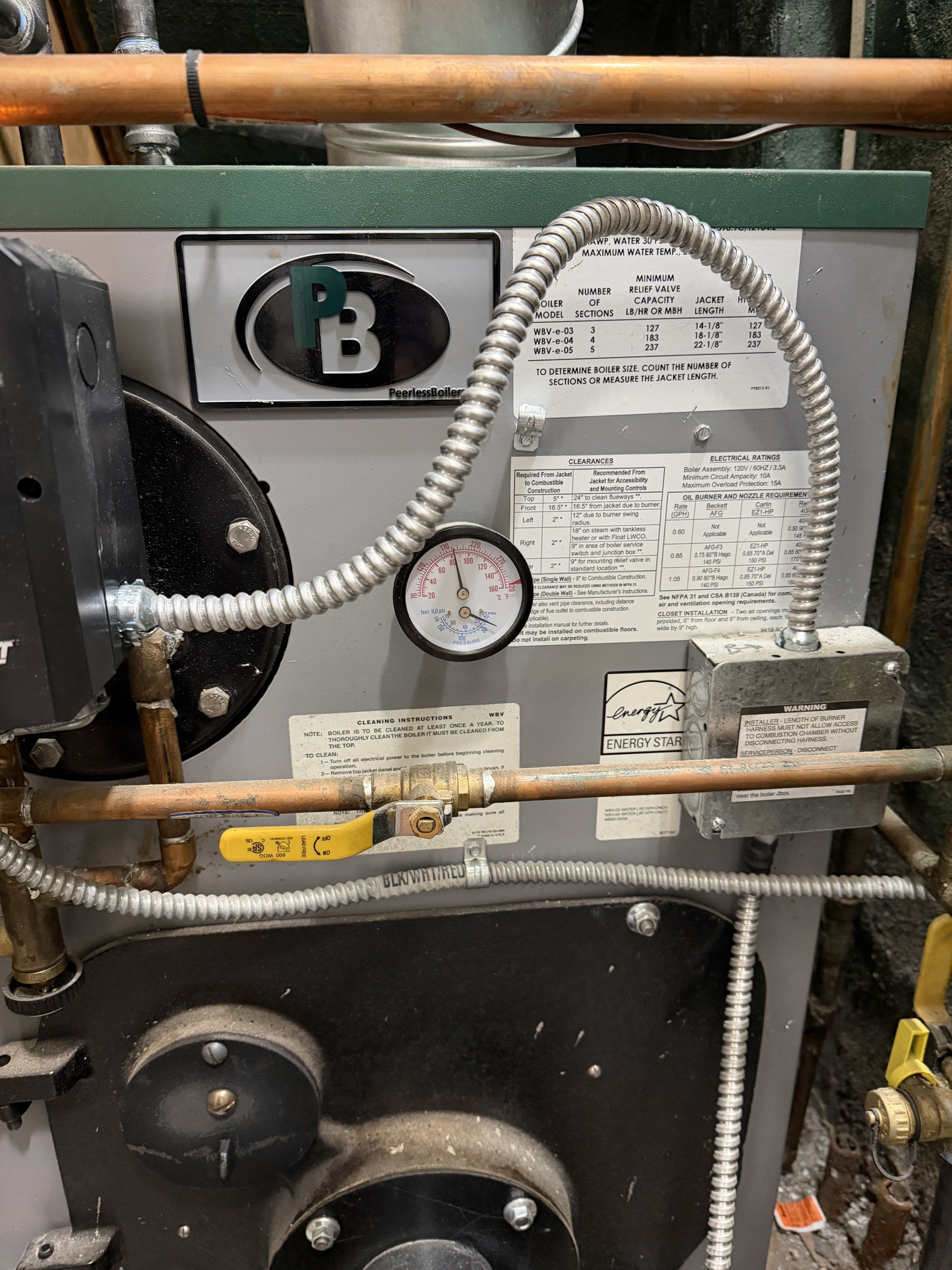

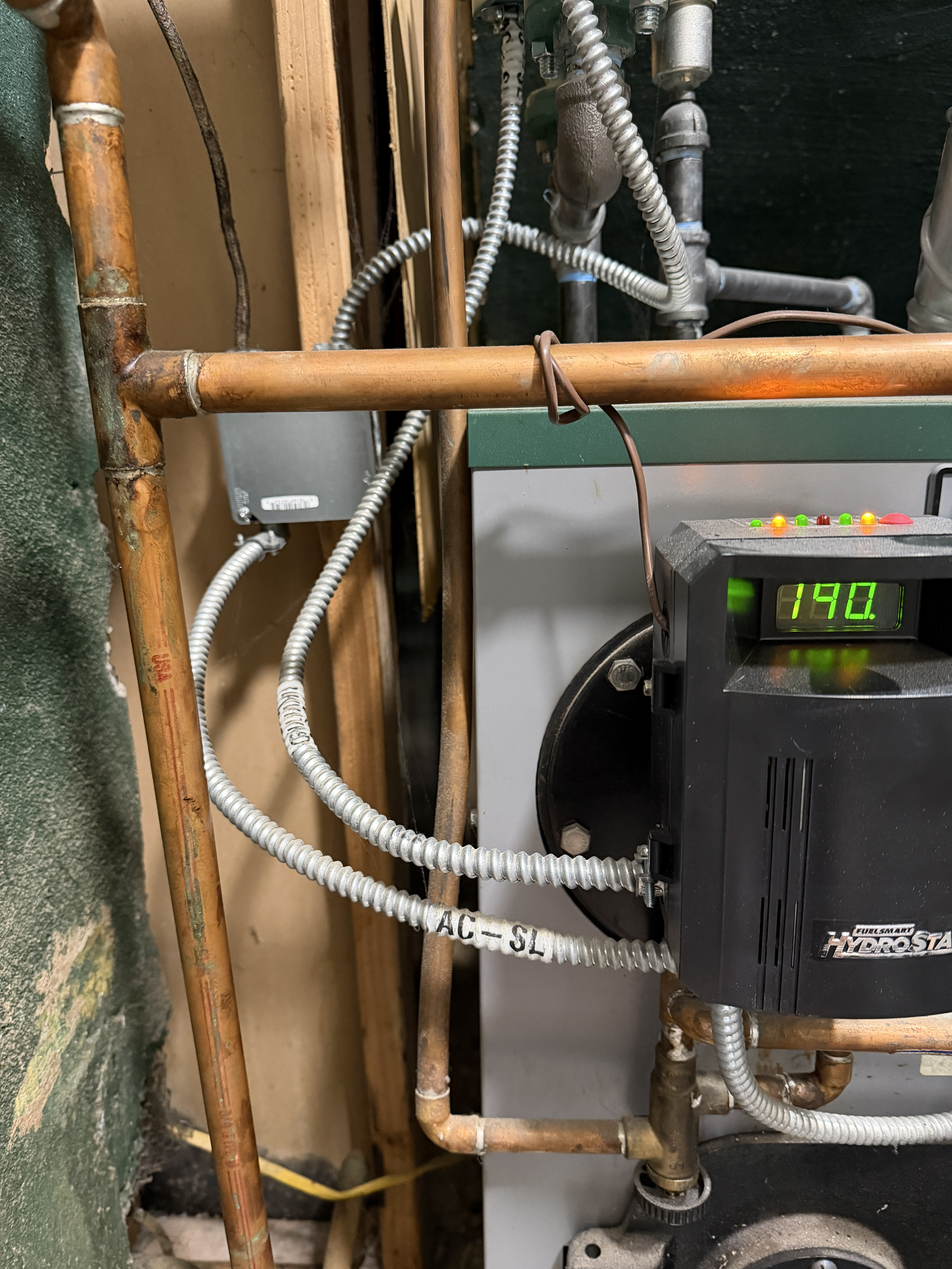

Hi. Like similar threads on here, I’m trying to add a C wire to my 2-wire system. I don’t have a 24v transformer anywhere to tap off of, and while I have no problem adding a transformer to give myself a C wire I’ve read a few threads that mention needing a relay. So my question is, do I need a relay? If so, my only question would be, which wires are used for the load? I have added diagram and pictures for reference. Thanks

    The relay helps everything play nicely together. The relay coil is the load the thermostat sees, the relay contacts control the Hydrostat 3250.

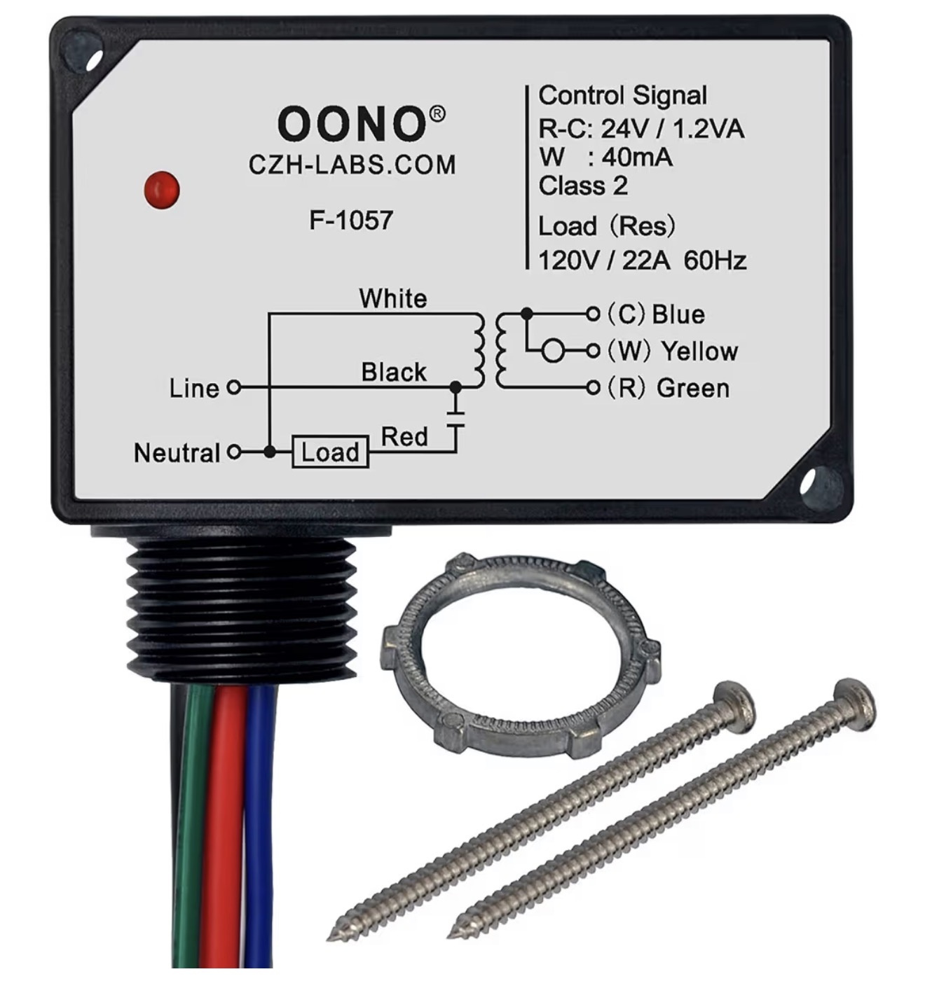

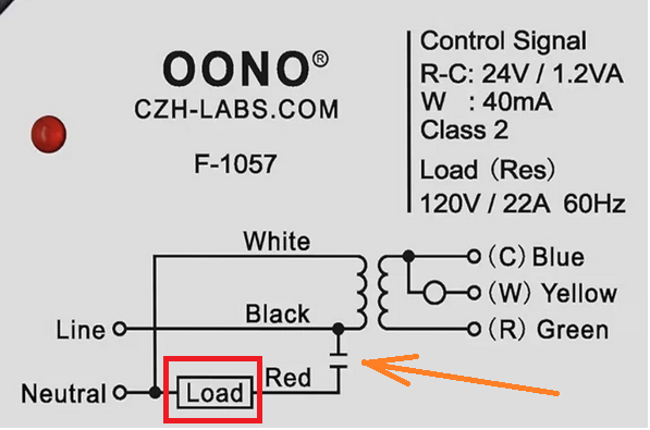

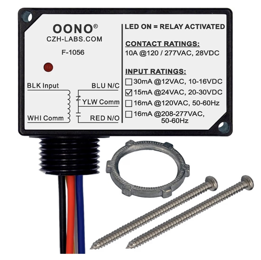

    Perfect. That is totally doable. Before I install it like that, is it possible to use this product? If so, could you break down the wiring for me?
    https://a.co/d/7WTkSB4
    109A_5 Posts: 4,759
    I would say no. Both the load (Red) and the switching contacts (Orange) are on the 120 VAC side of that device. This device is for using a 24 VAC powered device that switches 24VAC with 24VAC wiring to ultimately control a 120 VAC device.

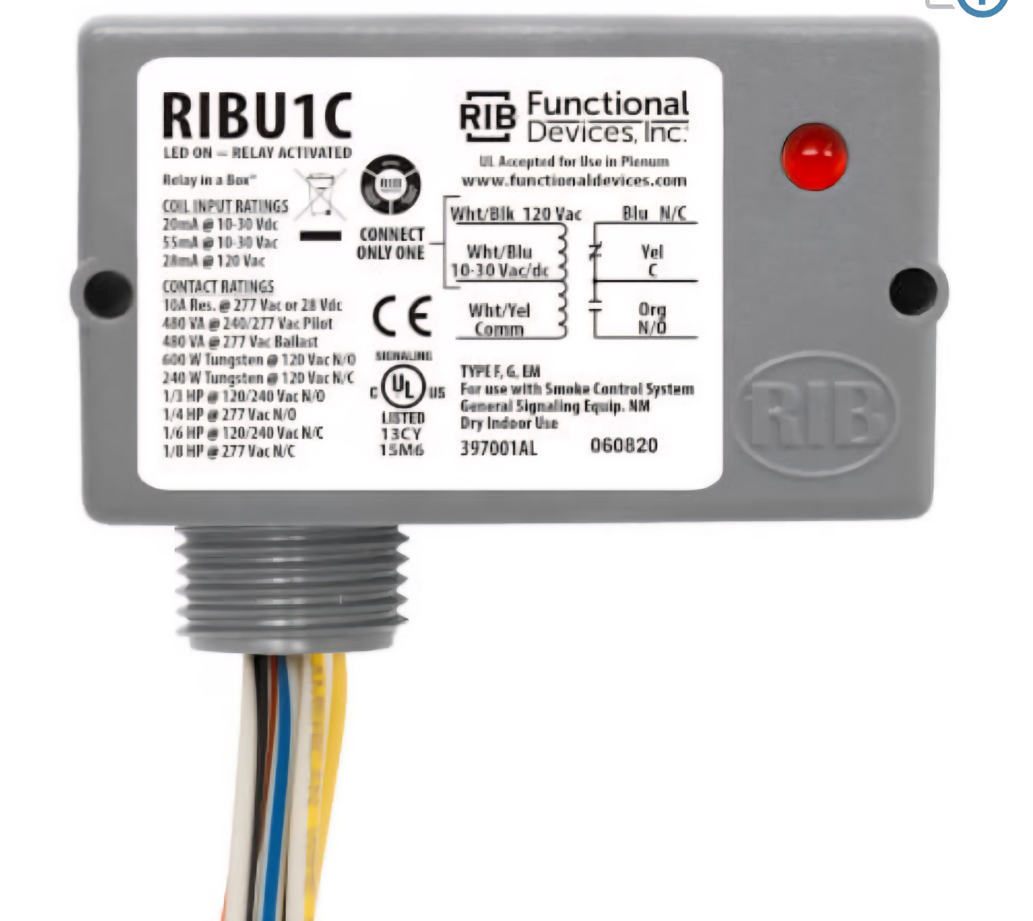

    This is what you want.
    R (Red 24v) on a 40 va transformer to R on the thermostat.
    C on the transformer to C on the thermostat and White/Yellow (Comm) on the RIB relay.
    W on the thermostat to White/Blue on the relay.
    Yellow on the relay to one thermostat Black on the boiler.
    Orange on the relay to the other thermostat Black on the boiler.
    As a side note, I see 2 circulators. The Hydrostat seems to be the zone that's getting the smart thermostat. Does the other zone use a line voltage (120 volt) thermostat, because I don't see a switching relay for it. If that second zone is calling, there's nothing to shut off the circulator if boiler temperature drops below the Low limit setting. And that's why you don't have enough hot water in winter.

    So I would still need a transformer with this relay? The one I pictured was a transformer and relay in one, which was why I was asking about it.

    Yes, you will need a seperate transformer. The one you show has line voltage contacts. You need low voltage contacts.
    Sorry, no black wires. Different thread. Orange and Yellow go to TT on the Hydrostat.

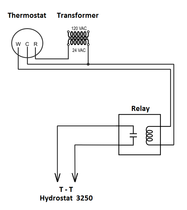

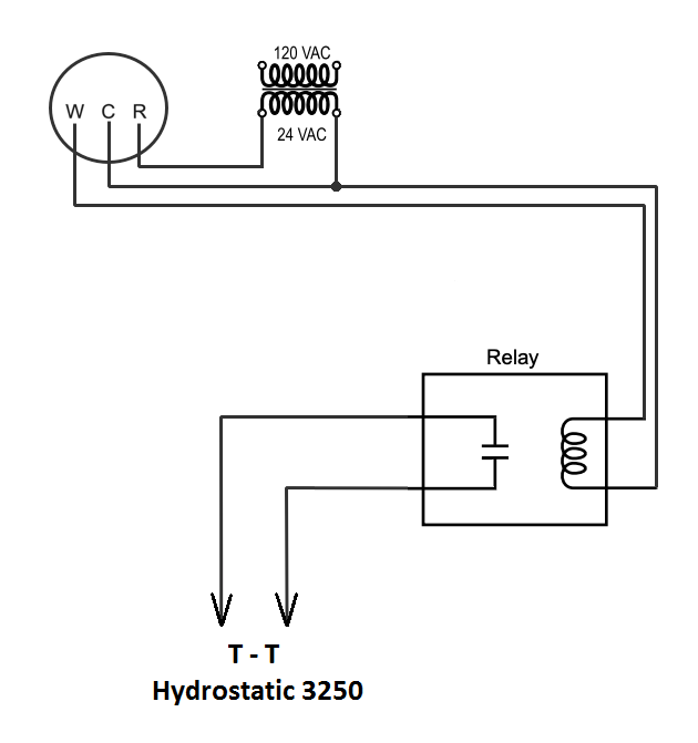

    Here is a diagram you can use.
    Yellow and orange on the rib relay would go to T & T on the hydrostat.

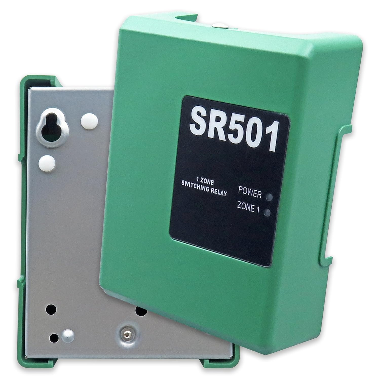

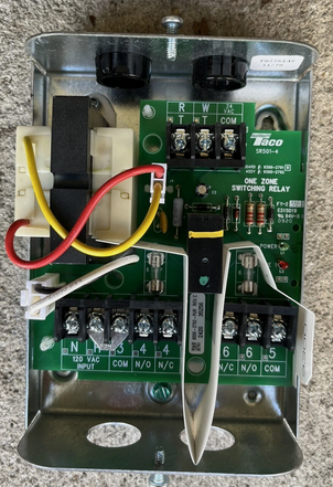

    Products like the Taco SR501 switching relay (and others) have their own enclosure, so no exposed wires. There are extra features so you have to wire it up correctly.

    Taco SR501is good but more $$$ easier to install though.
