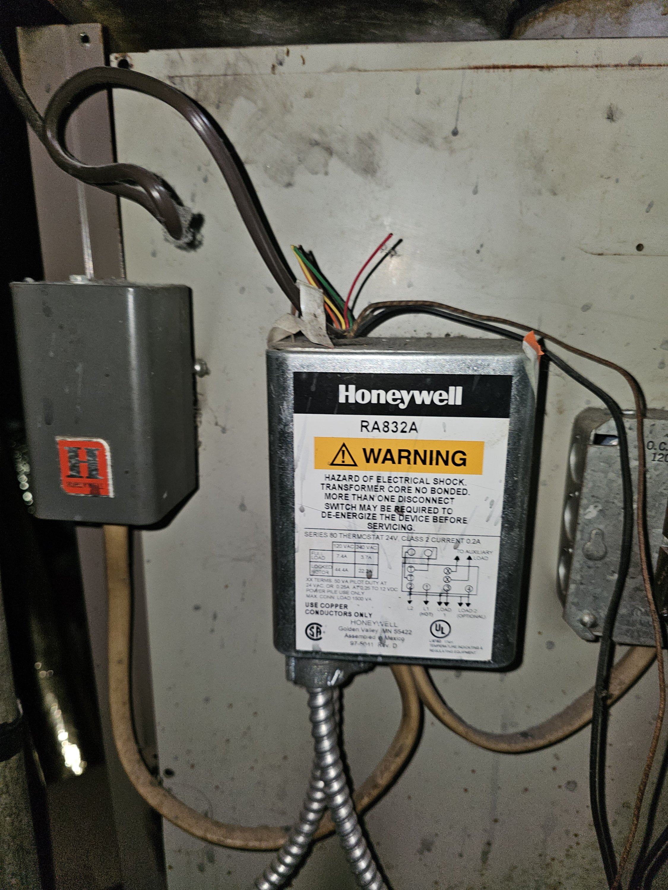

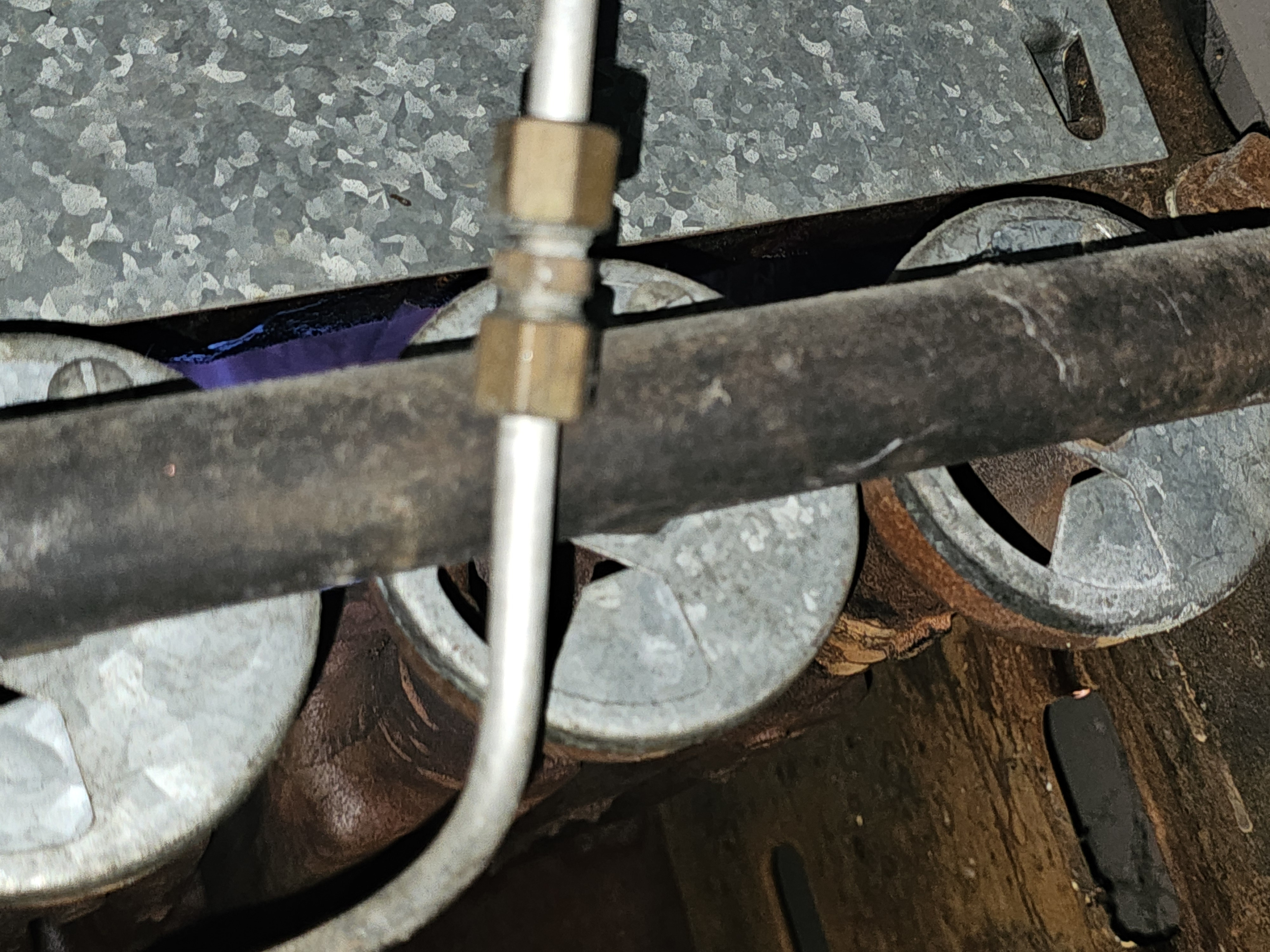

Hey guys, i have a g 27 american standard heater/boiler thing, I do not know much about this thing at all and its just me and my ol lady that live here. I only recently found out how to manually light the pilot last year. had no issues then. this year ive had to re light the pilot multiple times (not more than once a week) until the last couple days and today it shut off as soon as it was light and turned to on. now i cant get pilot to stay lit. please help.
IMPORTANT SIDE NOTE: So on the instructional plate on this thing it says to "Turn the manuak gas cock valve to off position for 5 minutes before lighting pilot"
I have no idea what that is to do that. please guide me through this!?

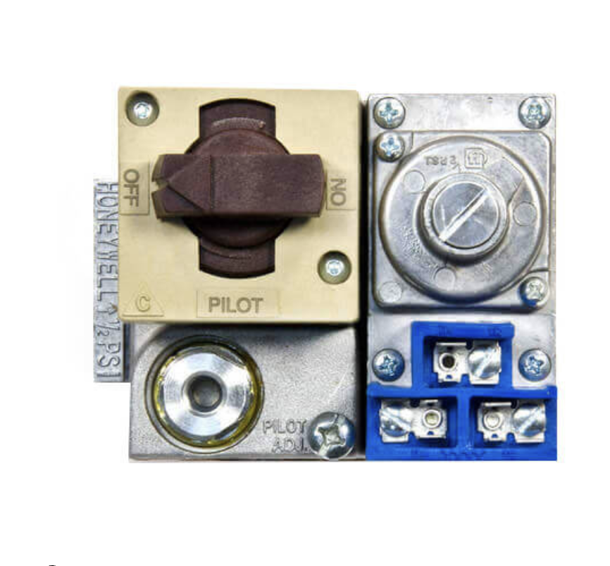

    in your case turn the knob on the combination gas valve to off and wait the 5 minutes but those instructions are likely for an old gas train that had a separate gas valve, regulator and manual pilot and main shutoff valves that was replaced with that combinatin valve.
    does the pilot burner envelop the thermocouple, the little copper colored rod well while you have the button/knob held down? most likely the thermocouple is wearing out but if the pilot burner isn't heating it that will also keep it from generating enough current to hold the safety valve open. you are holding the button down for about a minute to heat the thermocouple before releasing it, right?

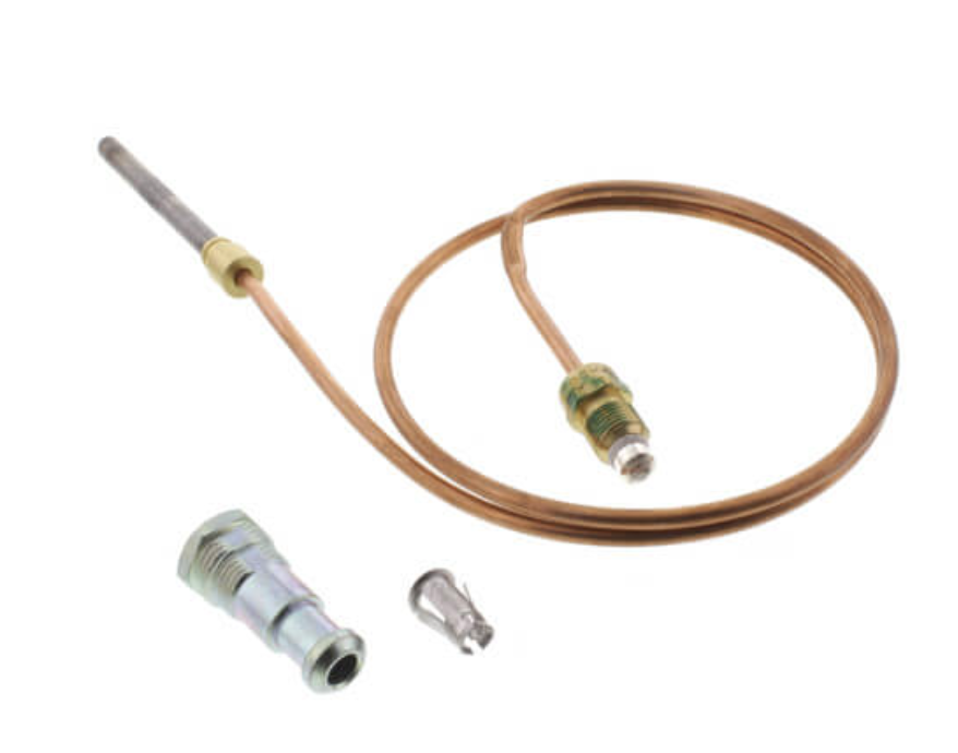

    You probably need a new thermocouple. You can get them at some hardware stores, Big Box store maybe and a plumbing/heating supply house for sure.
    maybe your buddy can give you a hand changing it. If the thermocouple is bad not much you can do but change it.

    You can use the same valve that you use to light the pilot as the manual valve. It is the same valve you turn to pilot and press down to light the pilot.
    • So the first step is to turn that of OFF and wait 5 minutes to clear any gas from the combustion chamber.
    • Next is to turn the valve to pilot and push down to let gas flow to the pilot burner and light that with a flame.

      • If the pilot burner is dirty and the pilot flame is too short to engulf the thermocouple in the pilot flame, the metals will not get hot enough to generate enough electricity to keep the pilot burner valve open and it will go right out.

    • Another problem can be that the thermocouple is worn out and no amount of heat will cause it to make enough electricity to keep the pilot valve open
    Here is a link to a regular thermocouple that you can replace Thermocouple
    If you find that the pilot is not large enough to heat up the business end of the thermocouple, then you need to have the pilot burner cleaned.
    If the pilot is big enough to heat up the thermocouple, then your thermocouple is bad and needs to be replaced.
