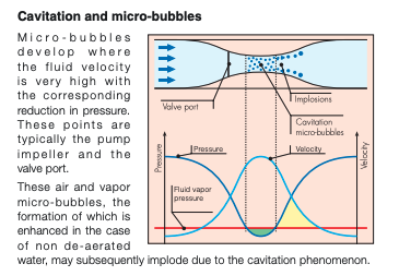

    Enough of a kink or restriction can cause cavitation, which acts just like an air problem. Velocity goes way up across that restriction.
    We see this at balance valves that have been choked way down.
    It is one thought if this is an ongoing issue. With good air removal at the boiler and air problem should have cleared up within hours or a day of running.
    Pex can mask the sound of cavitation which sounds like Rice Krispies after you pour the milk in :)

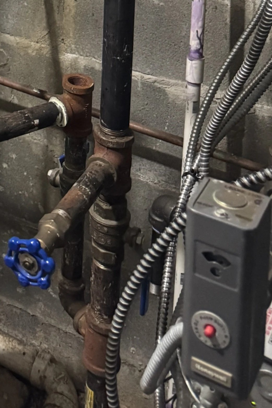

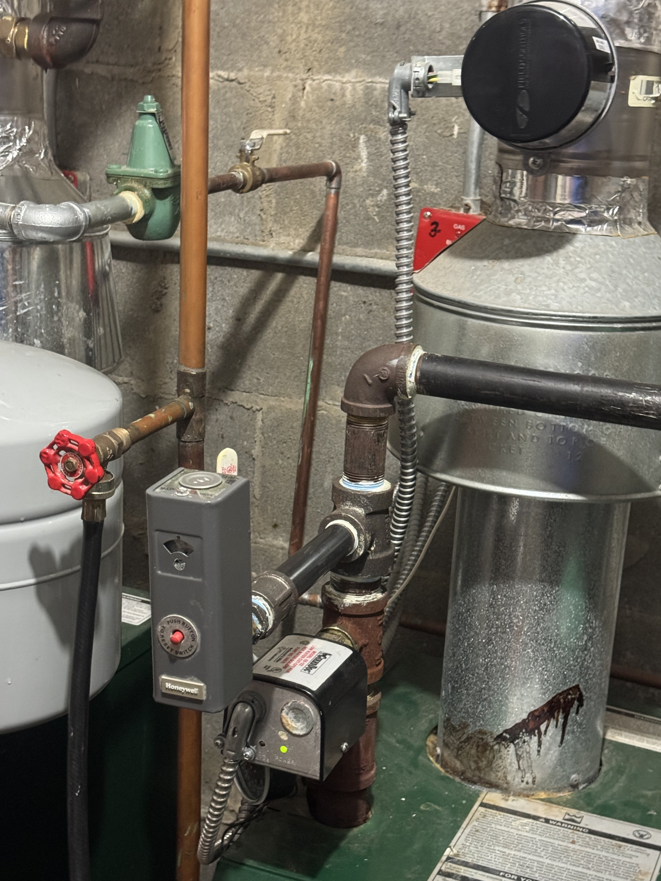

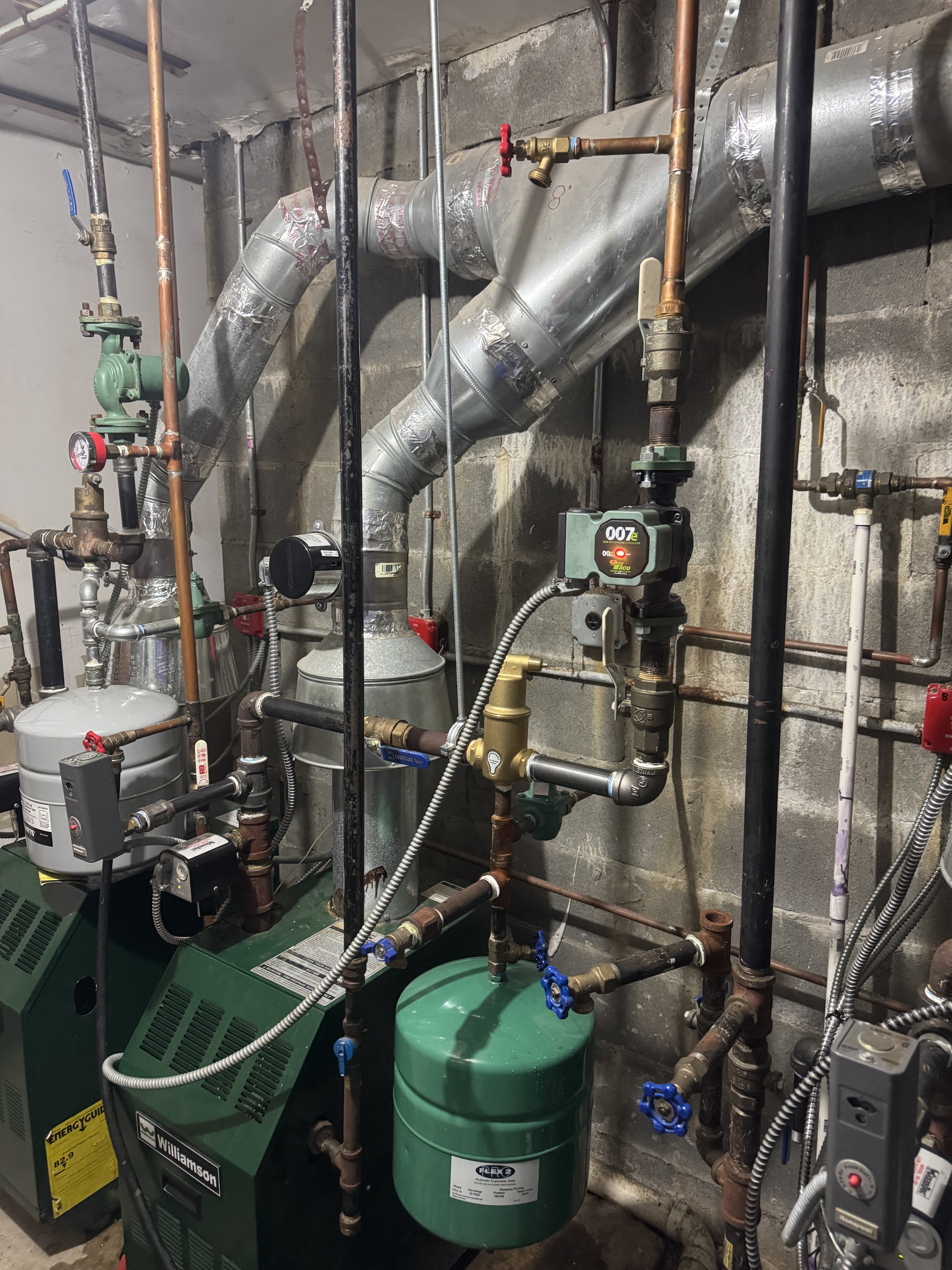

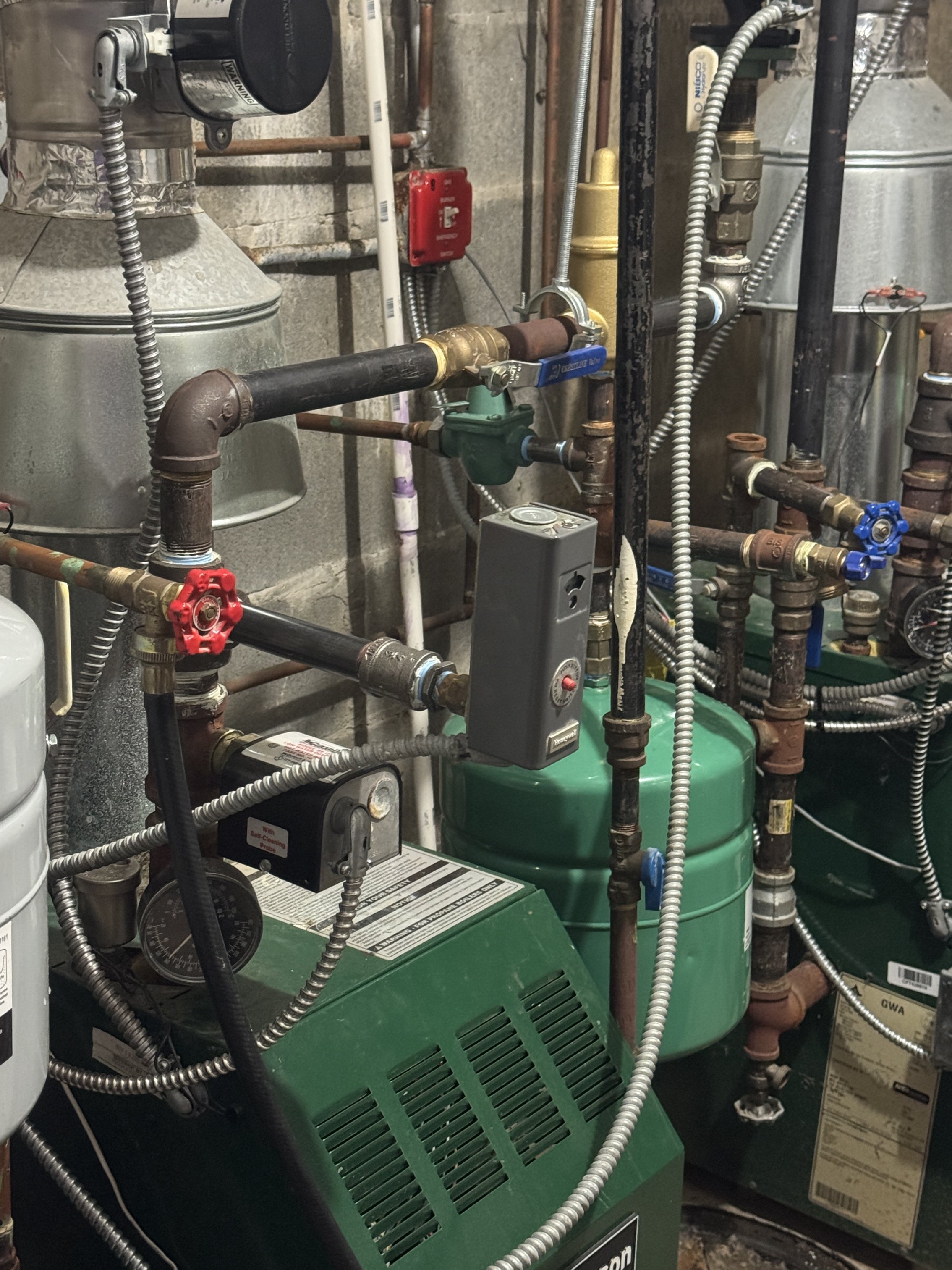

  • hello, sorry haven’t gotten a chance till today to get back to the site. Bob I did what you said, still having air, the return sounds like a cascade but no matter how much I purge all the same. I put a hose on a valve off the building and still air.

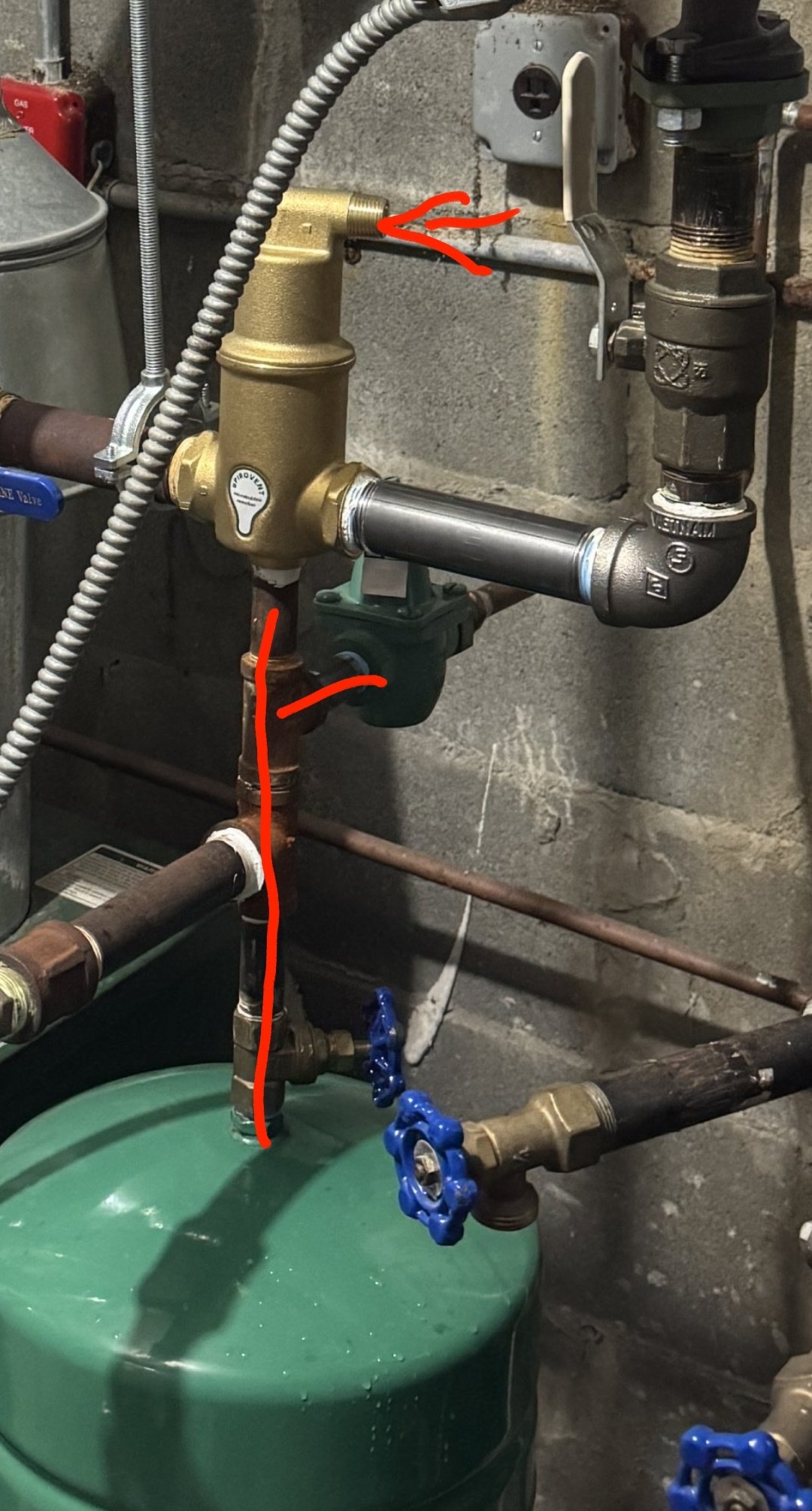

    An idea, probably not the issue. See photo
    There is an obstruction in the pipe marked red, and the circulator is "sucking" in air from the spirovent? Seems very unlikely with a pressure >12psi
    Not the problem you posted about but "A" problem is the manual reset aqastat. probe will never work in that location. Needs to be in active water not a dead ended pipe

  • probably 10-15 gpm with the garden hose. This is the pump I was using
  • no that is the purge stn. for the next boiler over. Hard to tell but it’s this one with a white handle ball valve behind aquastat circled. Why do you see a problem here too?
