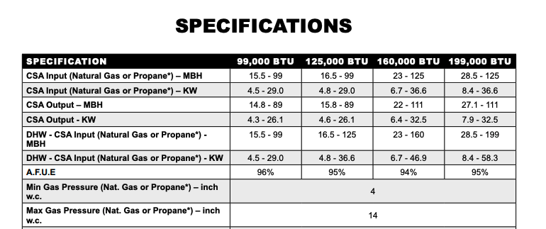

    The manual tells you the required LP pressure. If you are dropping to .6" WC I doubt it will run? Readings will depend on which port of the gas valve you are connecting the manometer to?
    Screenshot 2025-12-20 at 1.56.54 PM.png Screenshot 2025-12-20 at 1.57.43 PM.png Screenshot 2025-12-20 at 1.58.30 PM.png

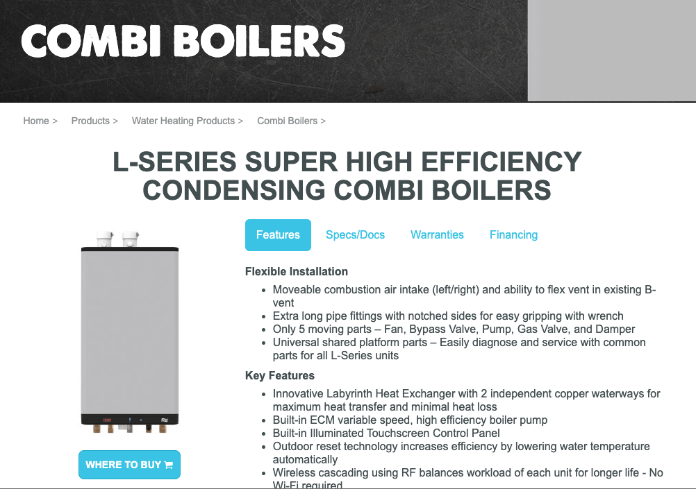

    This looks more like a rebadged HTP unit.
    High Efficiency Combination Boiler | Ruud Combi Boilers

    You have an incoming gas pressure issue if the incoming pressure goes from 12" wc to 0.61"
