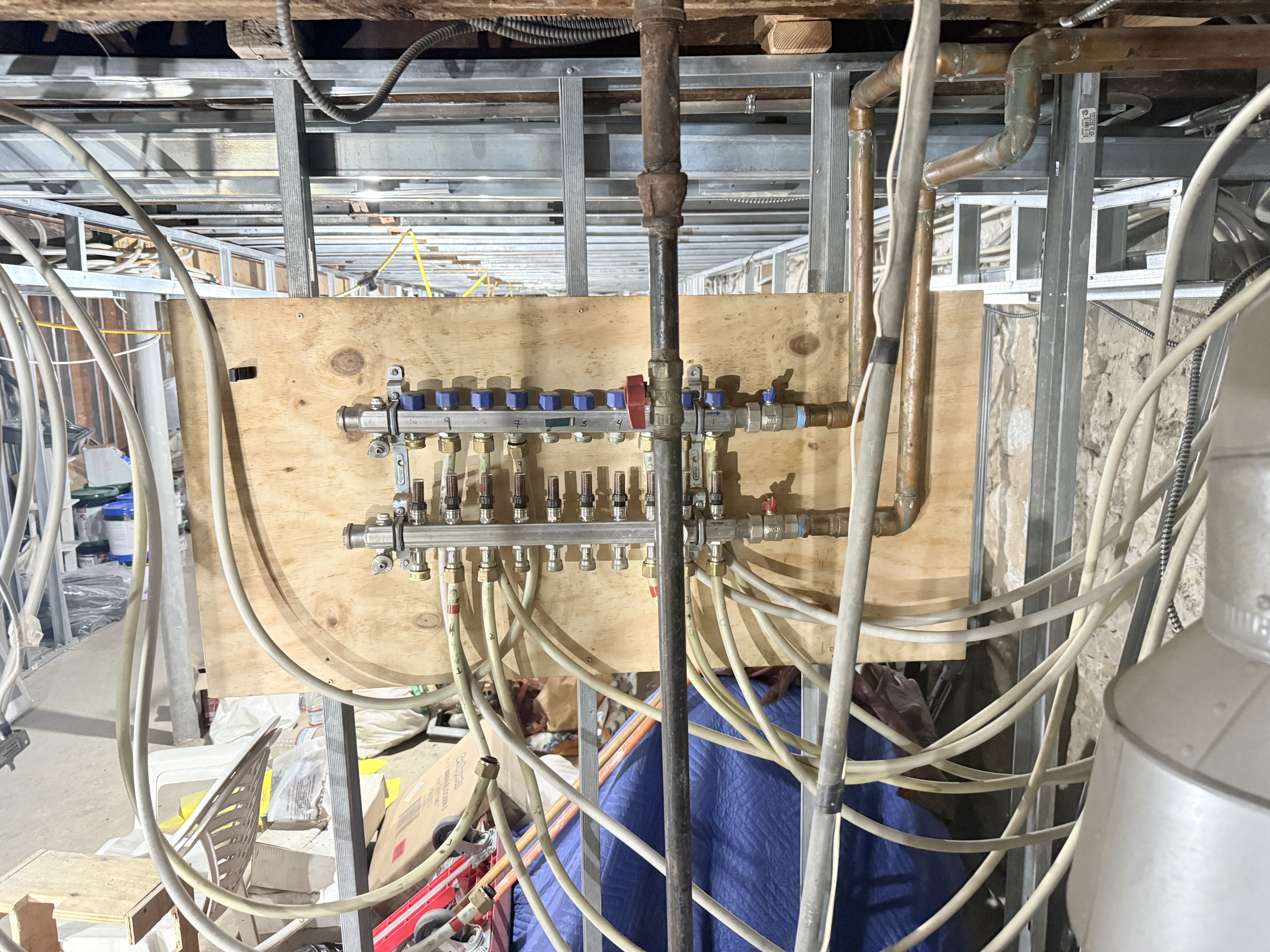

I’m working on a 100-year-old, two-family hydronic hot-water system (not steam) in Brooklyn. The house is about 1,800 sq ft, with 10′ ceilings on the living floors and a basement just under 8′, which will be finished as living space.

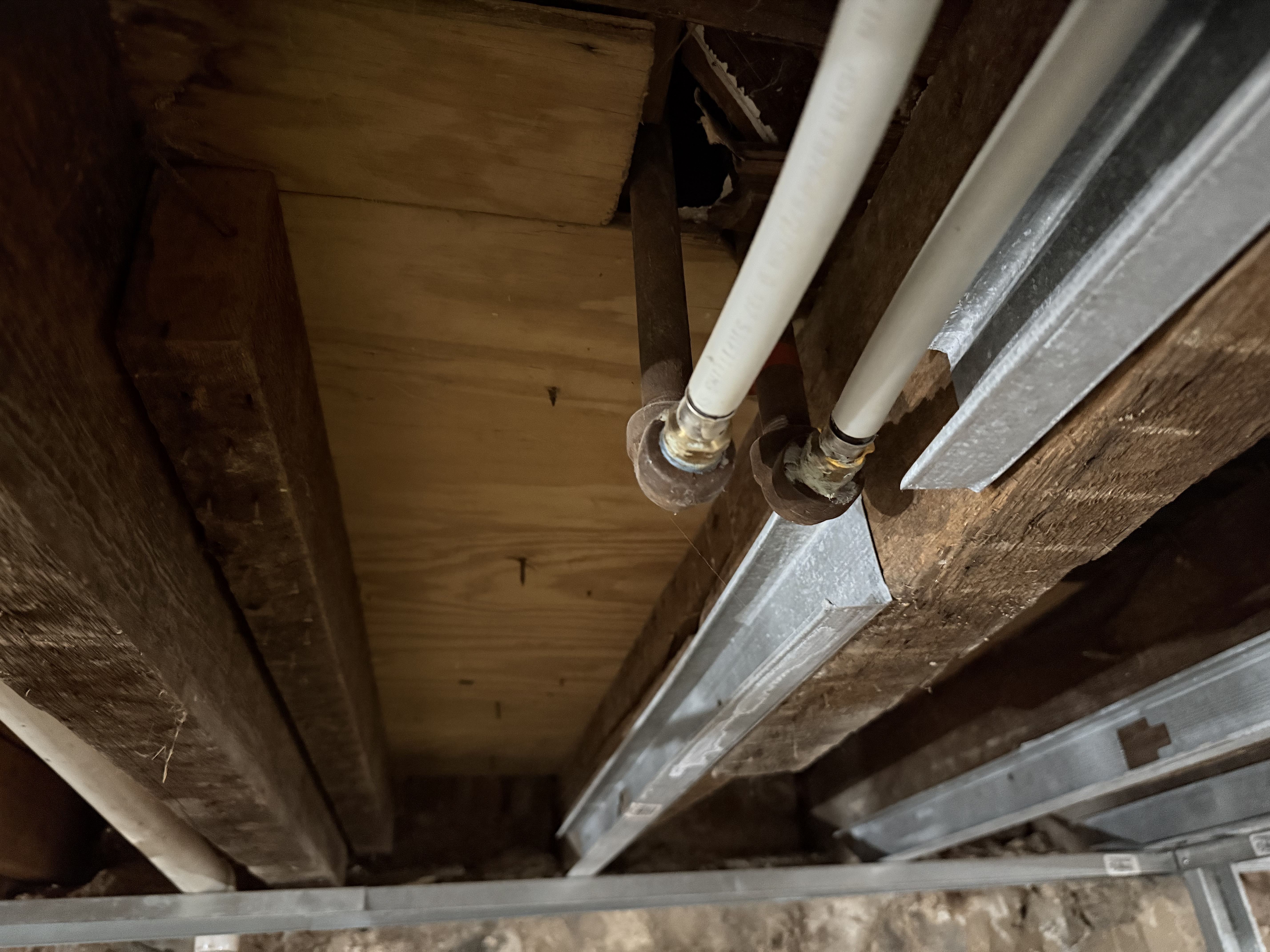

Originally, the system had large cast-iron gravity mains, which were removed years ago to gain basement headroom. About three years ago, during a partial update, the distribution was converted to a ½″ Viega PEX manifolds system with manifolds.
Since that change, I’ve been dealing with:
- Lukewarm radiators
- Uneven heat distribution
- Ongoing balancing issues
The basement is currently open, and before the ceiling is closed, I want to correct the piping properly.

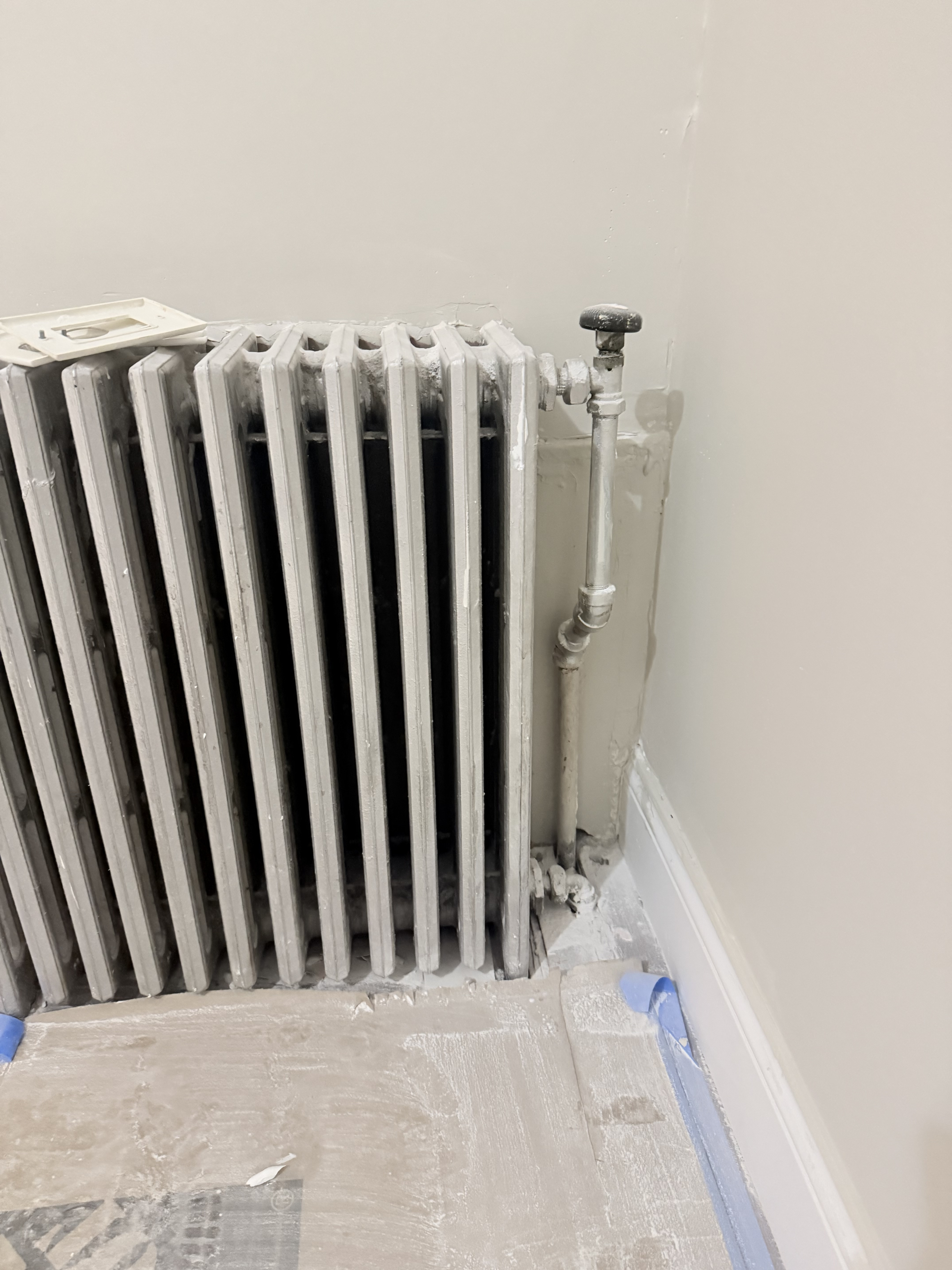

- 10 cast-iron radiators
- Two pipes at each radiator (½″ supply + ½″ return)

Since the radiators are already two-pipe, I’m considering removing the monoflow/diverter tees entirely and repiping as a true two-pipe trunk-and-branch system:
- 1″ supply main
- 1″ return main
- ¾″ branches to each radiator (currently ½″)
- Radiator-level control using TRVs or manual supply valves, with lockshield valves on the returns
- Ability to shut off individual radiators

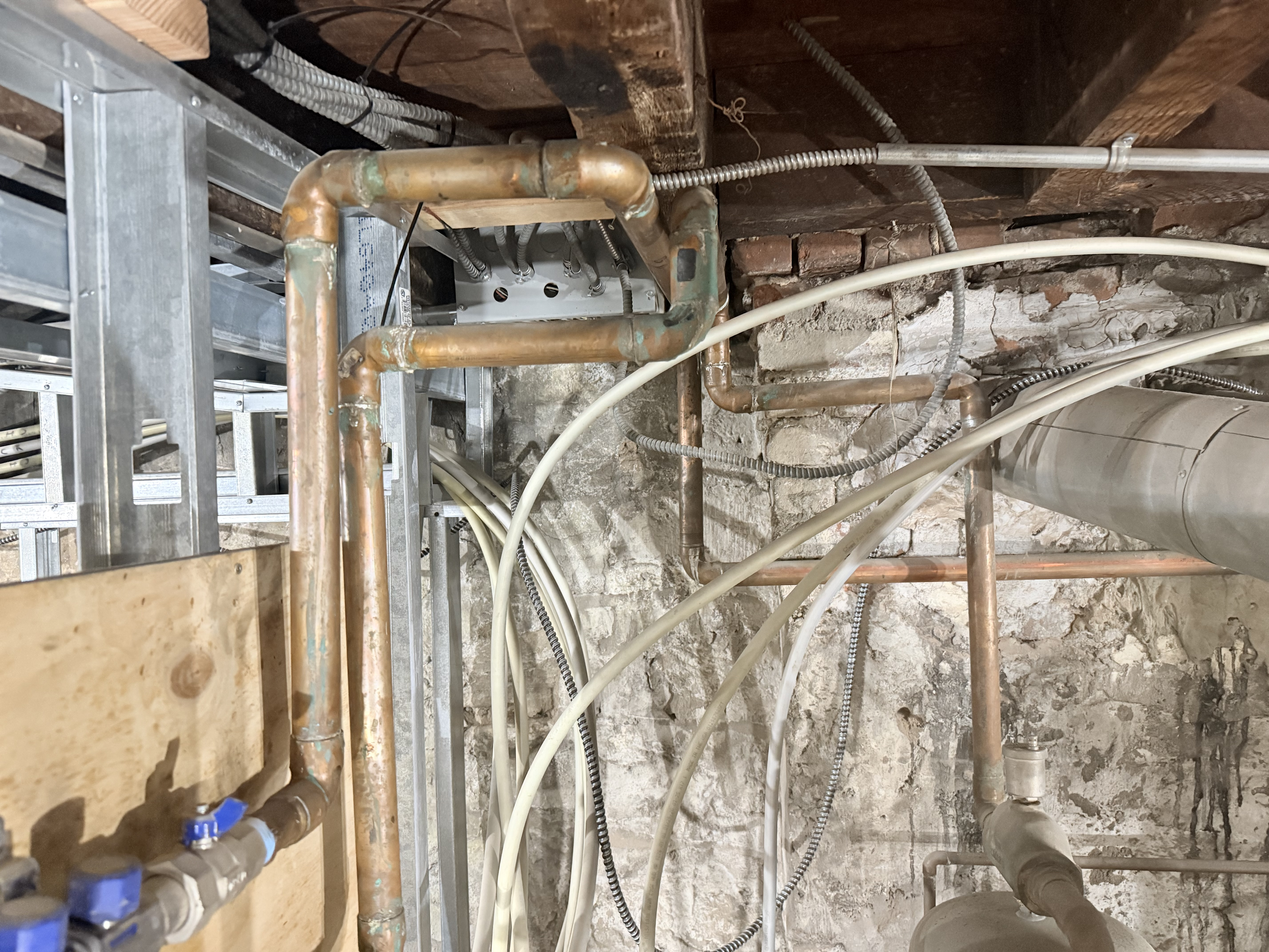

what is that picture with the manifolds?
your picture isn't of a monflo(diverter tee) system.
home run to manifolds, which i think your pictures are of will work well (although that installation is abysmal) if it is designed correctly.
you need to start with a heat loss, from there you get the flow you need, from there you get what size pipe and boiler you need.
I don't see monoflow in the pictures but if its there get riid of it. You gone this far with it start from scratch and do it right. You have to go through all the design steps to get it right. And the steps need to be done in the right sequence.
