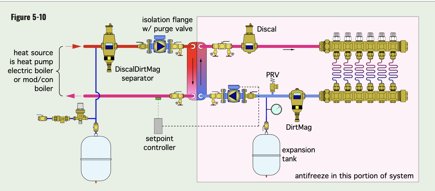

When using a heat exchanger with a condensing boiler to feed non-oxygen barrier pipe, how should it be plumbed? Option 1, come off the boiler, to a pump, then to closely spaced T’s and back to the boiler, with a separate loop coming from the closely spaced T’s, to a pump, and then through the 80 plate heat exchanger, with then another pump on the isolated side to feed the radiant tubing, or Option 2, come off the boiler, to the pump, through the heat exchanger and then back to the boiler, so basically plumbing it like the heat exchanger is a hydraulic separator?
    hot_rod Member Posts: 28,077
    It can be this simple. You need expansion and relief valves on both sides of the hx

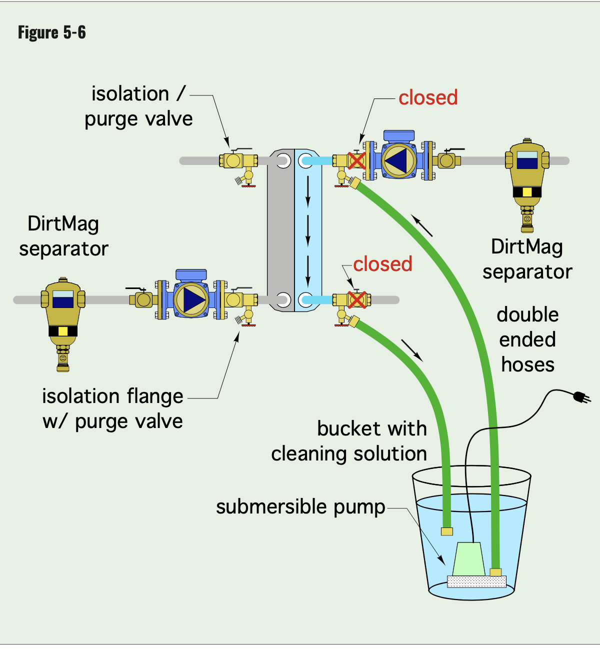

    If the tube side needs glycol, conditioner, or occasional flushing, use some purge valves like the Webstone with hose connections. Counterflow through a FPHX.
    A DirtMag for sure on the tube side of the HX.

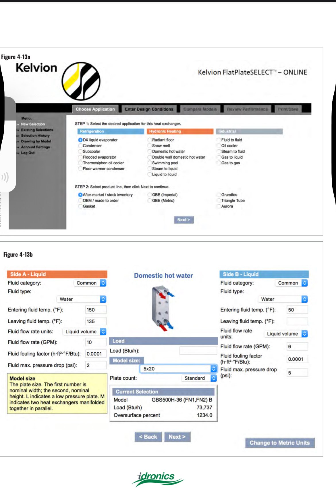

    Was the HX sized? Or is the 80 plate a guess?

    if the hx is the only thing on the boiler then there is nothing to separate, just need enough pump to produce enough flow through both the hx and the boiler.

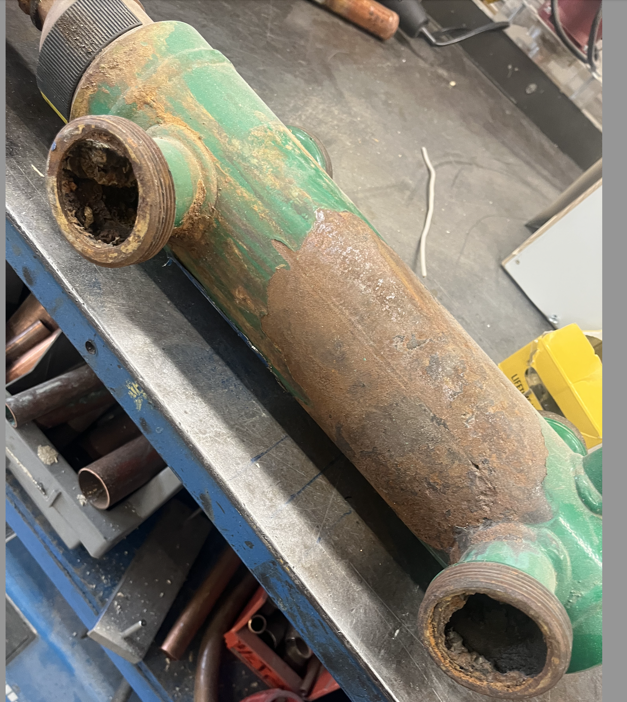

    This sep was on a high temperature rubber tube system for 18 months and rusted through!
    It was on it's 4 boiler in 20 some years of service.
    I have seen other rubber tube systems with excellent water quality 10- 12 years after installation. No rhythm or reason for it??

    @hot_rod yes, the 80 plate was sized, I called Badger Pipe from Wisconsin as others have recommended them in various threads on here for heat exchangers, and that one’s the one they recommend. The boiler manufacturer states in the manual that any piping system that doesn’t have an oxygen barrier needs a heat exchanger. Thank you for your help as always.
    @mattmia2 thank you, I assumed I just need to select a pump with enough head to handle the heat exchanger and the boiler, but wanted to verify.
    ideally you size a heat exchanger with a software like this. Most manufacturers have these calculators on their website
    You need to input temperatures and flow on both sides.
    80 plate sounds quite large?
    This example for dhw production 50 degree in on the B side
    It shows a 5x20 36 plate moving 73,000 btu/ h
