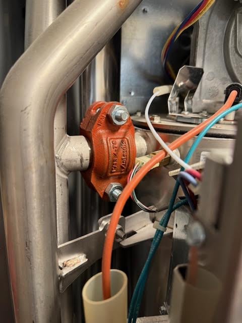

  • I worked on a NTI Trinity boiler this week. Novel use of a Victaulic coupling. Easy off, easy on.
    hot_rod Posts: 28,705
    Ignition wire down the drain also😯
