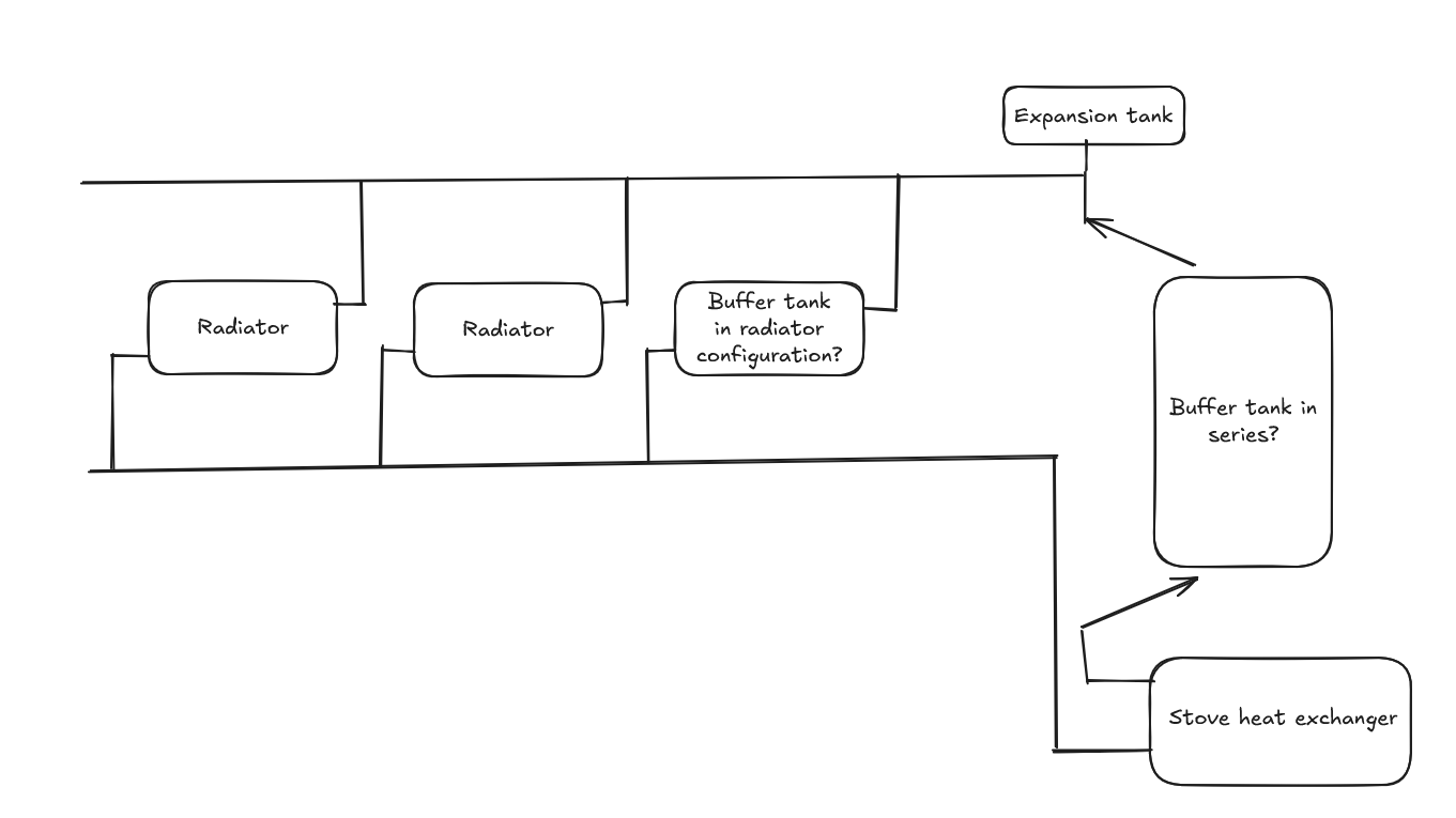

Hey there!
I'm trying to design a gravity fed heating system where I have a metal heat exchanger inside of a wood stove that is circulating water through cast iron radiators. The heat exchanger is kind of a DIY solution made from a series of welded pipes that is used very often here locally in eastern europe. In general it can be assumed to behave exactly like a classical heat exchanger with a cold inlet and hot outlet.
The big problem with such systems is that it's very hard to control the heat output initially when starting the fire, so there are moments when the exchanger receives a lot of heat. If the system is not big enough, this leads to water boiling in the expansion tank and in general dangerous temperatures in the system.
I have a small system for now that heats 3 rooms with somewhere around 60 sections in total. This amounts to around 20l of water in total, as the cast iron radiators are of new style and have reduced water capacity. I know for a fact that this amount of water is way too low for the system to not overheat.
From what I've read, the classical solution is to place a buffer tank in the system. The problem is that the amount of material I found online is extremely limited and but often there are 2 options mentioned:
  • Placing the buffer tank in series to the hot outlet;
  • Placing the buffer tank near the heat exchanger in a radiator configuration.
From what I understand placing it in series is the safest bet, as there will be a good amount of cold water to keep the water from boiling in the expansion tank initially. For me it's not entirely clear if such a configuration will allow for water to flow at all, as you have basically a big tank instead of a pipe. Assuming that water flow is not a problem, then another downside is that the radiators will only start to heat when the buffer tank will be hot.
The second option seems to be better, however I am afraid that the water will still rise to dangerous temperature initially.
For reference the plan for the buffer tank is to be around 80-100l, possibly more as to be on the safe side. I also want to clarify that the system will not contain any pumps now or in the future.
What do you think about this?

    If the buffer is in series it will always be hot and not have a lot of "space" to absorb the over-heat.

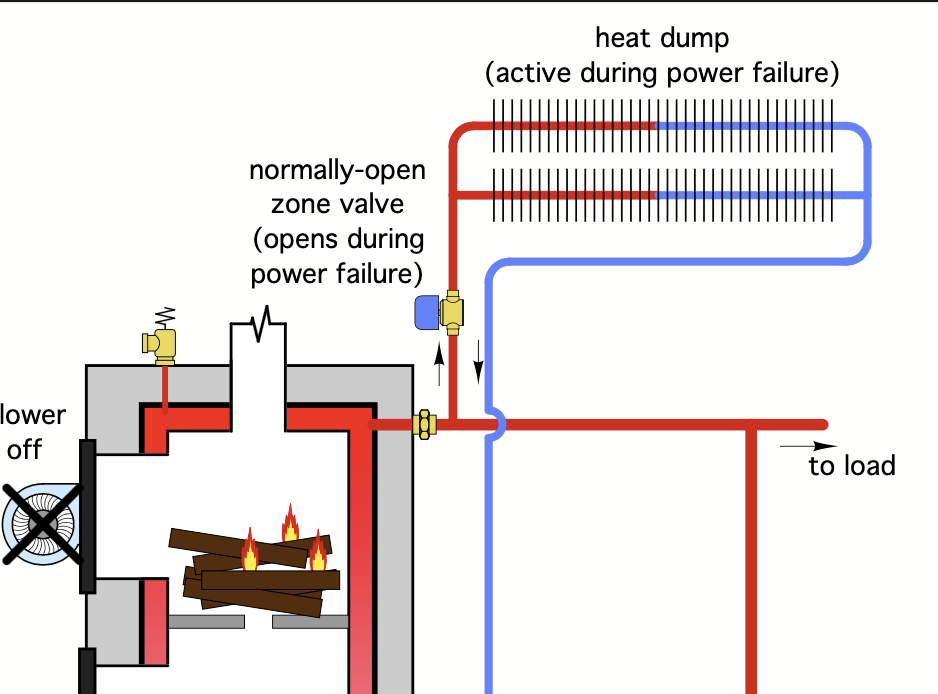

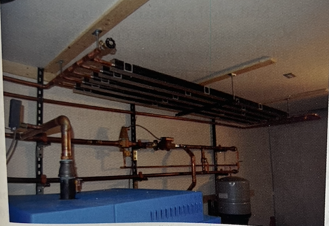

    Another option that we use is a fin tube dump zone. These get used on large solar thermal arrays or wood fired equipment.
    It would operate with an electric valve that opens if power fails of based on a thermostat. These are more often for power outage protection on pumped systems.
    Or a 3 way thermostatic, non electric, option.
    On solar systems the fin tube mounts behind the collectors and a 3 way valve diverts at a certain temperature.
    A small fan coil works well also but requires power. On occasion a loop of pex tube is buried outside as a dump.

    Without a pumped flow, the dump zone planning will be more involved. The tank mounted above the heater would allow it to it to thermo-siphon.
    Is a DC pump and battery an option? That gives you better control options, a 20W solar panel to maintain a battery. Then you could put excessive energy into and out of the tank easily.

    Thanks for the answer. It makes complete sense about installing the buffer in series.

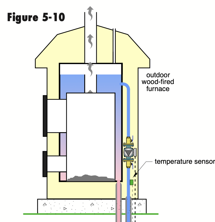

    Those heat exchangers inside the firebox can be hard to control, especially when the fireplace is running for heat also. The basic concept for excessive hot water production is "use it or lose it" same with large thermal arrays in the summer.
    This is a common solid fueled beast used in the US. Large water content to buffer, open unpressurized, wood mess is outside.

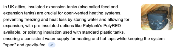

    These seem to be common in the UK. The UK is the largest boiler market, but now being taken over by A2WHPs.
    It shouldn't be too hard to insulate a tank in your attic?
