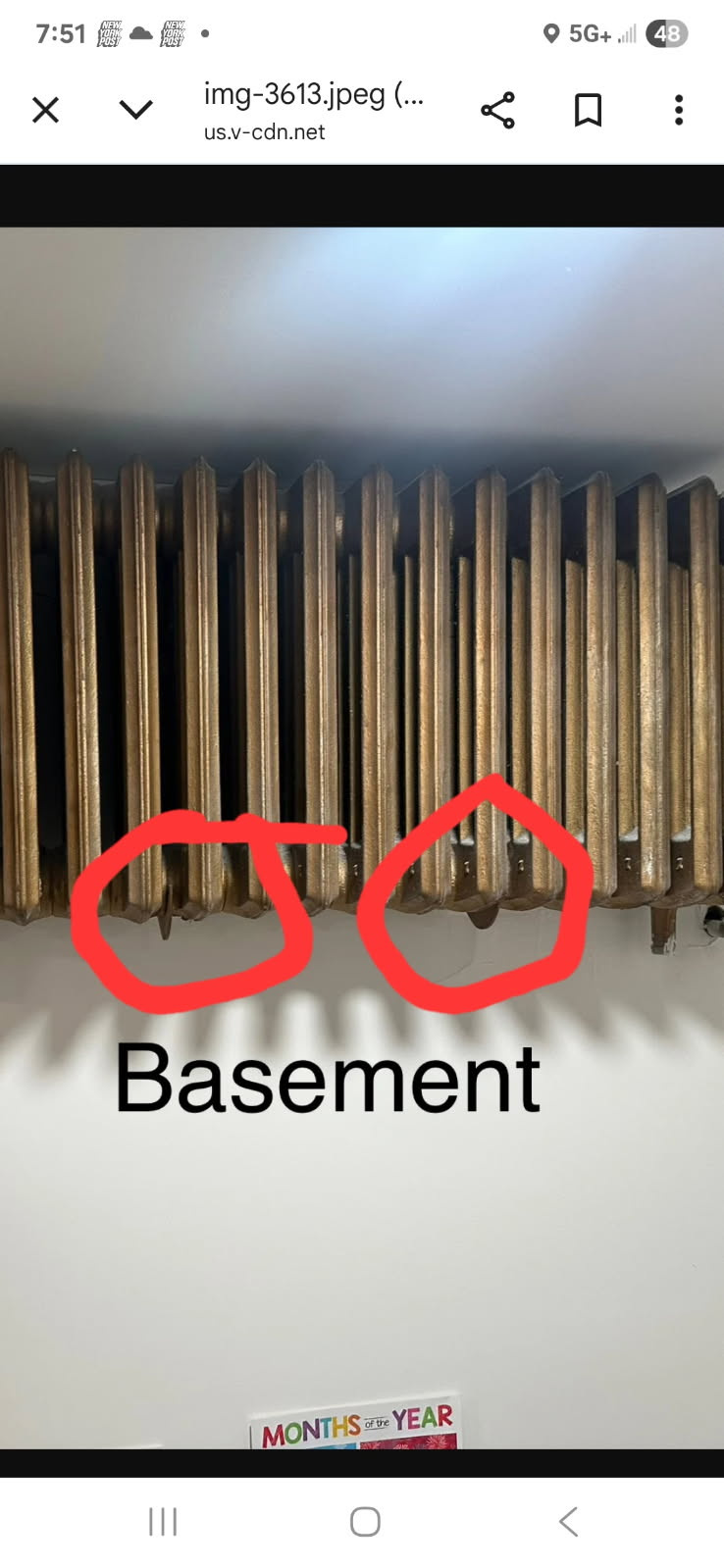

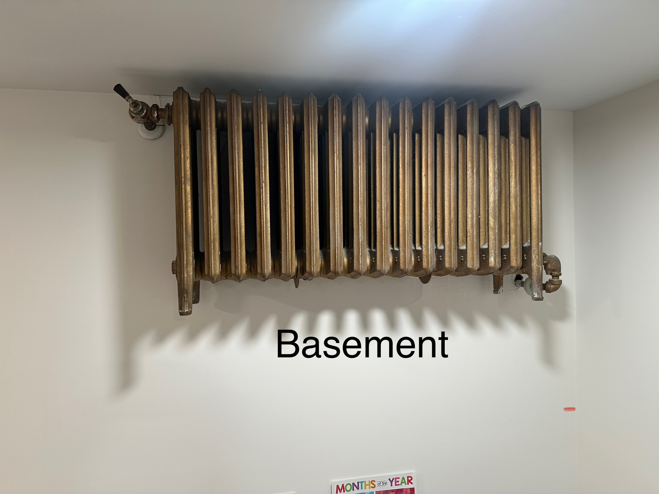

I went to meet a customer today who had a gravity system to scope out the system. Their complaint was that a previous contractor used to come and bleed air from the system from time to time. Poking around each radiator was warm some hotter than others. I suspected that the original valves that had been replaced don't have orrfice plates in them. What I questioned was the fitting at the outlet of each radiator on the basement, 1st and 2nd floors. The third floor had none, but someone installed Gorton C vents on those two. I haven't run into this fitting before and wanted to get more insight on it. I attached pictures of the radiators and one close up of the fitting.
don't remember the system but that is a return fitting for one of the vapor systems. if i recall it has a water seal and a ball in it. someone that recognizes it will tell you.
are any of the vapor specialties still near the boiler?
that one pipe radiator might be ok depending on how it is plumbed. the vent could be a problem depending on the specific vapor system.
That's an "O-E" Vapor system. It is covered in chapter 15 of @DanHolohan 's book "The Lost Art of Steam Heating".
The fittings on the radiator returns are water seals which, assuming the steam pressure is kept low enough, will keep steam from getting into the returns.
The third floor radiator was probably added later, as during a remodel.
There is probably an air vent at the end of each dry (overhead) return in the basement. Can you post pics of these?
That makes more sense. Unfortunately I was in a hurry today trying to meet my better half to move her horse to a different barn. I'll contact the customer to get some more pics. My first thought was darn that looks alot like a Moaut water seal.
I think Mouat, O-E, Richardson, Broomell, VECO, Wiley and other systems that used water seals all had the same basic influence.

No Jazzy....Do you see the two hooks grabbing the bottom of the radiator? Mad Dog
1 -
@Mad Dog_2 indeed there were grab hooks, when I first saw that my back hurt just looking at it to lift that thing up there!
