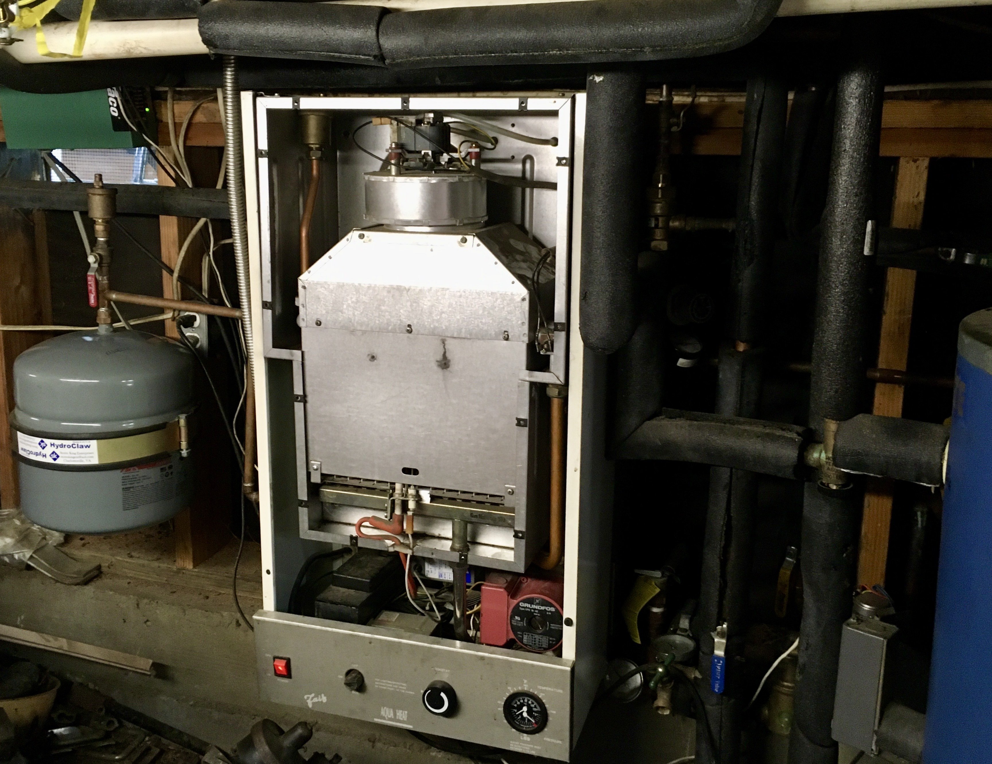

Recently the boiler has started to whine and howl about 30 seconds or so before the burner flame is shut off. I took the boiler apart enough to remove the blower fan housing, the vent located up in that top right corner, and get to the silicone hoses, as well as visually inspect the boiler matrix to see if it was cracked (it was fine). The vent seemed to be clogged/not working, so I cleaned that and confirmed function. One of the silicone hoses was kinked flat on the back side of the boiler, and I was able to resolve that by just repositioning the hose. Blower spun fine and was quiet still (amazing). I checked and pumped up the pressure in the pressure tank. No real change in the whine/howl even with changes to the system pressure using the pressure regulator located on the fill side.

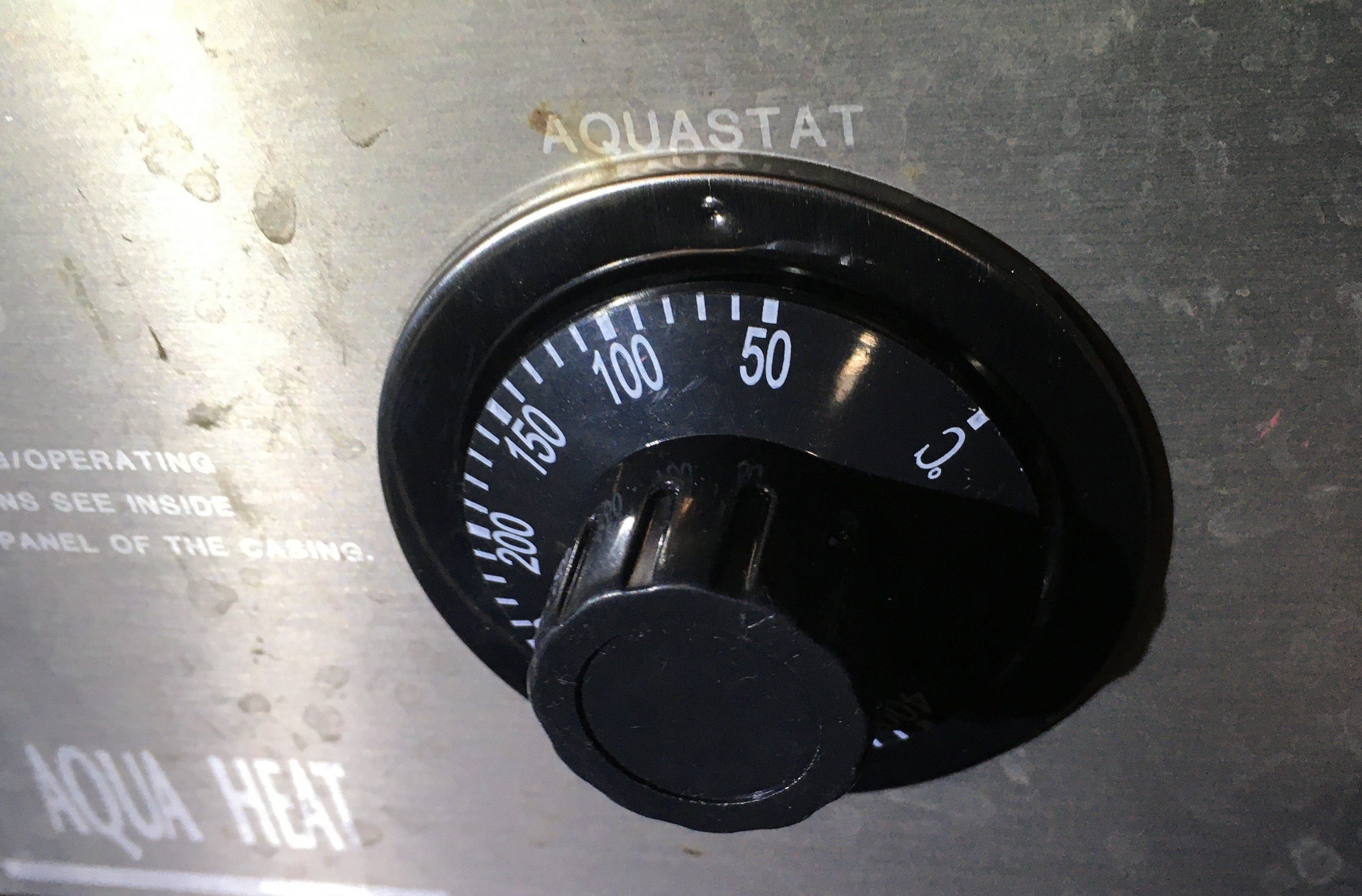

I think I have a failing temperature controller on the front of the boiler. It seems to have lost sensitivity below the temp point of where it's been sitting all these years. So if I move the dial towards a cooler boiler temp, even a "smidge" of a movement, the boiler will not work. If I move it back towards hotter, just a "smidge" it will work, but then I get the howling/whining. I've noticed that the howling/whining doesn't occur as frequently when the system is heating the house, but when it's heating the water in the adjacent 40gal water tank, it howls/whines every time it cycles on and off, during that water heating for the tank. So literally about every couple of minutes until the water tank water is back up to temp and the system shuts down.

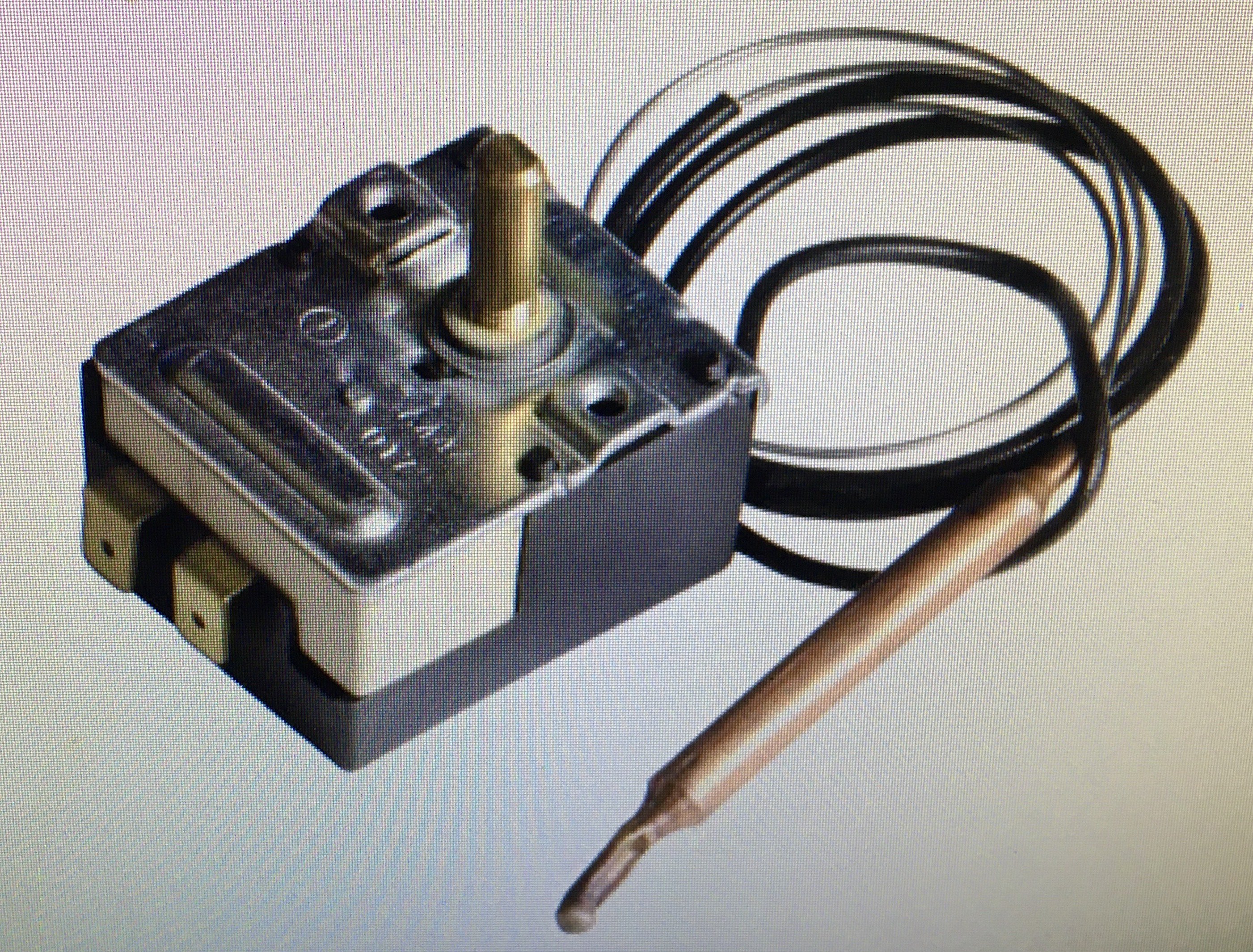

I popped the front off of the boiler yesterday and that temp controller is made by "Prodigy" in Italy, and is just a simple 2 prong unit with a probe up into the water pipe housing near the water pump. I found an identical until online: COSMOGAS 62101044 and it's somewhere in Europe on a website. I also found a ton of generic ones. I've ordered a cheap generic one just as a tester for my theory that I have a dead contact area in the existing controller.

Here's the heart of the system(front panel removed for photo):

    The water here is very hard, so that could certainly be the issue, and having zero experience and knowledge with these systems, I had no idea. That said, the reasoning that made/makes me think it's the temperature control, (the knob on the lower panel with the white ramp painted on the dial, in the photo above) is that the sensor in the controller is literally dead at even the tiniest rotation "cooler" than where you see it in the photo.
    For example; yesterday I reset the dial literally "barely any rotational movement" cooler than where the boiler was running at. I then lowered the thermostat in the house to 69*F, and let the house cool overnight to see if when the thermostat called for heat, would the boiler kick on. The weather has been summer-like here, so the house will sit at 72-74 all day, and still be 70 in the morning. At about 8am, I heard the digital thermostat "click" on and call for heat. I confirmed on the thermostat that the house was 69, and then went under the house (I can stand up in the crawl space) to watch what the boiler did. The boiler did not turn on. I waited for a moment, and still nothing. I touched the temp knob on the boiler and just wiggled it a little, and "click" the temperature control turned on, the boiler came alive, first powering the blower and turning on the water pump, and then the ignitor fired, the gas lit, and I was back to normal boiler function. I set the thermostat in the house to 72, just to let the system run for a long time, which meant cycling on and off quite a few times, as well as heating the domestic water, and everything worked fine… except for the howling that occurs just before the flame shuts off on each cycle. Pressure stays pretty constant, but looking at the 2 temp gauges that clamp onto 2 different areas of the system, the temp is up to 150*F. The system probably doesn't need to be that hot, am I correct? If I manually operate the temperature control, while the system is functioning, and shut the flame off when water temps are in the 140 range, I don't get the howling.

  • Good call! Thank you! Since this a just a 2-wire version, is it taking 120v from one wire, and passing it to the other wire, which takes that voltage to the circuit board, which in turn, causes the burner to be activated… and then run until this unit breaks contact between the 2 wires. If so, does it care if it's fed 120v (which is what my boiler runs on) or 240?
    Here's the actual OE unit. This is the one currently available in the UK, for $78US, labeled COSMOGAS. The replica I've purchased is identical, including the probe size, but a different color, and $22.

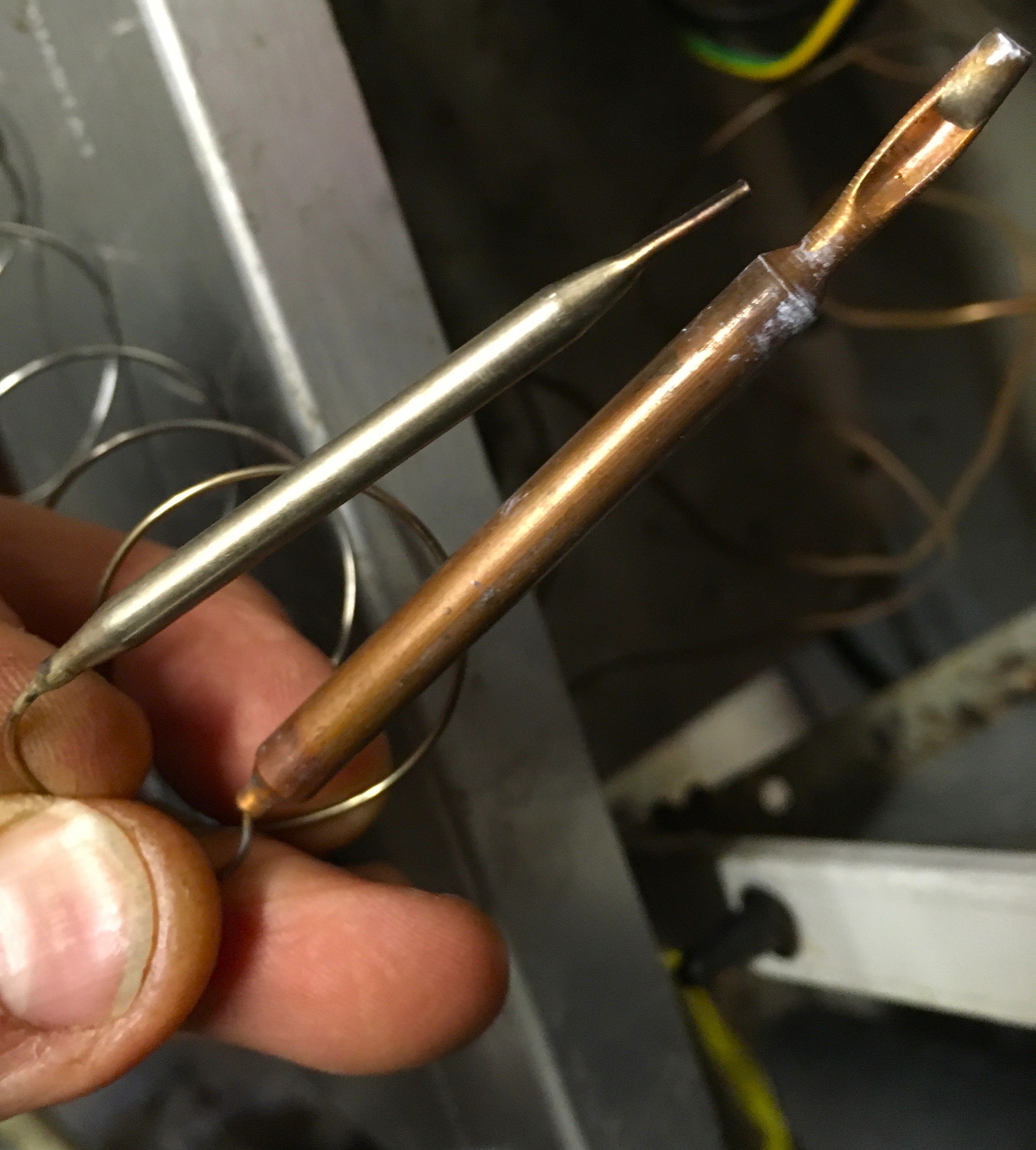

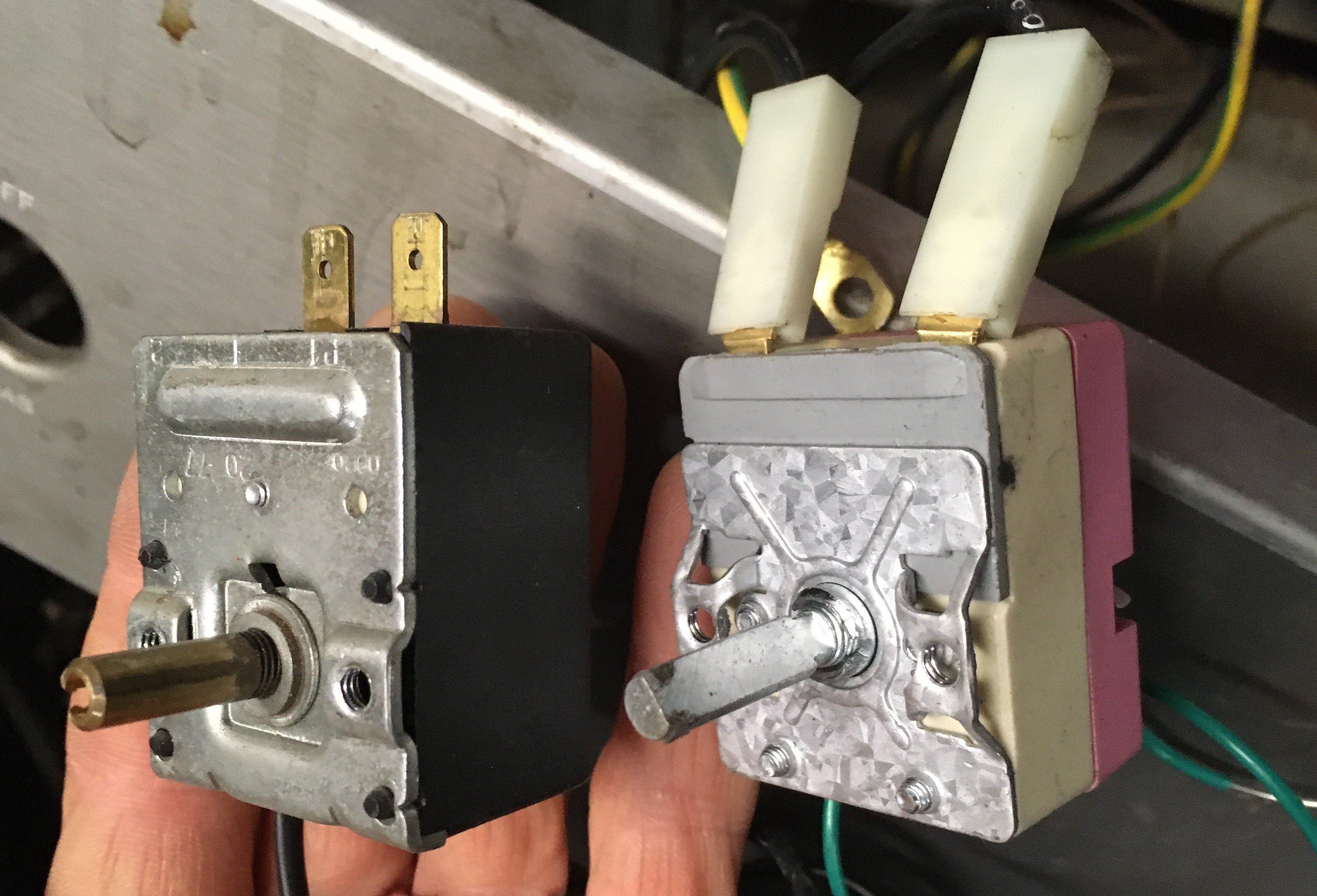

  • Update Dec. 29, 2025: Fixed
    The cheap replica temp control arrived. It had the same mounting pattern as the original, so was a quick install. The temp probe is much thinner, but still seems to read just fine in the boiler's original pipe sleeve where the original probe fit.
    I turned on the hot water faucets and left them run, in order to kick on the system. Water heating was when the boiler was making the most noise. I watched my 2 external temp gauges that clamp onto the pipes and let the boiler cycle on and off multiple times, each time, nudging up the dial on the new temp controller. I repeated this until the boiler was just barely starting to whine for a couple seconds before the controller shut off the flame. Once I found that spot, I backed the controller dial off just a hair.
    So far, the system is 100% back to normal. If that changes, I'll update this thread.
