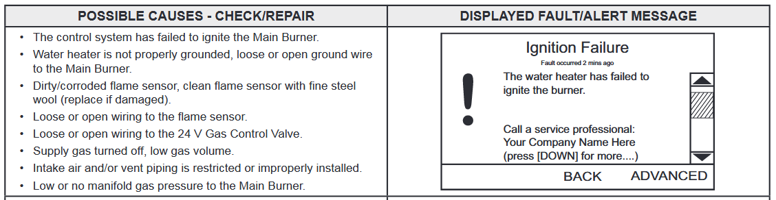

We have a single ~100kBTU direct vent propane hot water heater that supplies domestic hot water as well as radiant heating through an exchanger. We are experiencing an intermittent error for the past week where the tank will throw an ignition failure code "The control has not detected proper flame detect signal to transition in heating mode. The control requires above approximately 1uA current to verify proper flame".

    109A_5 Posts: 4,761
    Can't find a 125 manual. Does it have a low gas pressure switch ? The online 130 manual and others, the wiring diagram has horrible resolution.
    Were all these items checked or verified?
    could be the vent is icing over on the regulator too.
  • I'll re-check the exterior regulators and intake for new ice build up. Its getting worse, instead of a day between issues, its now only a couple of hours (or less) before I have to turn off/on the gas again.
    Checked the wires no issues.. Reluctant to check the flame sensor and burner until I've exhausted the other external options. Unit is aging so I try limiting how many times I jump inside it. I'll pull it apart tomorrow. Thank you.
