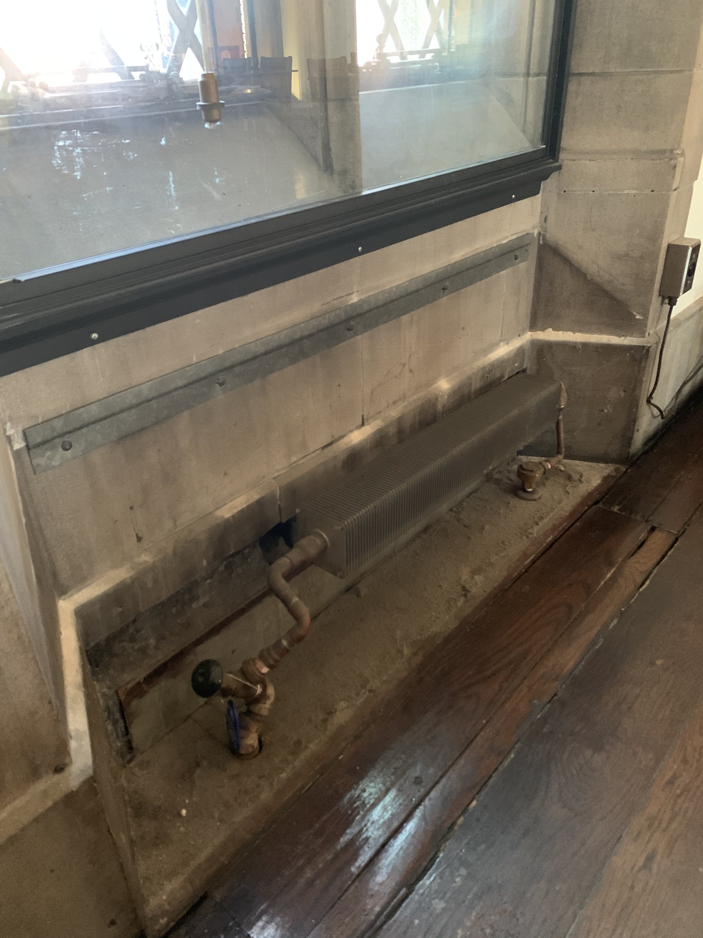

I have a project; to improve heating in a large dining room. This space originally had four cast iron radiators below tall windows for heat. Some time in the 1990s, the cast iron rads were replaced with 24" sections of fintube radiators inside of restrictive, sheetmetal covers. I have suitable radiators in storage, they may be the correct rads that were removed. The system is two-pipe steam, nominal pressure 2psi. Fintube information taken from closest Slantfin product info.
Help me with the math to show improvement in heating output:
To be removed; 4, 2ft fintube radiators - 1-1/4"CU,48 fins/ft, 1160Btu/hr/ft = 9280 BTU/hr
To install; 4, three-column cast iron, 26"height, 11 sections(@3.75sq'/section) = 9900 BTU/hr
Is my math correct? is the heat gain minimal? The removal of the metal rad covers could be a huge gain.
What are your opinions?

    is this actually fintube or is it a convector cabinet? do you have some pictures?
    This is a typical installation. The fin tube core and local piping is copper.
    I didn’t take a picture of the rad covers, but they left pitifully small open areas to allow convection to warm the room.
    My primary concern is if the math is correct, I may do a lot of work to clean up the areas, fix the floor, disguise the old holes in the stone and only achieve minimal improvements in heat output. Are these fintube emitters actually more efficient for their size than cast iron? Our steam never cycles off during use.
    that looks like someone that didn't know what they were doing. that fin tube is probably around 500 btu/hr/ft on steam:
    if you can figure out the edr of your radiators, steam is about 240 btu/hr per ft^2 of edr so multiply the edr by 240 to get the output.
    those look like someone tried to make a convector cabinet but didn't understand how they work. convector elements usually have multiple tubes and more dense fins so the edr of the convector element is a lot more than the fin tube. since it is zoned separately you could also put convector cabinets there.
    you should do a heat loss calculation on the space to figure out what you need but you need to include capacity for recovery too.
    you could put a trv on each of the emitters to have some control of the output.
    Tommi68
    That looks like maybe 1 1/4" fin tube with maybe 3 1/2 x 3 1/2 or 4 x 4 fins. A lot more than 500 btu/foot. Probably more like 1000/foot or more.
    that's why i included the slantfin catalog. the cabinet will increase it some too but it isn't going to do what whoever put it there thought it would.

    This is my reading of the heat capacity of the parts to be considered:
    To install; 4, three-column cast iron, 26"height, 11 sections(@3 .75sq'/section) = 9900 BTU/hr
    As this is a commercial dining room, I need more heat in the room; but will cast iron make sitting at the windows, in front of the radiators unbearable?
