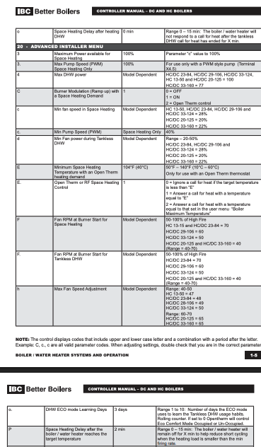

    hot_rod Member Posts: 27,416
    Depending on the boiler model, the controller has functions to help limit short cycling that zoning can present. In the installer menu find some of those parameters
    Max. power available for space heating 3
    Burner modulation ramp C
    Space heat delay P
