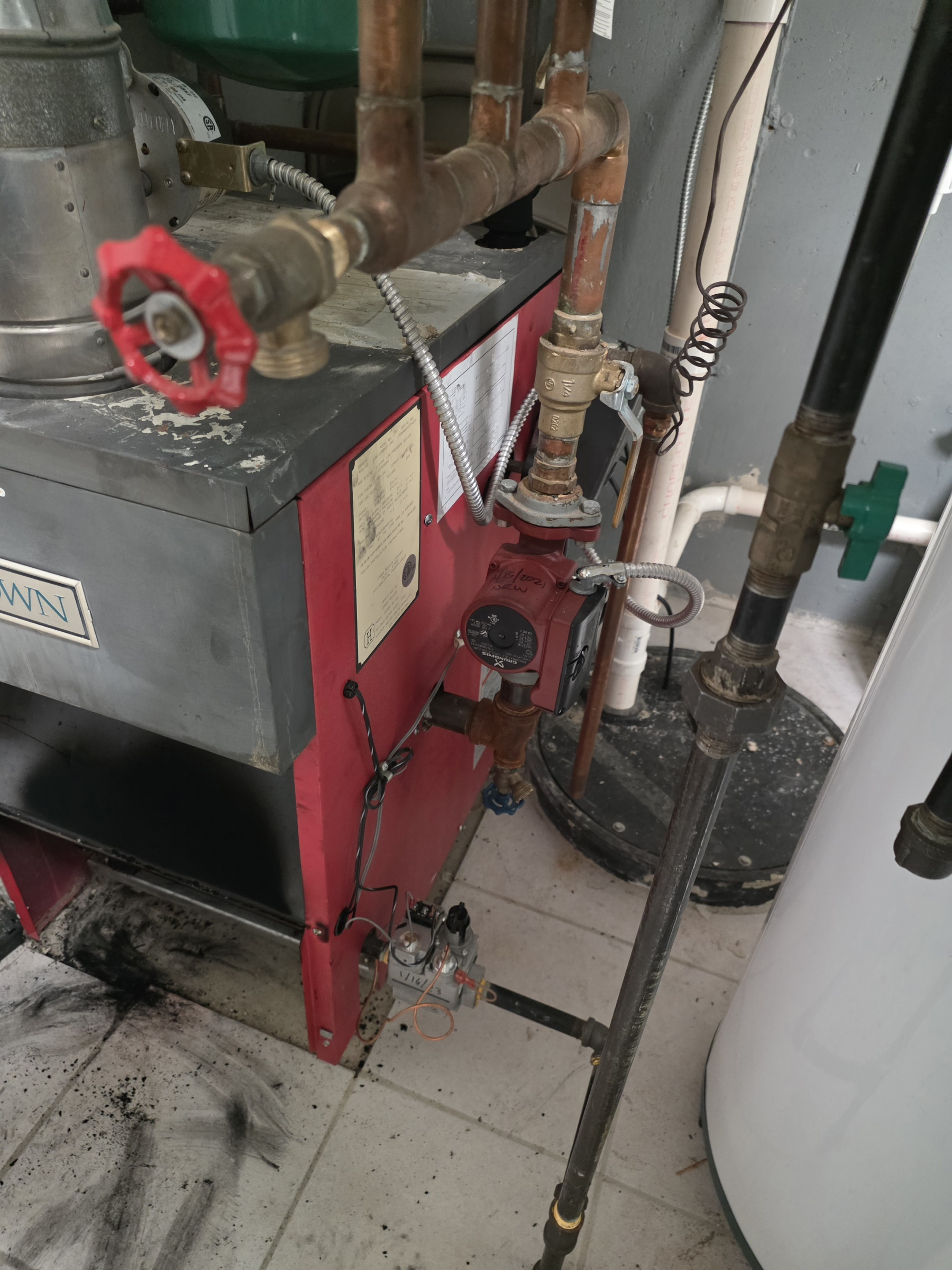

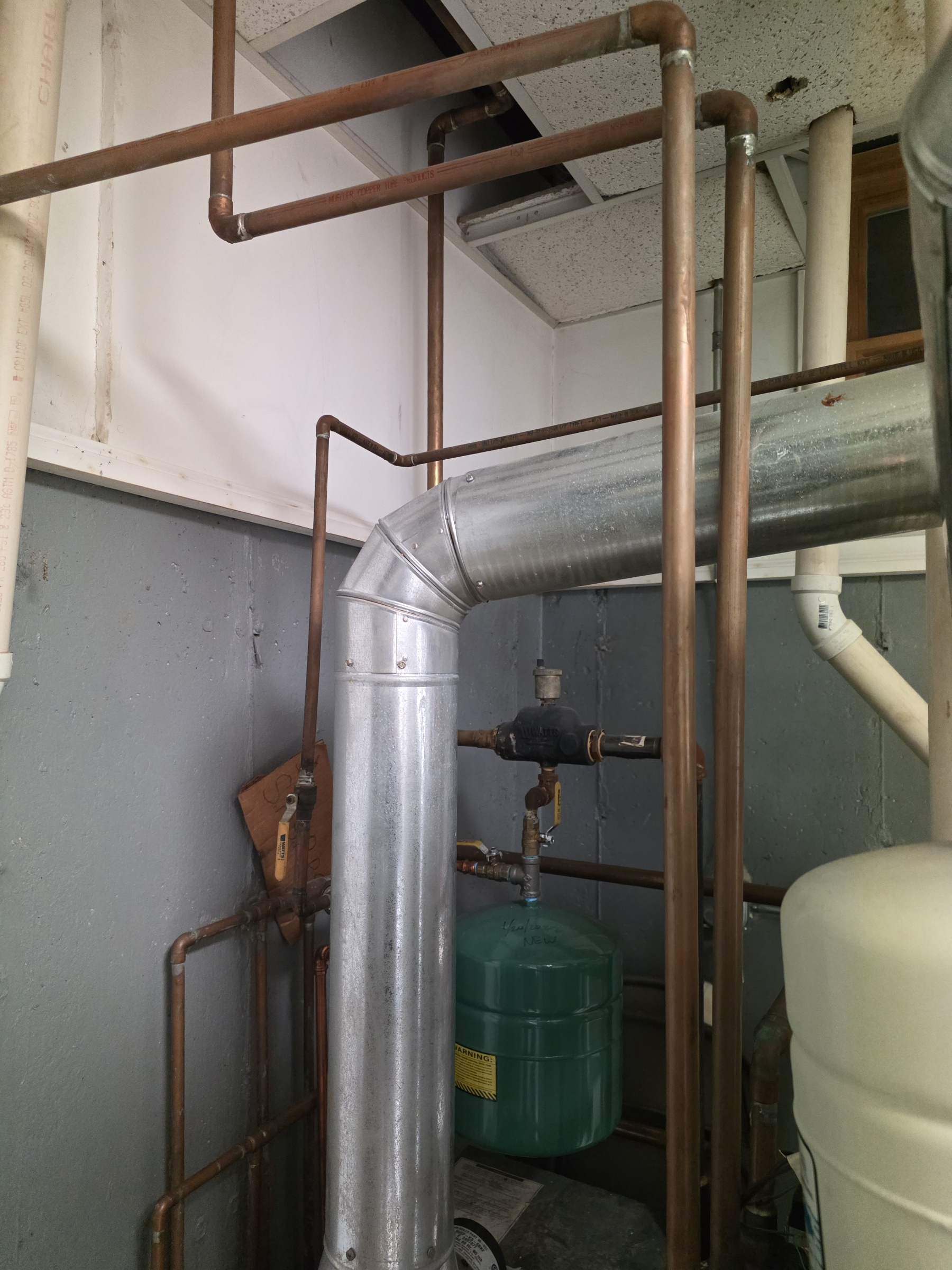

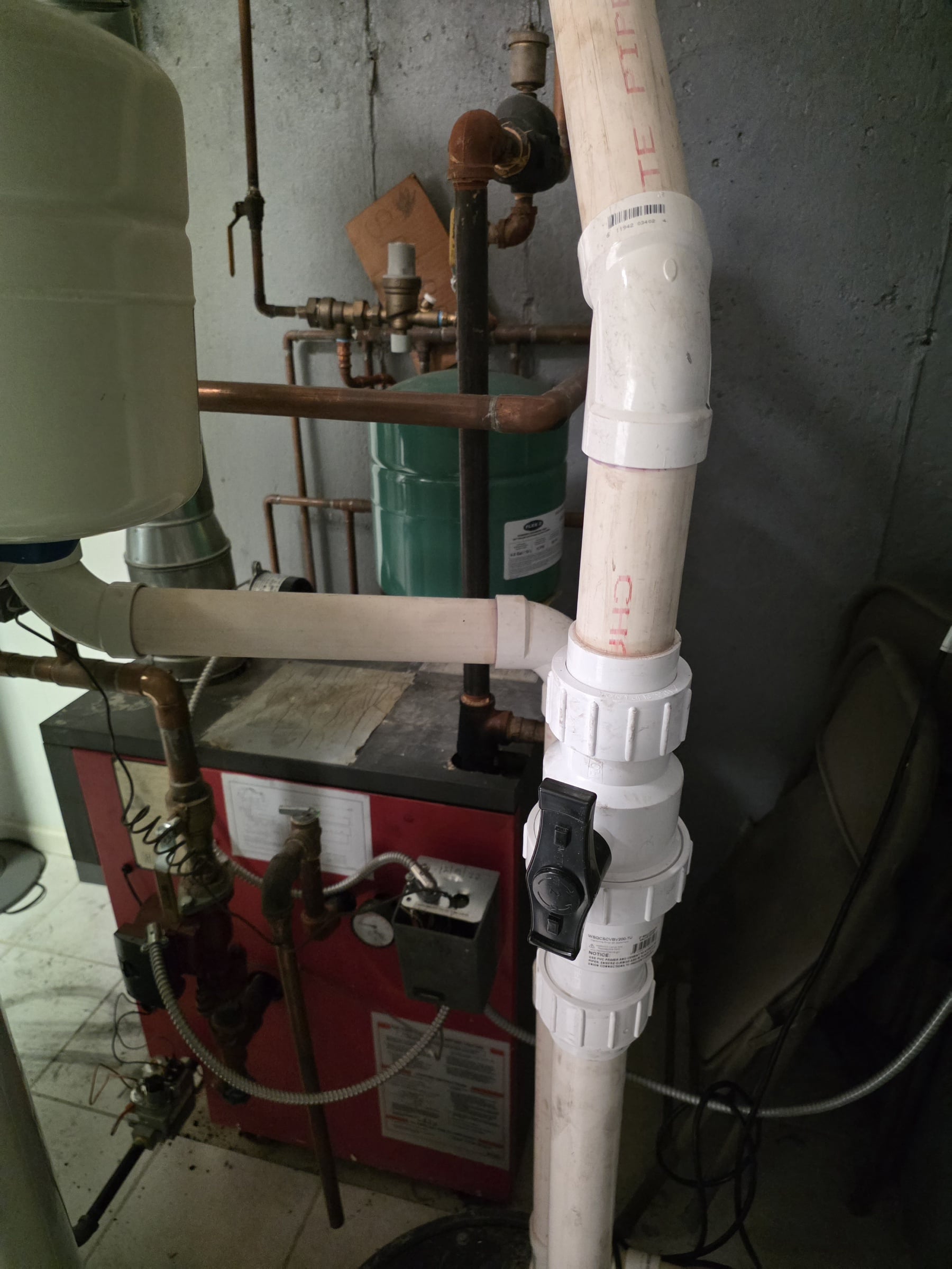

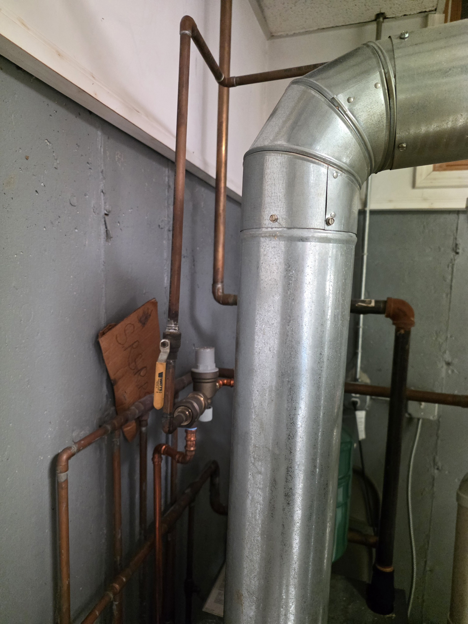

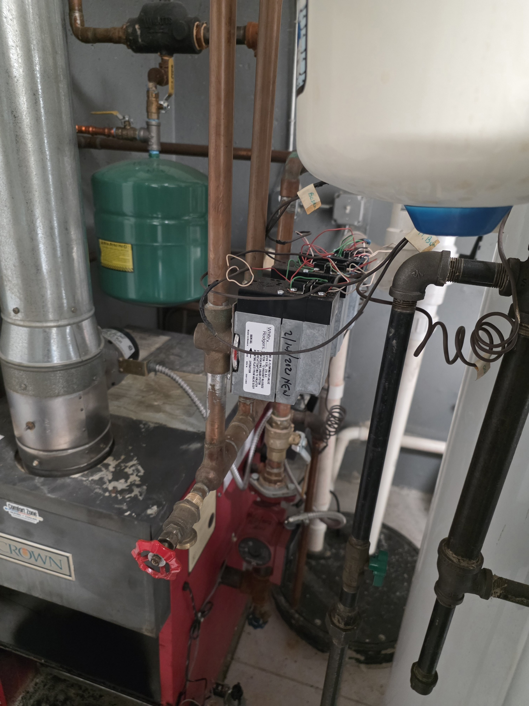

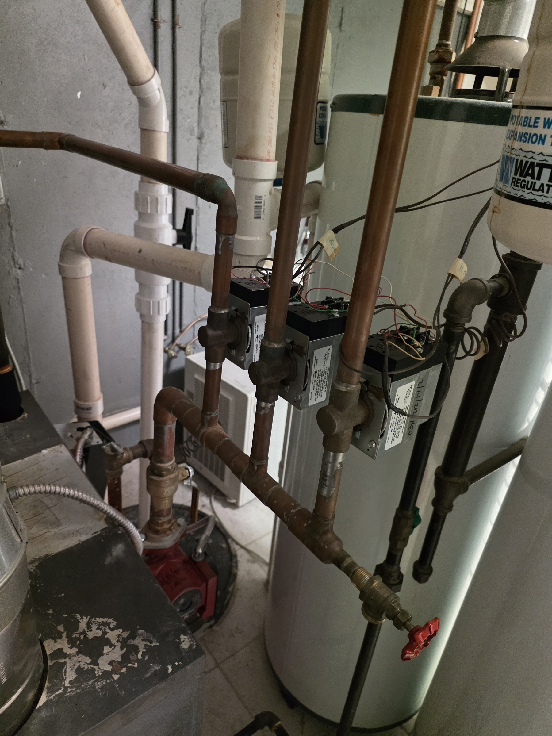

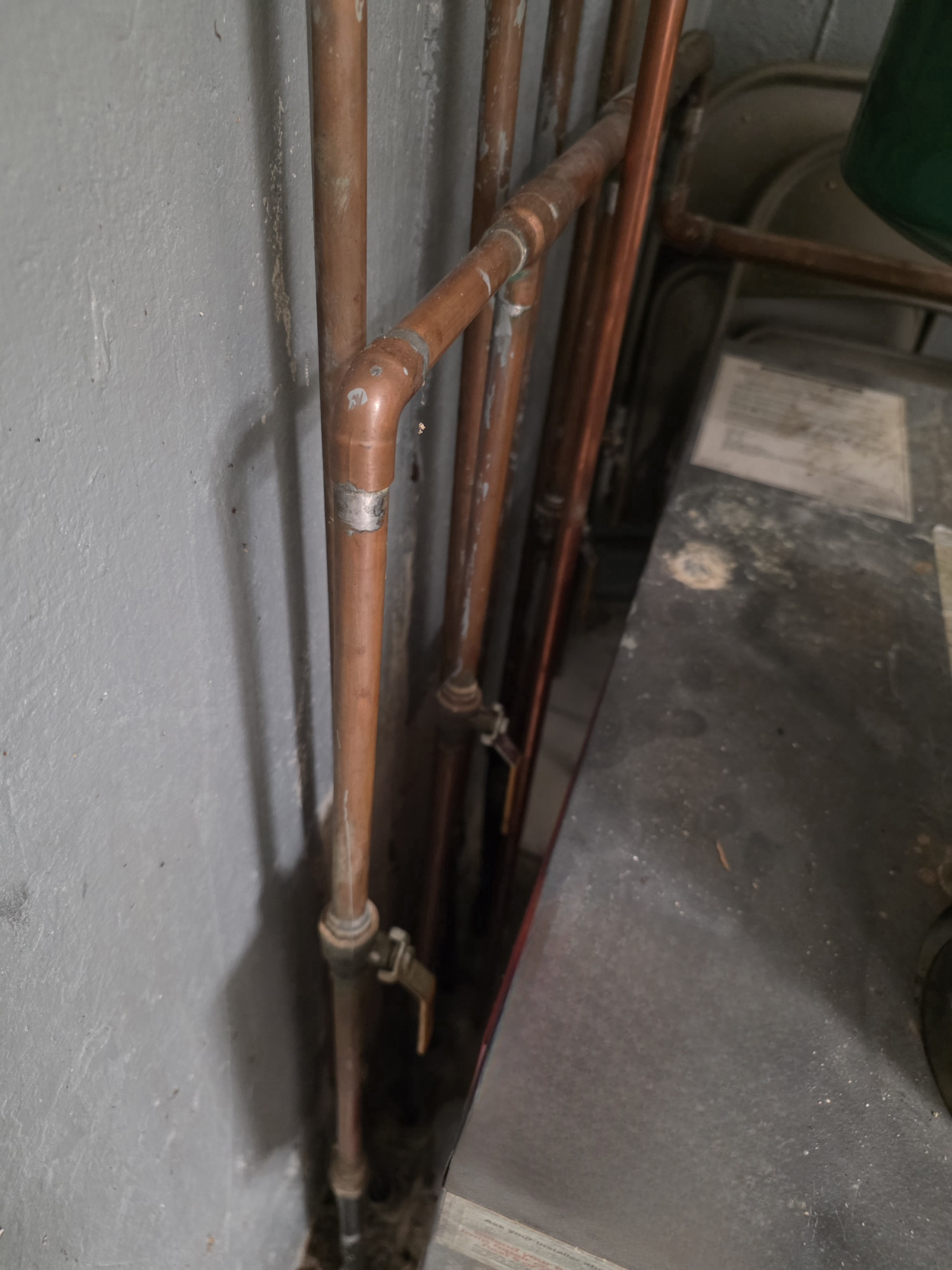

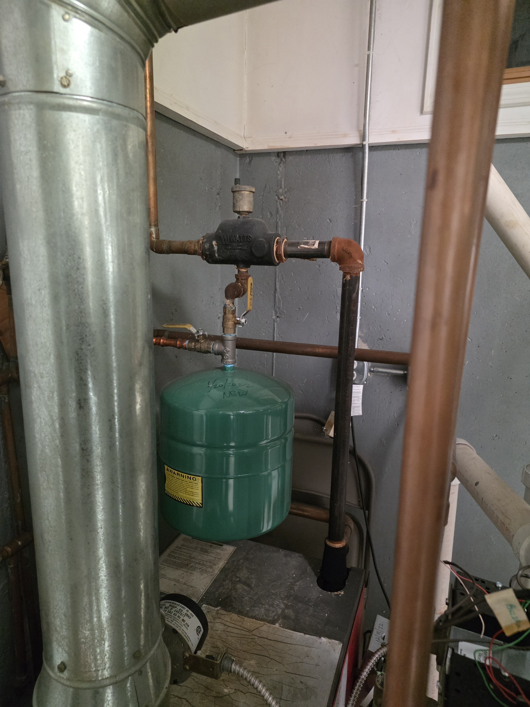

I have a 3-zone radiant floor heating system with 3 zone valves that control the floor heating to my basement, my garage and the master bedroom. Lately, I have noticed a lot of noise in each of these rooms and the floors haven't been heating. In the past I had an HVAC technician come out and bleed the lines and this has resolved the issue. I would like to do this myself and not have to call them every time. Based on these pictures, can someone walk me through exactly what needs to be done to get rid of the air in these lines.
    hot_rod Posts: 28,705
    concrete infloor heating?
    Looks like that boiler is piped direct to the radiant without any mixing device? What temperatures does it run? What pressure is it filled to, the fill valve should maintain around 12 psi.

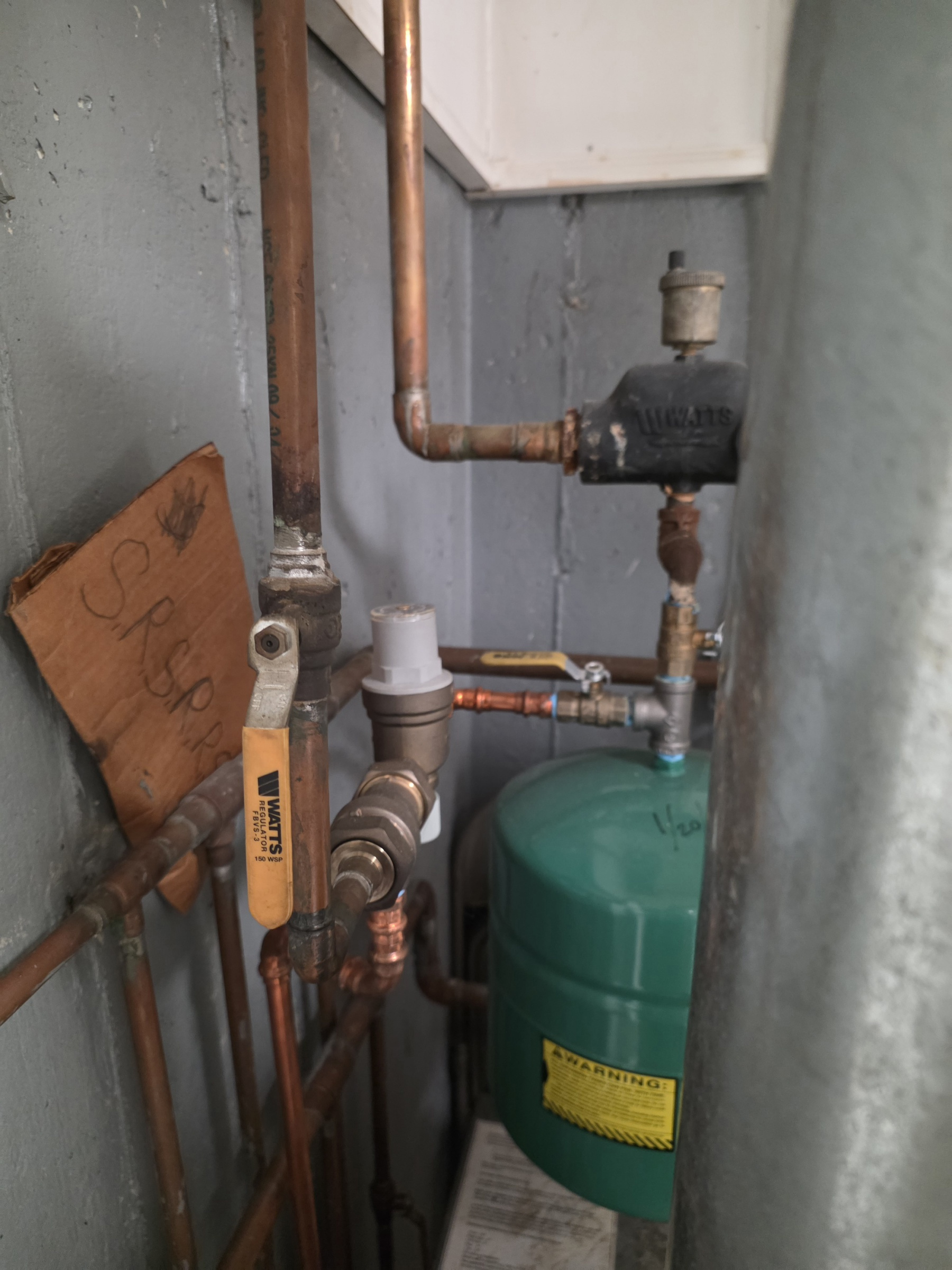

    The silver air vent should remove air over time, maybe it is stuck or plugged, remove the black cap ad push down the pin air or water should come out. If neither, it is time to replace it.

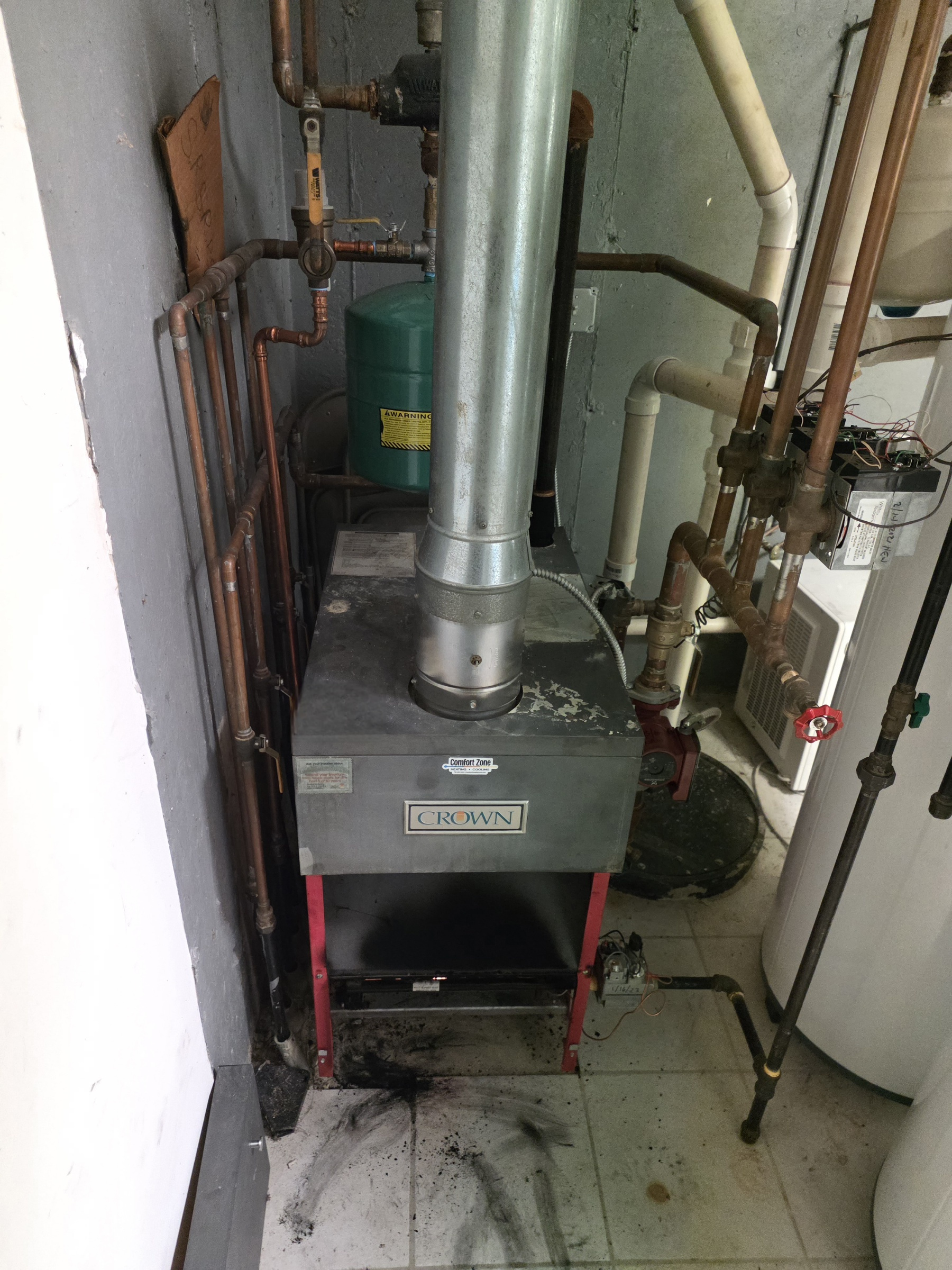

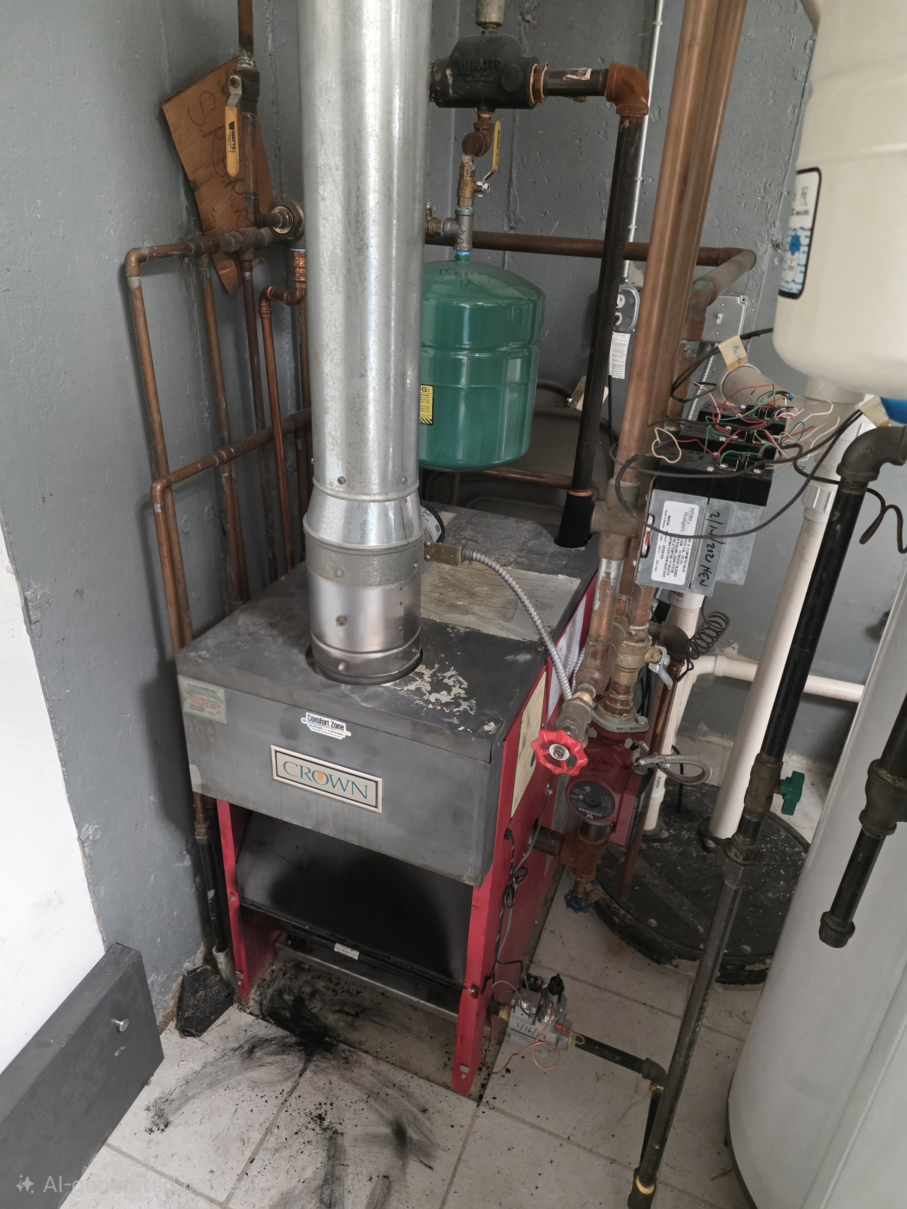

    That black soot indicates it needs some TLC, the boiler could be running much too cold.

    Simply keeping adequate pressure in the system would eliminate the possibility of air being introduced, but it does appear that you could close that ball valve above the circulator and hook a hose to that boiler drain on the end of the return header, using the fast fill feature to purge. As Hot Rod stated, if this is a low temp radiant floor system, the boiler is piped wrong and your auto vent may very well be plugged which would not allow air to escape after makeup water is added.
  • Unfortunately the near boiler piping was completed by someone that is not aware of the best practice for air removal in hydronic heating systems. Several mistakes are obvious to me from the limited near boiler piping you have pictured.
    1. Is there any temperature reducing designs near the point where the radiant floor tubes enter the floor? If not, the floor water temperature may be too hot and/or the return temperature to the boiler may be too cold.
    2. The circulator location is not ideal air removal.
    3. The Air Scoop location is not ideal for air removal.
    Just to name 3.
    Air removal can be accomplished by purging the air from the loops. This involves getting the boiler water pressure to about 25 PSI. Anything over that may cause the relief valve to operate and leak water all over the floor. Then opening the purge valve to expel the air from the system. The problem with this procedure is that it will add additional fresh water to the system which can cause premature boiler failure. You want to design the system to expel air by design and not need human intervention on a regular basis
    If you are constantly adding fresh water to purge air from the system You should plan of replacing that boiler more often that necessary.

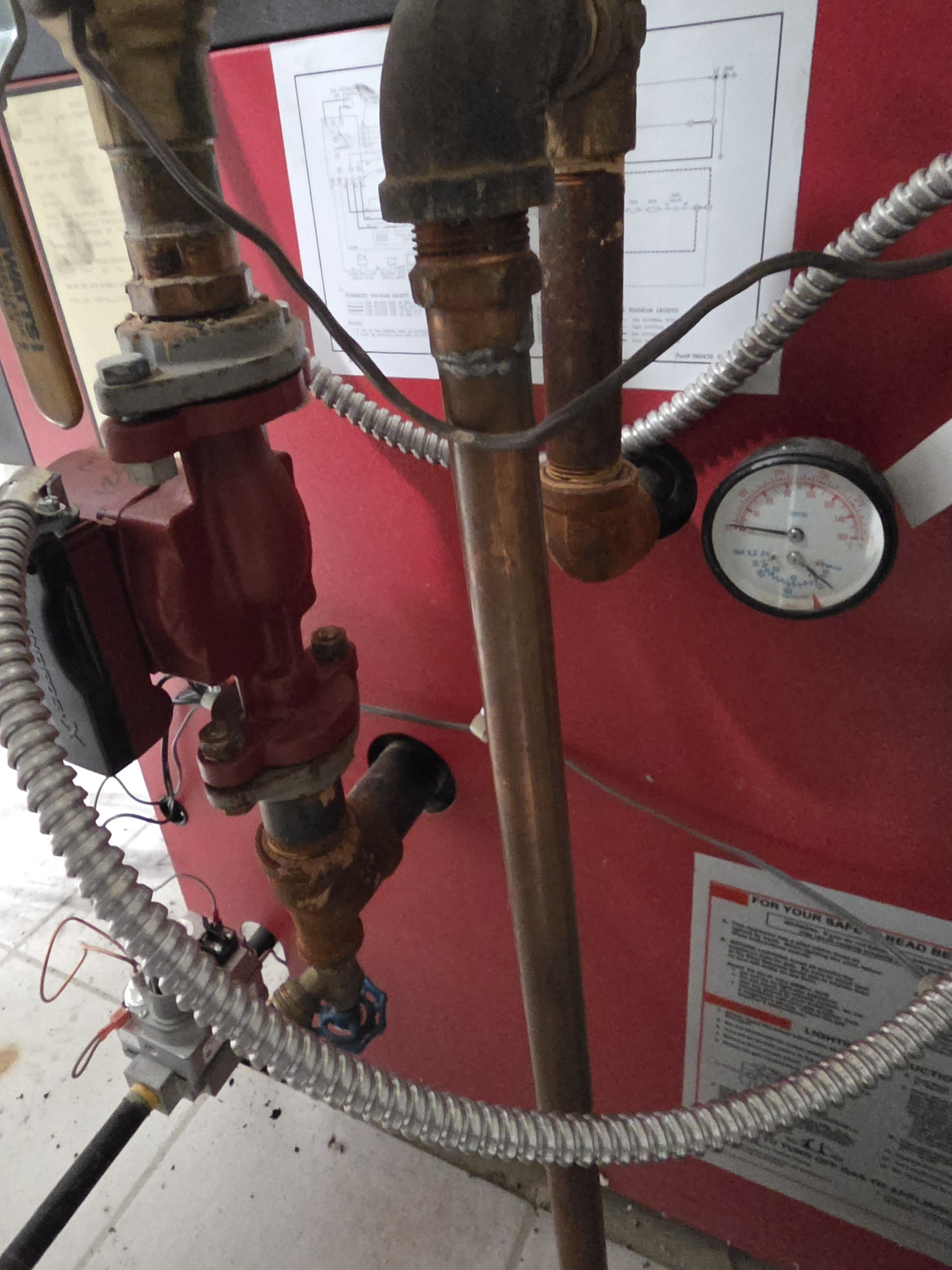

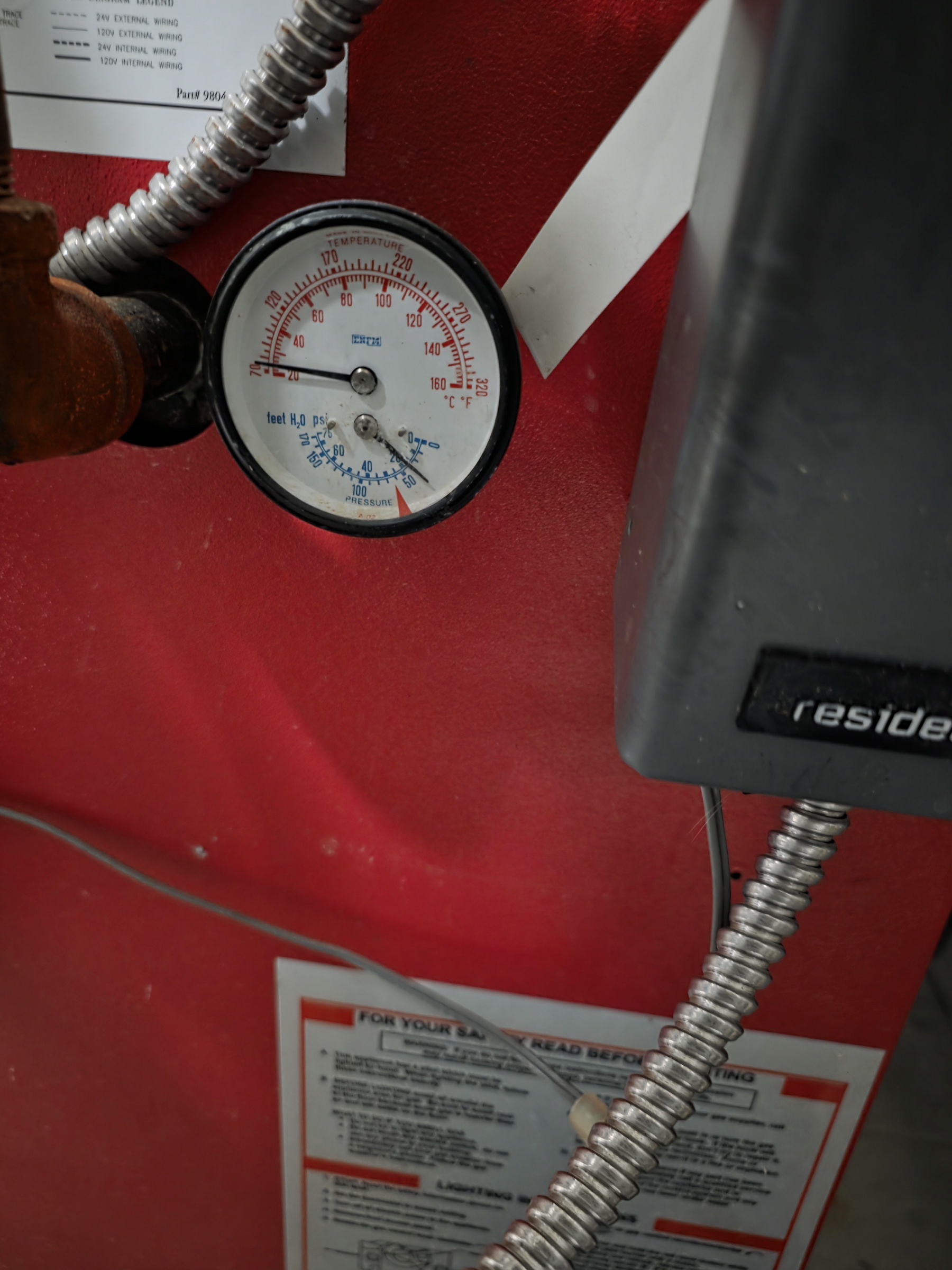

    Pics of the boiler gauge when the boiler has been running. Pics from farther away would be helpful.
    The black tire cap on top of the silverTaco air vent which is on top of the black air scoop should be loose or off as @hot_rod has stated.

    assuming the gauge is working,pressure is fine. You have an excellent fill valve, it should maintain pressure
    You could get another screw on pressure gauge to confirm pressure is correct

    I'm curious where you hear air? Tube in concrete tends to muffle air noise, it must be coming from the copper tube running to and from the slab?

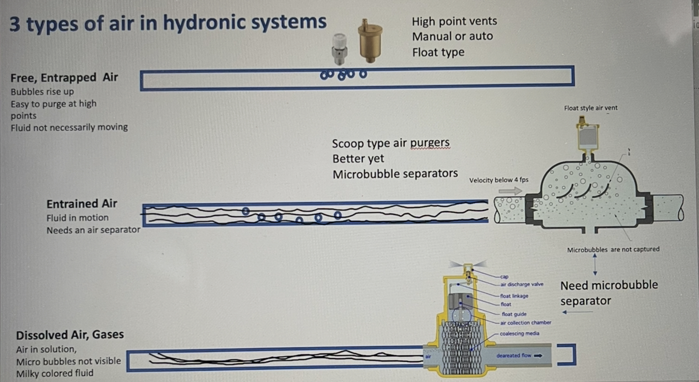

    Also slow flow velocity, below 2 fps feet per second, does not carry the air bubbles along with the fluid very well. The same happens with excessive velocity over 4 fps, air rushes across a ramp type purger and does not rise up to the vent. But with that circulator and tube size I would not suspect excessively low velocity. If it is a multi speed circ, put it on the various speeds to see if that changes anything.

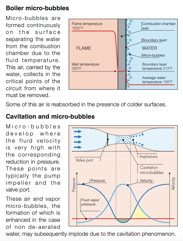

    Air that is not removed goes in and out of suspension as the fluid heats and cools back down. Air forms at the hottest point in the system where the flame touches the metal surfaces in the boiler. It should flush through to the purger.
    So I come back to that air purger not working properly, or at all?
    I always promote the microbubble type air purgers, they all work in the high 90% range, and do their job quickly. You rarely hear of noise or air issues with a properly working microbubble type purger. Should you choose to upgrade.
    A system without leaks or additional water (air) being added should get to a point of air and noise free, as long as the air has a means to get from the inside, out.
    One last thought is cavitation, this is created anywhere flow is reduced to a small opening, a pinched tube, a partially opened valve, debris plugging flow, a zone valve stuck is a partial open condition, etc. I've seen those WR zone valve spools lock in partially open positions, that could induce a cavitation condition. Turn the thumb wheel to see if they all rotate.
    Cavitation sounds like air. This could be happening in one section and the copper tube being a good conductor transmits the noise.
    Air purger vs sep.png Air sep efficiency.png Screenshot 2025-11-26 at 7.49.19 AM.png

    The pic of your gauge shows the pressure high for the temperature reading. These gauges do go bad so you should probably verify the accuracy with another screw on gauge on the boiler drain as stated. 12PSI for one story house and 15PSI for two story house when the boiler is cold. That's what I do.
