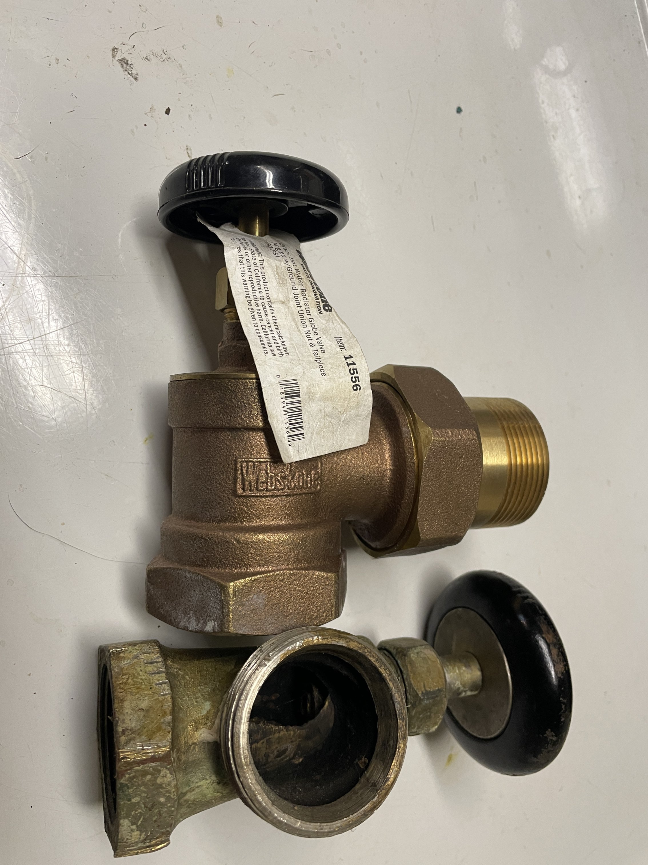

    You make a good point, maybe I can clean them up and repair them. Are pins and parts available for these old valves? It is the 1/4 turn type, see pic of new and old valve.

    you won't be able to get them from the manufacturer but you can probably get a roll pin from mcmaster carr or tap a screw or setscrew in to it to replace the original stop. you would have to take it apart and see where the stop is supposed to be. sometimes there is a washer on the stem that is notched that serves as the stop.
    the markings on the handle may show where on and off are as well.

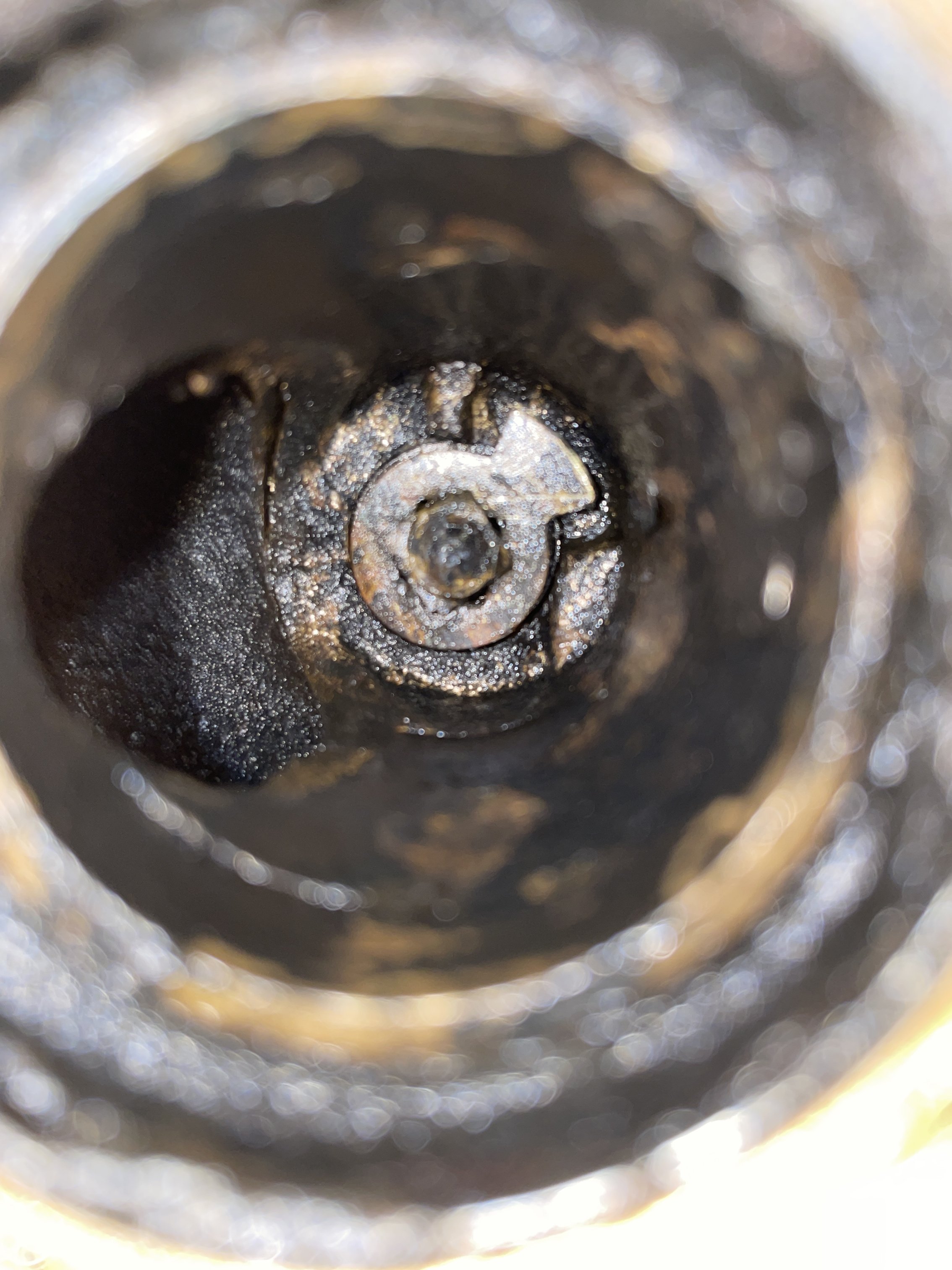

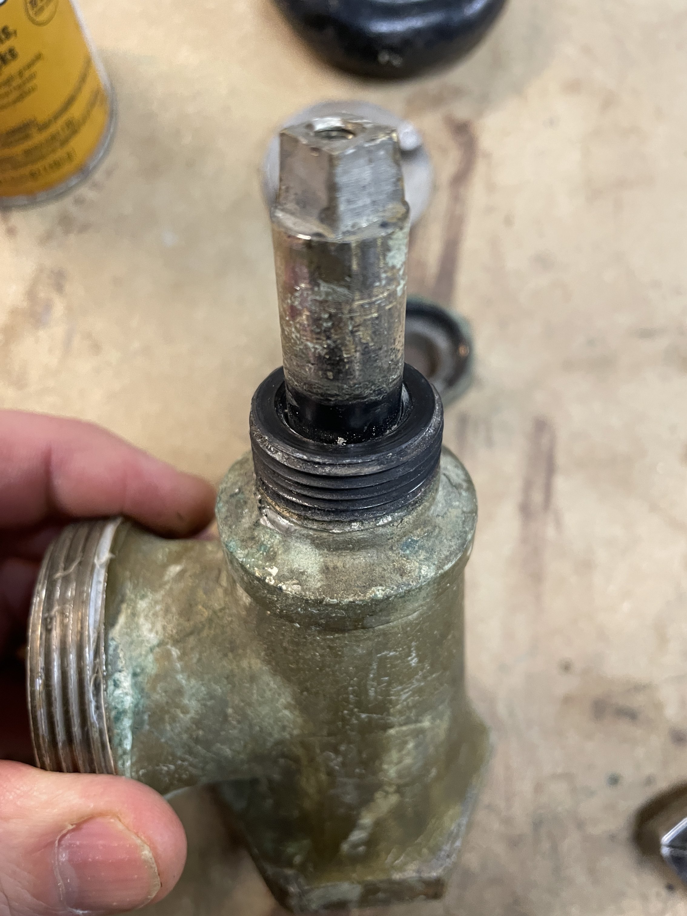

    I took this valve (which isn't the one that's spinning) apart to look for a pin and to see how easy it would be to fix them in general. Do you think it will come apart more than this? I don't see a pin, it looks like there are two brass nubs that are built into the valve wall. I assume either that washer or the brass nubs are worn off and that's why it's just spinning. Maybe I'll just replace that one and refurbish all the other ones that are functioning correctly. Does this sound like a reasonable plan for refurbishing them?
    1. add a rubber washer on the stem (seems like there was one, but it's worn off? )
    2. tape/dope all the threads
    3. add some teflon rope to the nut on the stem
    Also, I've always heard that you're not supposed to put thread sealant on compression fittings, but I've found in other instances that as long as I keep the sealant away from the compression parts, it can help make a better leak-free joint. Any thoughts on this? I've taken most of the radiators out in this house to paint and then reinstalled and that compression nut seems to be the place they leak the most and then I need to get out the long metal pipe to really crank down on that joint for no leaks.

    That cam plate or "washer" and that nub in the brass are what restricts the movement. If that is broken in other valve you will have to see what part is broken and repair it.(or replace the valve depending on what is broken). Might be what holds that plate in place came unscrewed or clipped, might be the nub is broken off, might be the cam is missing). The nub could be fixed by tapping a screw in to the valve, missing clip or screw for the plate is easy to fix, missing plate could be harder to fix.
    Is there a washer somewhere inside the valve? Can you show us where you think it is missing? Normally that plug type of valve seals by the brass plug tightly fitting against the brass body. The stem itself has packing in it. You can buy various types of packing cord from mcmaster carr in longer lengths than the hardware store packages. Sometimes the fibers in the old packing are asbestos so be careful of that.
    The unions should seal without dope on the sealing faces if they are clean and aligned properly. you can put a little dope or oil or grease on the threads and back where the nut turns to help it go together easier. Dope won't keep it from sealing but also shouldn't be required if everything else is right.

    So, is this as far as the valve will break down? I can't see how it can come apart any more for cleaning.
