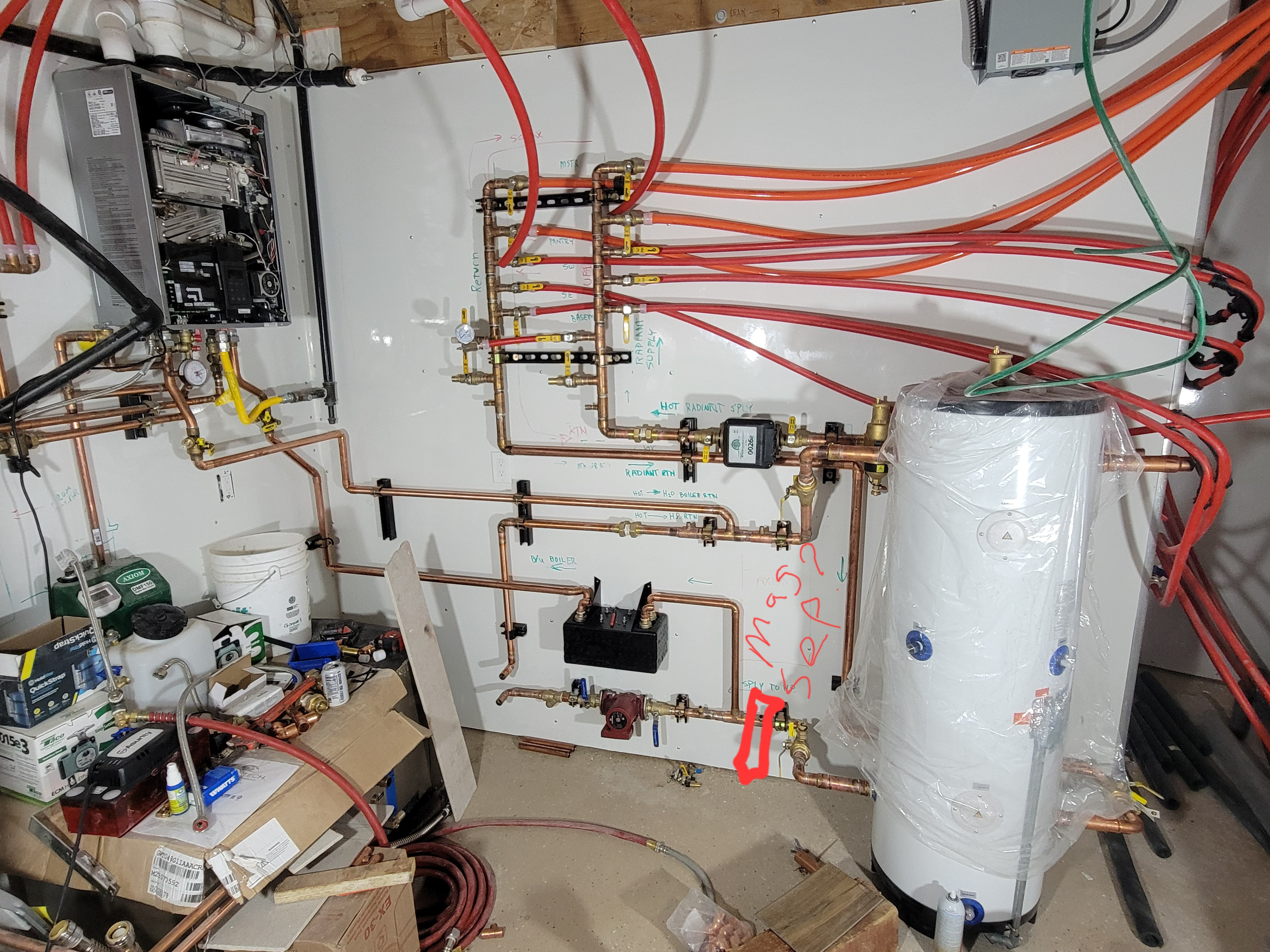

High level overview:
ICF house build, Geothermal heart pump w/ground loop, B&D pump station, backup Combi-Boiler for snow melt (or if HP goes down and DHW), radiant ceiling loops with 4 manifolds w/6 loops each, solar load shedding to buffer tank and water heater tank. Design temp is 95° system temp other than when snow melt is required.
I am in the final stages of assembling my system that i designed and just read a few other posts and thinking i need to add a couple magnetic separators into my system. (in the marked up location just after buffer tank before HP/Combi supply line)
My water has high iron content to begin with, 350. I still need to do a test after my Iron /Manganese filtration for well water to see how much that helps to lower the iron for the water I intend to use with the glycol mixture. (on a well)
I currently have one magnetic/air separator in front of the 0026 for the radiant distribution.
I'm thinking I should also add one just after the buffer tank feed to the HP (in lower left corner, currently acting as a shelf :) / Backup Combi-Boiler?
What are your thoughts?
Additionally, thinking about adding one to the geothermal ground loop.
Thanks in advance.

    hot_rod Posts: 28,769
    I would like to see a dirt/mag on both sides of the HX. No harm having one on the loop field either.

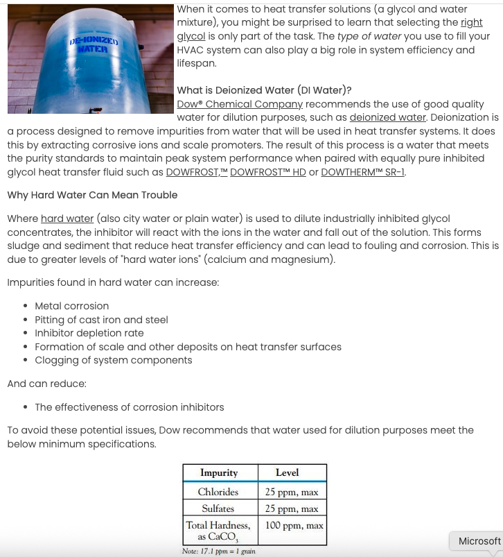

    If you plan on blending your glycol on site, here are the water specs from Dow.
    Either consider buying pre-blended glycol, no mixing required, or purchase some DI water from a local treatment company. A 55 gallon plastic barrel is a good way to buy and haul water.
    I have seen people loading up5 gallon containers at the water machines at Walmart, etc. I think those are large RO machines?

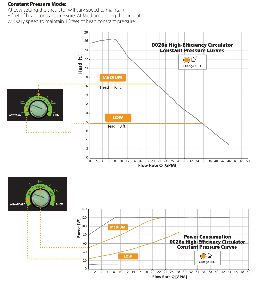

    That is a substantial circ on the radiant manifold, what is the total GPM needed? What size is the manifold?
    Screenshot 2025-12-09 at 2.45.51 PM.png Screenshot 2025-12-09 at 2.53.16 PM.png

  • Thanks for the reference. I thought that I've read that you don't want DI water and for sure not RO water. I'll have to call around for that one.
    The manifolds is 1.25" with 3/4" to most manifolds and 1" to a couple to minimize head loss. (and 1" for garage/driveway snow melt)
    The boiler loop is 1" as well as the feed into the Heat Pump.
    GPM, if all is running it's 18gpm without snow melt running. The 0026e circulator is extremely versatile and can be used in constant pressure modes (low or med) or if i choose later to run it with 0-10V. And use only 20-80W on low.
    I'll be able to run it on high and also use it for purging the system is my hope.
    Stepping back and looking at it again, it appears i missed my check valve in the boiler return when cutting my copper last night. Will add that tonight before sweating the rest together.

    The antifreeze has corrosion inhibitors in it, those will keep the DI or RO water from filling itself with metal from your system although even in a system with just water the first initial corrosion from the DI or RO water is not any worse than using tap water.

    There is not a huge difference between deionized water distilled and reverse osmosis, different methods to get the same result.
    DI uses a media bed to remove + and - ions, similar to a water softener.
    RO's uses filters and a tight membrane to filter out ions
    Actual distilled water is boiled, condensate collected off a stainless plate typically.
    The advice to use DM de-minerlized, or DI de-ionized, water to blend comes from Dow. Dow actually supplies the base product to many other repackagers. So you may see that same spec at other glycol manufacturers.
    Regardless, it is good to know exactly what is in your water. If you have high chlorides that is tough on stainless components, like indirect tanks, heat exchangers, etc.
